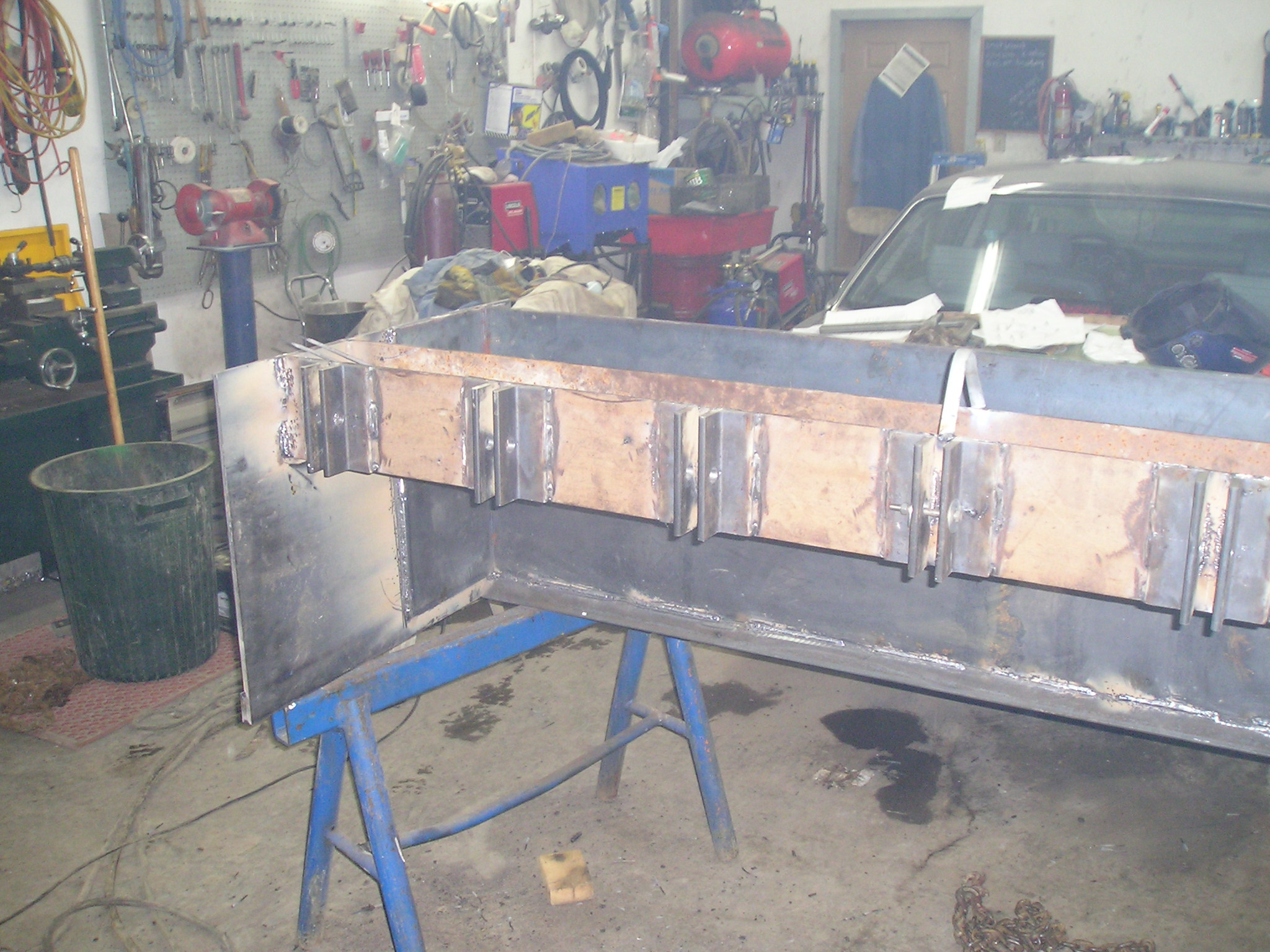

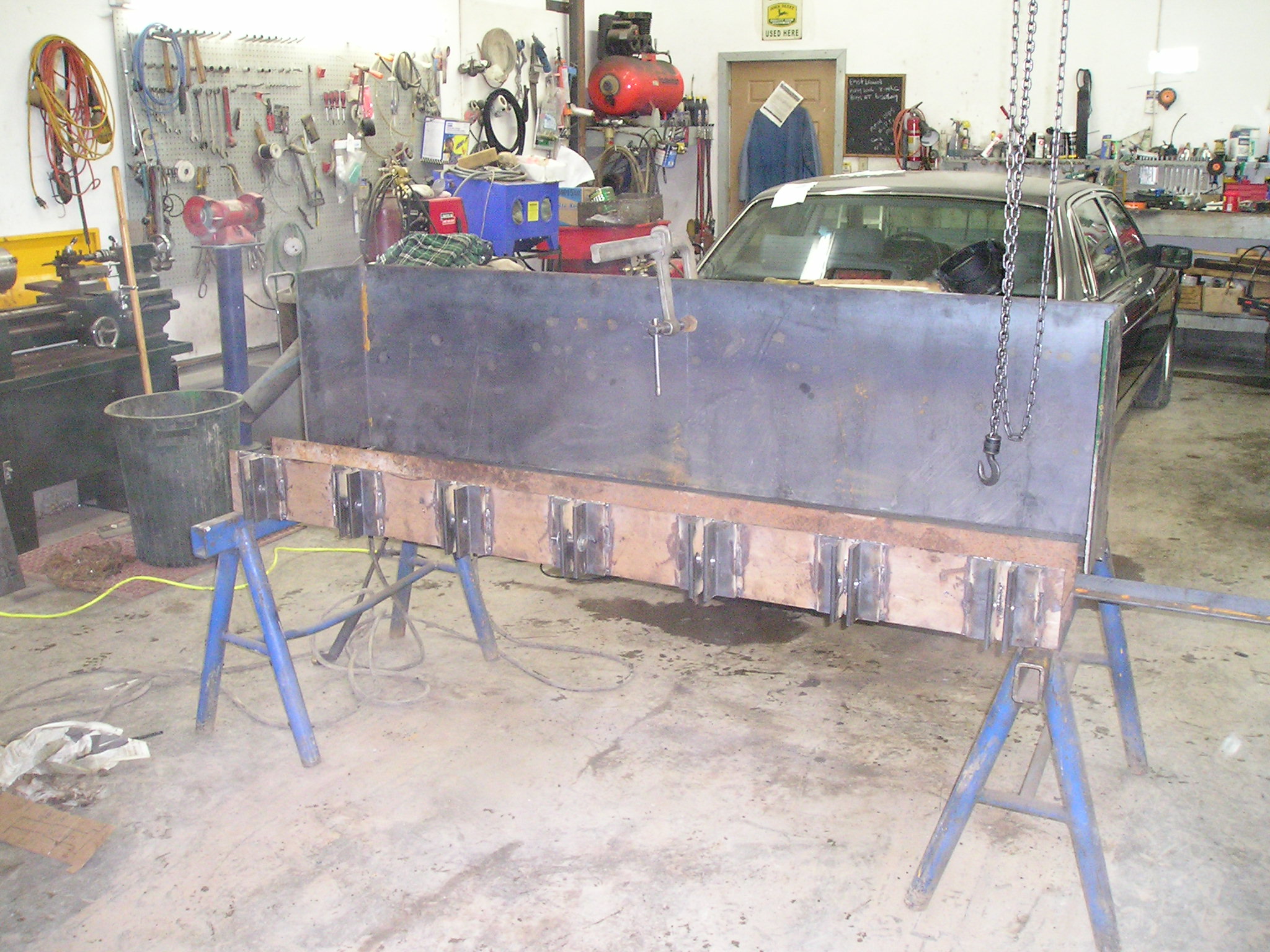

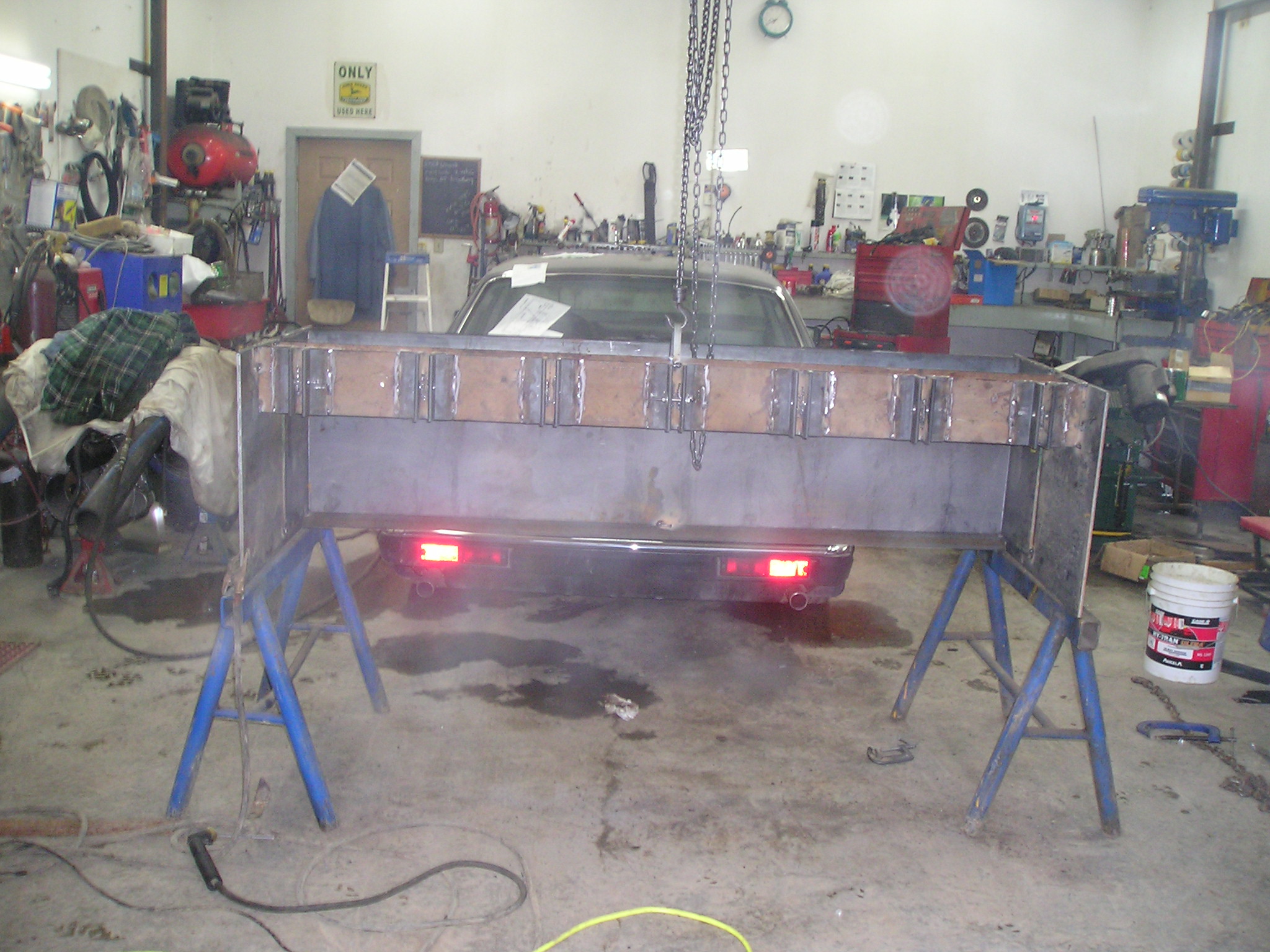

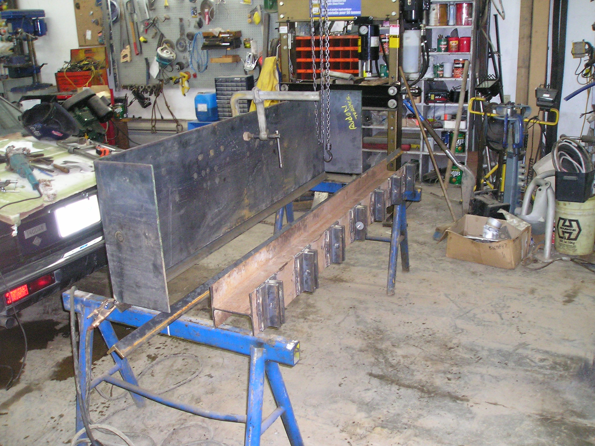

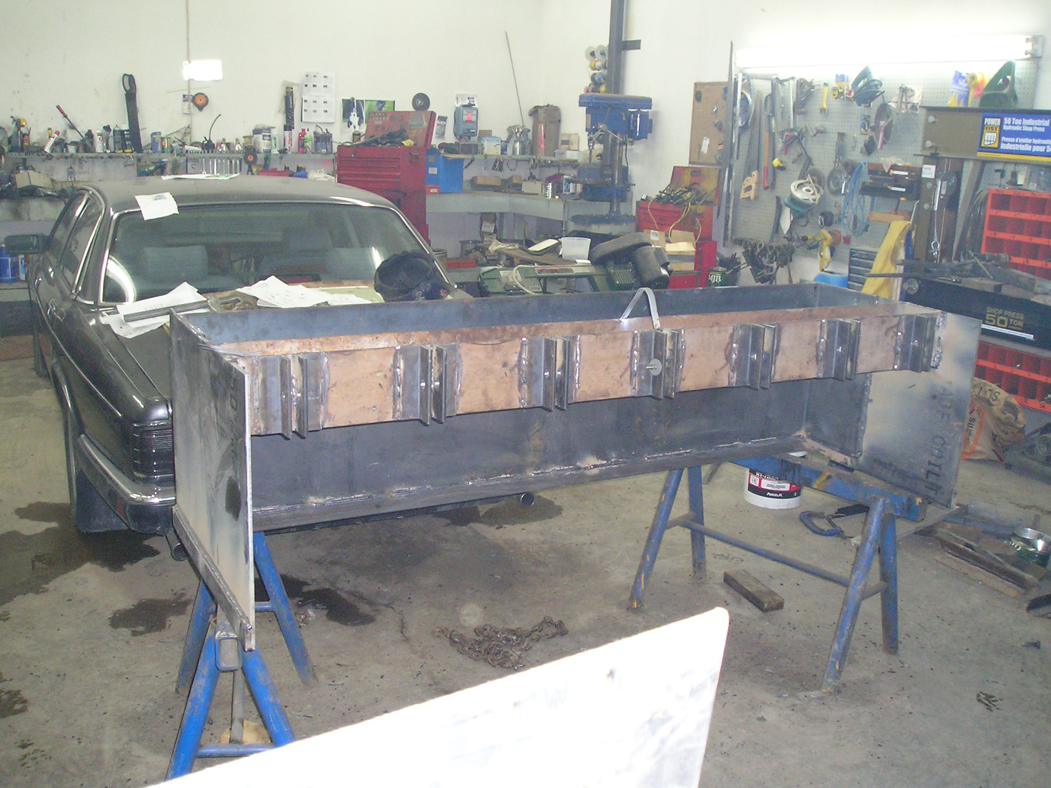

Not much of a winter project. My problem is when I start something that is fun I can't stop. I now have 12 hours on the project in 2 days. Tomorrow I will get material for the rippers and also start on the 3 point brackets. Hope my pictures work as I am pretty computer illiterate.

That's a heavy dude! Oughta last. I estimate 675-750 lbs from the last photo. Just guessing dimensions and that beam looks about like a W8 X 31.

:eek::eek: The Blade is 3/8 plate 78" wide, 29" deep and 21 1/2 high. I am guessing when finished it will be about 500-600lbs. Hopefully my Massey 165 is up to it. More pics to come. Thanks guys:):)
