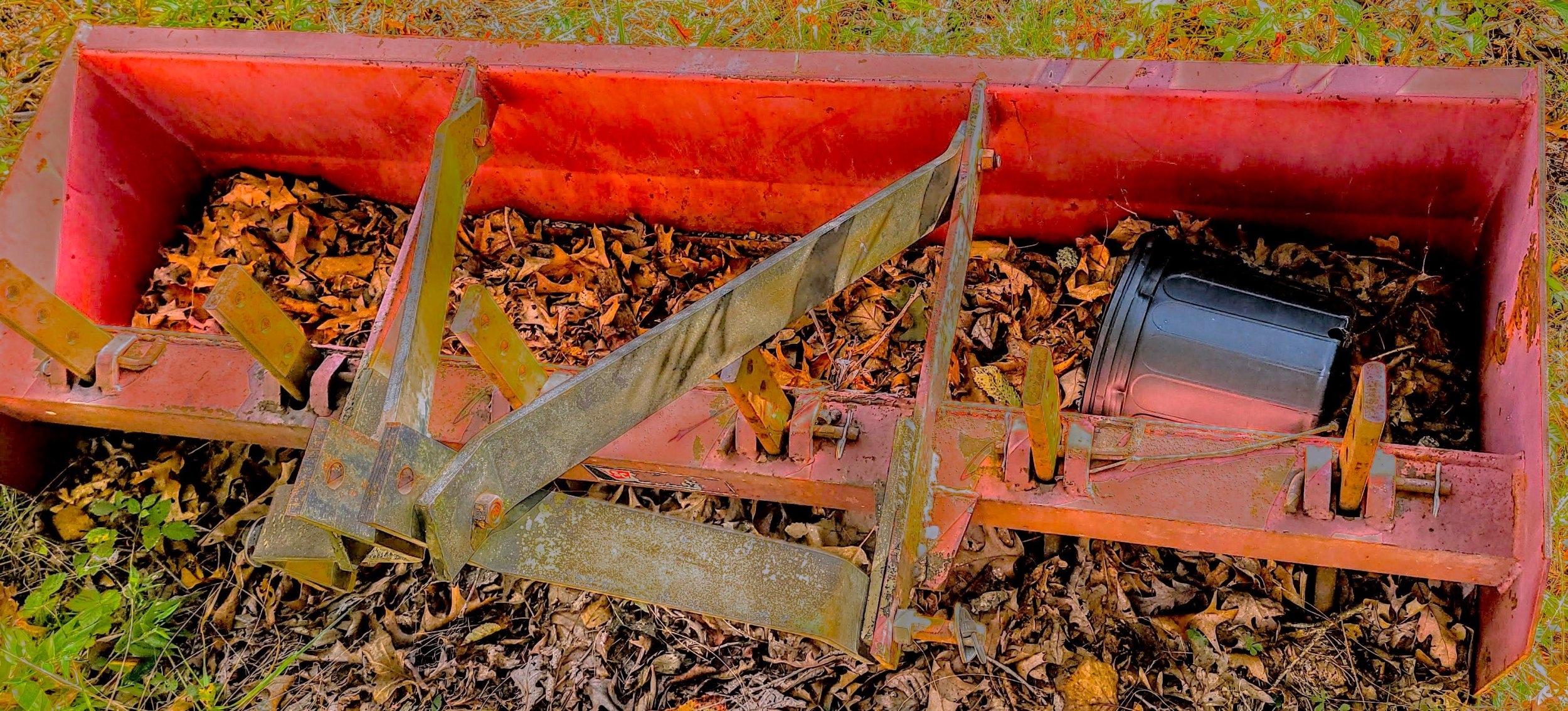

The "Black" parts of this box blade were originally 3/8 X 2" steel,,
I wrinkled them like they were made out of bread dough backing up.
I remade the parts out of 3/8 X 3" steel,,
Those parts wrinkled almost as easy,,
THEN, I remade the parts out of 1/2 X 3" steel,,
NOW,, I do not use the box blade in reverse!! LOL!!
To be honest, the box blade was only rated for about 1/2 the horsepower of my 584IH,,
So, there is that,,
