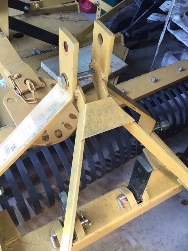

This is my TSC 6 foot box blade,, that I collapsed the top link support,,,, TWICE !!
The first rebuild, I simply made the steel 1/8" thicker,,, (3/8" to 1/2")
The second rebuild, I made the steel 1/2" wider as well as thicker.
Also, I added the doublers where the lower link pins bolt on,, they bent the second time.
Both rebuilds, I tried to match the dimensions and angle locations.
Both times I collapsed the top link support (the black parts) I was going backwards.
The box hit an obstruction (rock, or stump?), the parts collapsed so easily, I did not know it happened.
When I looked back,,, the box was at a weird angle,,,,
NOW,, I only use the box blade going forward. The box simply jumps up if something is hit.
EDIT!! I just looked at the TSC box blade,,, I may have made the parts a full inch wider!! :confused2:

A bent strap, in compression, isn't very strong. :(

I agree^^^ and when the rippers hang up the rear bent braces would be in compression when traveling forward. rotation about the lower link pins would put a lot of compressive force against the top link. Not a good use for flat bar stock. Welded tubing would be a better choice.

That is a VERY POORLY DESIGNED box blade!
TSC = Tarter Gate supplier?
I just wonder where they found the engineer who decided that flat stock material was suitable.
Pushing a blade built like that (with flat stock) is like pushing spaghetti.

Yes it is an old design that never was any good. I would get rid of it and buy something else. My small Cammond 48 " box blade is a much better design for a low cost unit. I definitely prefer the Woods Gannon industrial box blade I have for the bigger jobs over anything else I have used so far. Cammond copied the better design of the Gannon mast imo, they could have chosen worse.

A couple quick, easy braces added would multiply it's strength several times over.

That's what I was just thinking also. I had to modify mine slightly to work with my quick hitch. When I did I added some flat plate on the top of the two braces that go to the back of the blade. So far I've been pretty happy with my TSC blade. But I don't have a 40 hp tractor either.

Is that a crack in the flat stock, just below the head of the bolt being used as a tip link pin?
I see what you are talking about. I don't think so I think it's my bad rattle can paint job I did after I welded the modifications. However I will look at better tomorrow. Thanks for pointing it out.

What I have done is replace the lower bolt with a heavy wall or solid slice of a cat 3 top link pin. Weld it in place to tie the two sides together and provide the correct height for the quick hitch top hook.
