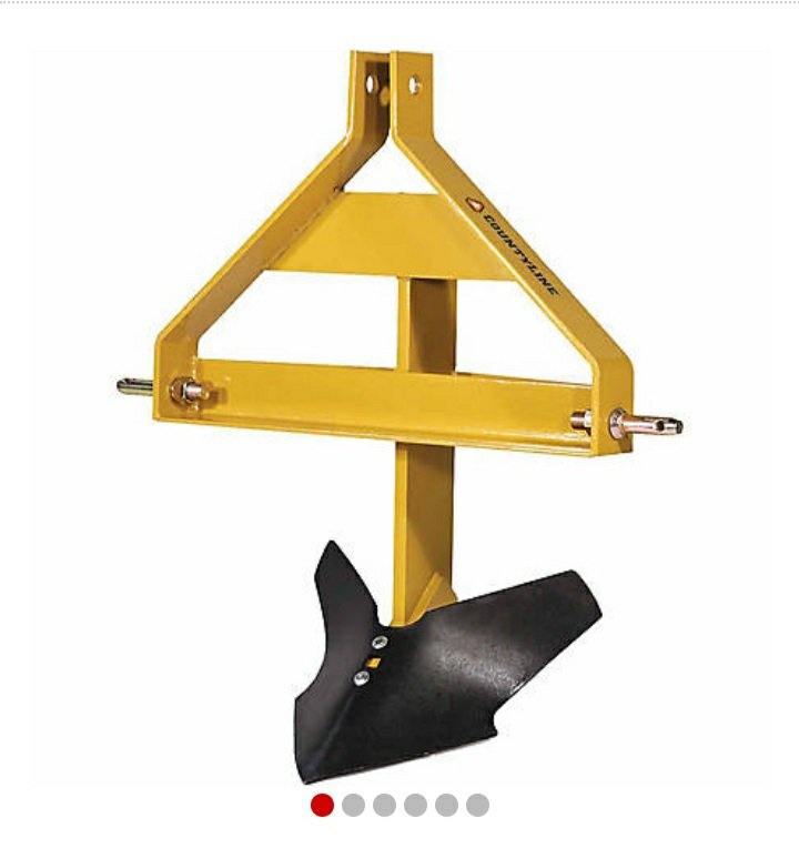

I'm thinking a subsoiler/middle buster would be your best bet. I would start and finish trench about a foot or so away each end making small passes until you get depth you want. Then finish the one foot so water goes through.
Pictures would help.
It could be you'd want it fairly deep, put a few inches #57 gravel, corrugated plastic drain pipe, gravel then dirt on top. 20210220_150109.jpg

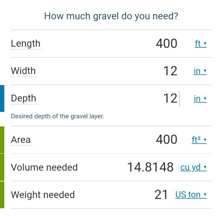

Any idea how much gravel I'd need to go 400 feet long 1 foot deep? Drain tile being 4 inches I assume? Might be my cheapest route, pretty sure I know guys at my work with subsoilers.
   / Box blade #7
I buy a lot of 12 inch diameter 80 psi pvc pipe for less than $6/foot delivered to site. So 6x400 $2,400
That said You have not provided much information to help us help you. Need more info and pictures slopes maps.
   / Box blade #8
4" drain tile will plug easily with sticks and grass.
   / Box blade #9
Pictures would really help. And 4" is small.
There are gravel calculators. You wouldn't need this much since pipe take up room.20210221_201244.jpg
