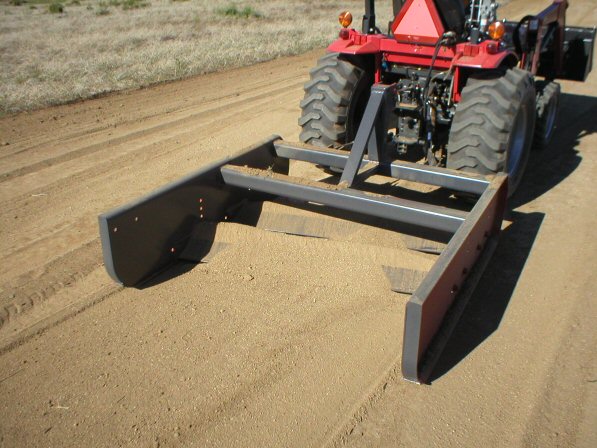

Ron, if you have a mile of driveway to maintain, I would seriously be considering a land plane grader blade.
Yep, those work very well too.
[ame=http://www.youtube.com/watch?v=OIed2lzfQ-g]How To - Tractor Land Plane - Gravel Road Maintenance - YouTube[/ame]
