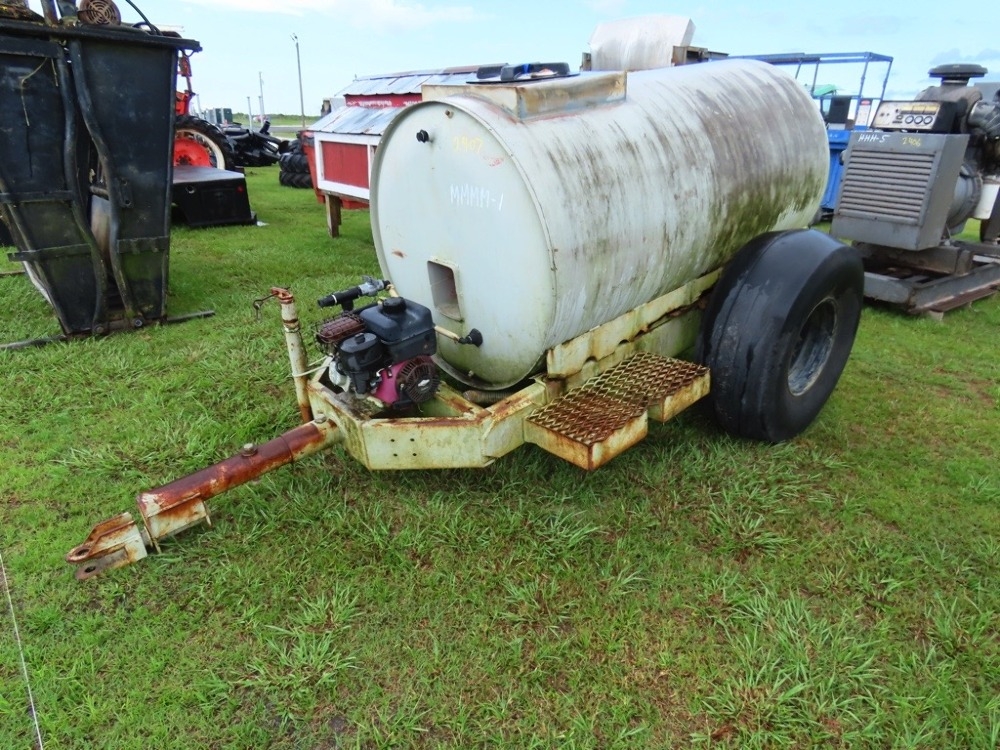

Anyone know the name of this type of implement?
