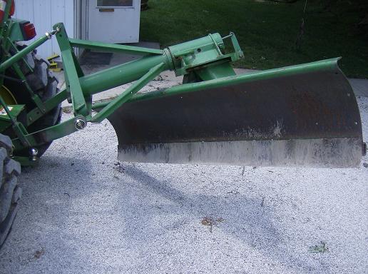

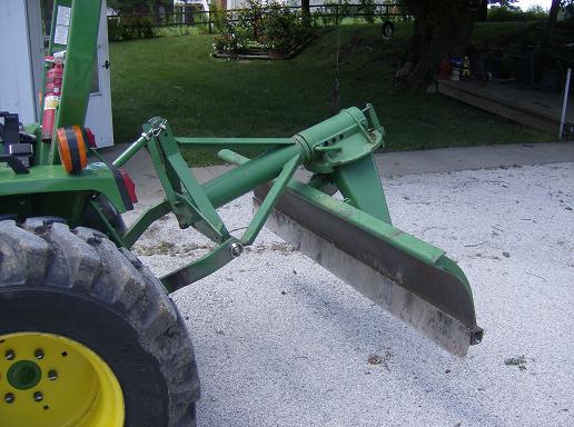

Now if I had this...
TripleR has my tastes... I like that rear blade he had pictured. I just sold the tractor (with duals) that is pictured, but would still like to have that rear blade. I have a boxblade sitting unused because I have a dual blade grader that does all the road maintenance I used to use the boxblade for and a rear blade that offsets and angles like the one pictured would bring the road materials that wash into the ditches back to the center of the road and keep the ditches clean. My 3pt setup doesn't angle quite enough for the grader to do that.

Hey Triple R, good picture! Mine blade is exactly like that except a little smaller and mine doesnt have all those pesky hoses and parts on it! Andy
David from jax
Just gotta love those big John Deeres.:thumbsup:
That tractor belongs to one of our renters and he will do any work needed, I just like to do it myself though sometimes you just can't beat the right equipment and experienced operator.
Yours sounds about like mine.
