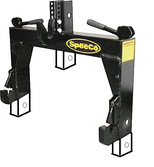

I think secret with using quick hitch is making each implement compatible with one QH setup.... Unfortunately the industry is all over the place on 3PH setups (due to long time adaptations of many, many years) and only now "some" manufacturers are adopting QH standards.....
My plan is to make all my implements compatible with my QH, do it once cry once, be happy for long time...
Only wrinkle in my plan is I have SCUT and in lower position lower hitch points are only about 8 inches off ground, and at full lift only 24 inches, that severely limits how much actual lift I have ( seems most implement manufactured have lower pins about 14-18 inches off ground for BIG tractors.... Am thinking I may lower attachment points of QH about 4-6 inches (weld on extensions) to give me more initial height of QH (on tractor arms) and therefore more vertical lift capabilities... Does this seem reasonable?

Yup, modify once, cry once. Or cry every time you hitch up.

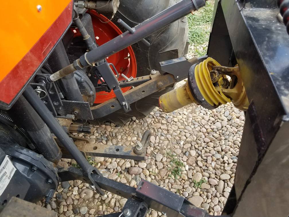

Most tractors have multiple holes in the 3pt arms. The closer the hole the lift linkage is attached to the more motion you get. The cost of course, as with any lever you trade distance for capacity. Try moving the lift linkages to a closer hole & see if you can get more range while still lifting your heaviest impliment.
You can see I have mine set to the middle of 3 holes on the lift arms on my L4060 (along with a PTO shaft on my trencher that is about a foot to short from either end bring able to touch, excarcebated by a QH, but was still way to short without the QH). I havent fiddled with mine as it easily lifts my heaviest impliment & I have plenty of range (enough to rub several PTO guards). My TnT cylinders hadn't come in when I took the photo. My old L3200 had similar holes. 20170516_120208.jpeg

Don't have the luxury of having other holes I can move lift arms to.... And being so close to the ground already I can not see much gain.... BUT by add maybe 6 inch extension to center and lower mount points of QH I can go from 8 to about 14 inches initial height at lowered position, a quick visual on my SCUT seem to show plenty of room for clearance as the 3PH arms will be in about same position its in now with the QH assemble sitting about 6 inches higher (may change some of the "leverages" a bit)...Only consideration will be if running PTO shaft the I don't raise whatever that is on rear to point where I pinch or bind PTO shaft...
This is sort of what I invision but how much drop will be dictated on how close I can get top pin to cross arm... May have to put brackets on back of cross arm and shorten top adjustment just a bit ( have about 3+ inches I can shorten top adjuster)...
Seems to me if a manufacturer wanted to make a SCUT specific QH with lower mounts they would enjoy a pretty good and exclusive market from SCUT owners... And make more off the dealers lot attachments easier attachable...

That is a thought.... One side of mine is solid (non adjustable) and one is adjustable, but It would only gain me about 2 inches max, by shortening up both rods....
