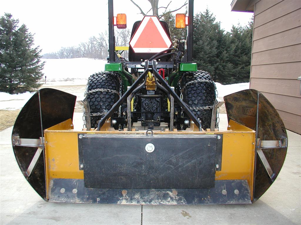

Keeney, I have thought about this before also. I think you are on the right track. I would think that the boxblade would be the greatest starting point. I would look into having the forward facing blade of the boxblade sharpened up real nice, and maybe keep it for only-winter use after that. To the top of the bb, you add a spray tank, of maybe 60 gallons. There's plenty of structure to mount it to on the bb frame, pc of cake. It can then gravity flow to your towel drag system out the back side there. and you can remote the valve to turn on the water, mechanically or route the hose close enough to reach the valve from the tractor seat. Now, add your front-mounted rotary broom on the quick-tach on the front of your 4100, and its the perfect package. The only thing you are missing is the mechanicals that auger and store the ice chips in a big tank. so instead you must pull off the ice with the boxblade every few rounds to lift and dump. If I lived on Lake Z., I would have this setup. My wife loves to iceskate, and my buddies and I ice-race our atvs out there.
Since I don't live on the lake, I made this half-pipe building attachment (see attached photo), to make runs on our sledding hill when the snow gets deep enough.

jimgerkin, How about some pictures of your half piper in action or the results. I'm building a sledding hill thru the woods for my grandsons that has a couple of turns that could use some banking. I did some skeleton sledding at the old Lake Placid bobsled track in the 80's. You just can't beat a good sledding hill. MikeD74T :D
   / Box Blade Used as Ice Resurfacer? #17
Yeah Jim, start a new thread and give us some pics. I'd love to see how the the run.
