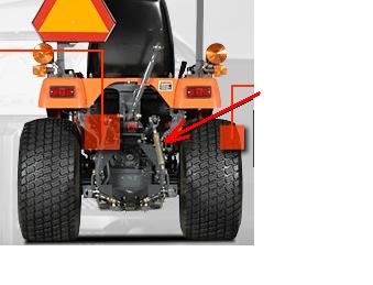

I found a post that talked about drilling some more hole up higher on the arms and moving the pens up....
Well I just talked to the dealer and he seems to think the 3 pt will go "a little" higher if I drop my MMM deck..
wait I just had a thought (yea it hurt too) on the right side the arm had a turn buckle to level (see attachment) whatever you have hooked up..... What if someone was to but the same arm on the left side?
   / Box blade tricks on a BX
#12
Now you guys see what kubota do to people i am now talking to myself. /forums/images/graemlins/crazy.gif
Turn buckle is only about 25 bucks but. if I put one on the left side also and turn both up....will this in turn change the angle of the blade foring my to adjust the top link out more...Then putting me back where I started?
