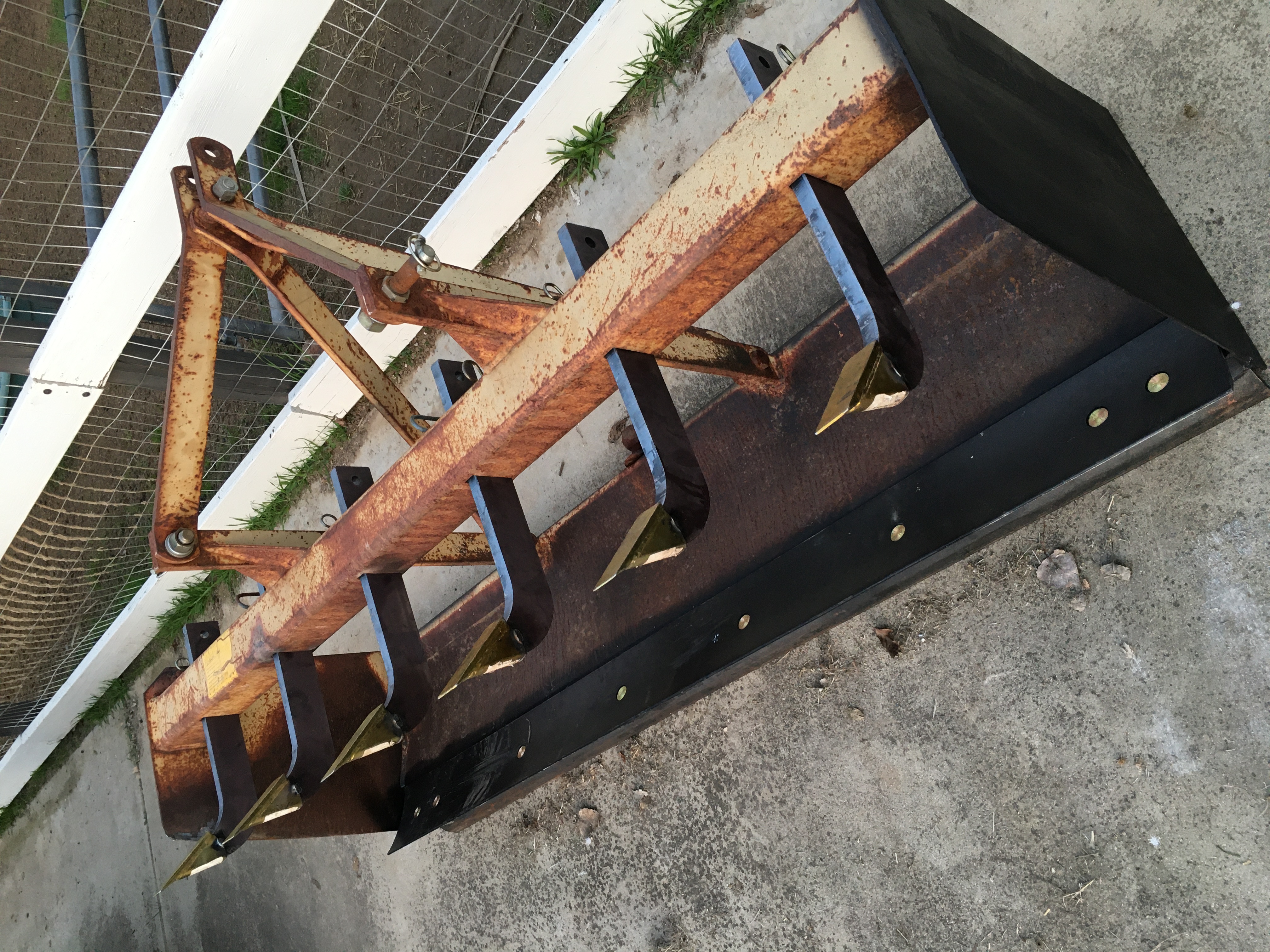

I went to a steel fab shop and they made me some and spot welded teeth on them for less than buying online or at a store. IMG_1212.JPG

I guess I got lucky. I was at my LS dealer (about 10 years ago) and saw a pile of scarifiers laying by the door. Asked if they were for sale and how much, the owner said $5 each so I bought 4. Still have a couple left. They are easy to bend and break with my LS P7010 if using it in 4 WD. I find I do less damage to the teeth if I just use 2 WD. I do like those shop made ones, they look much thicker and stronger than the ones I have.

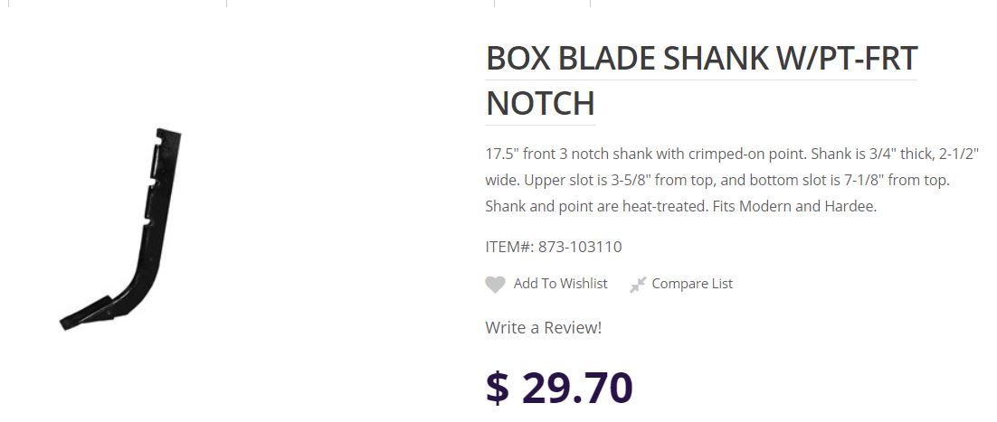

Can anyone tell me if box blade shanks with rear slots will work on a box blade that came with shanks with front slots? Having trouble finding reasonable priced shanks.
Quality Farm Supply has shanks with front slots for $30. Don't know how many you need, but they have flat-rate shipping of $9.00 on orders under $200; free if over $200.
https://qualityfarmsupply.com/product/BUCKET-TEETH-ampersand-EDGES/BOX-BLADE-SHANKS-ampersand-POINTS/Shanks/873-dash-103110
/ Box blade shanks #14
Make sure the length is right and the notch spacing will fit the frame of the box blade.

Thanks that is the best deal I've seen. The BB is a Modern so they should fit. Need 6 of them for a full set. May watch CL for a while before ordering them. Have plenty to do.
/ Box blade shanks
#16
Decided to go ahead and order 6 of the shanks and clips to go with them. Looks like just what I need. Thanks again for the recommendation!
