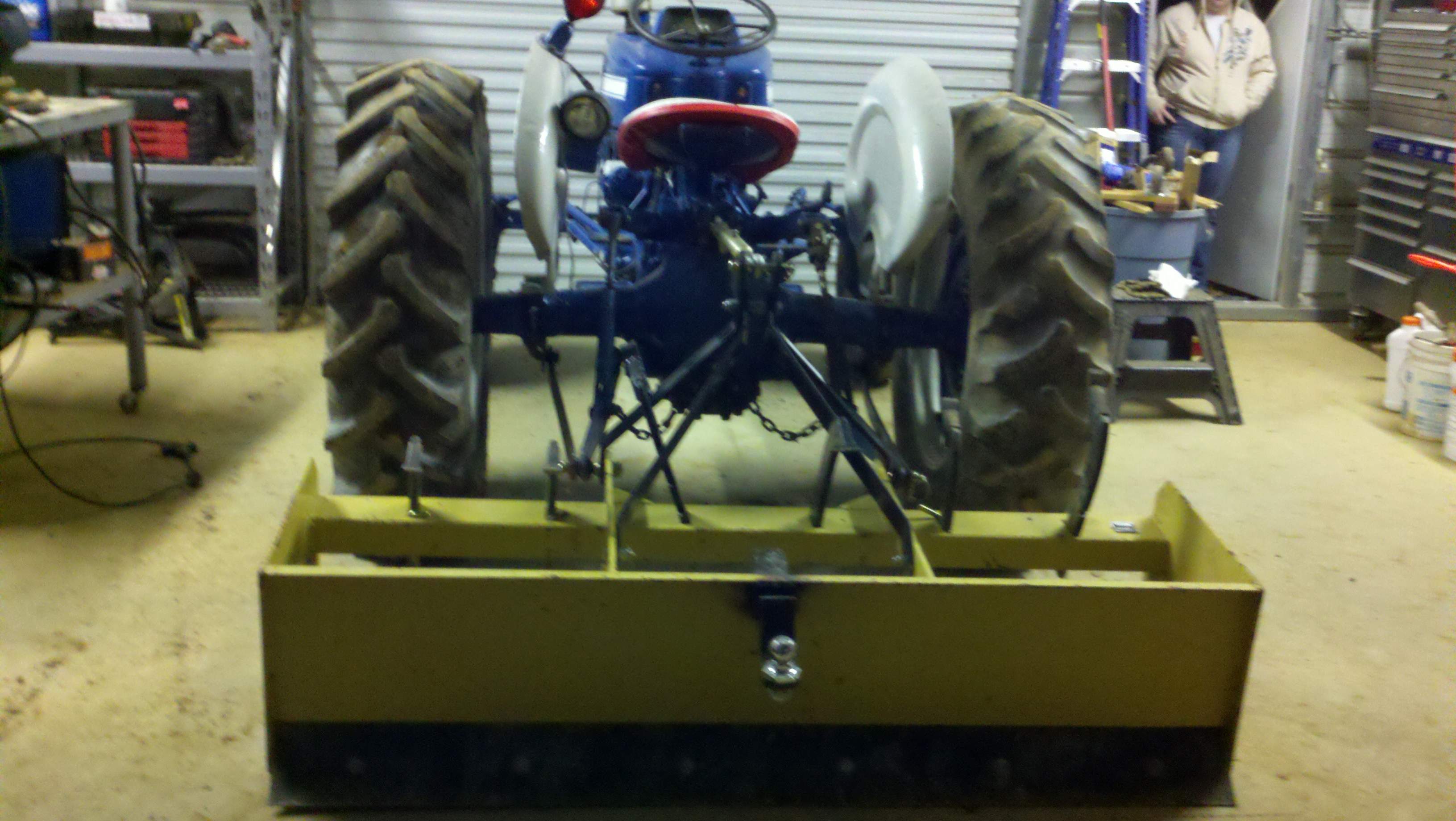

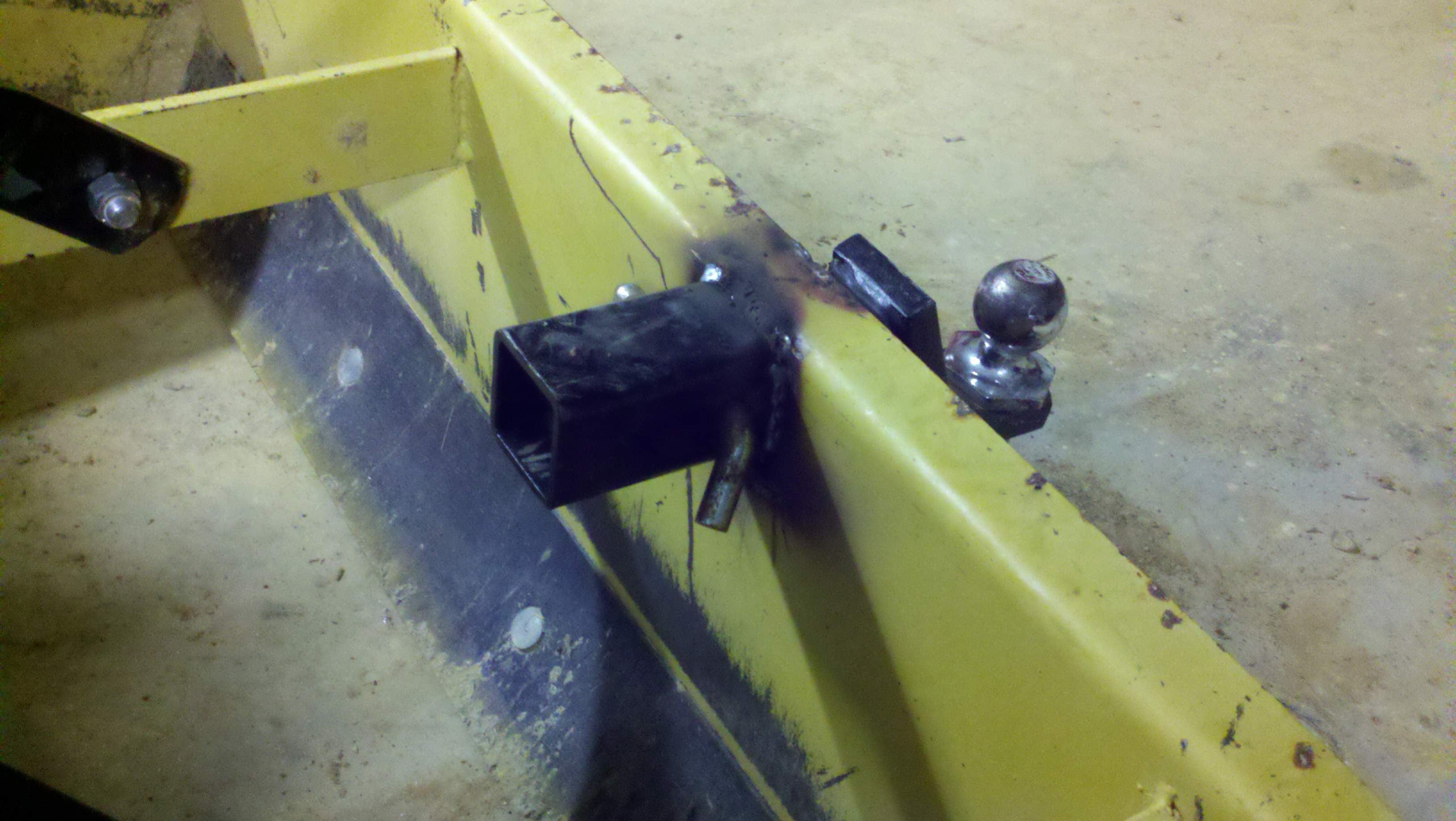

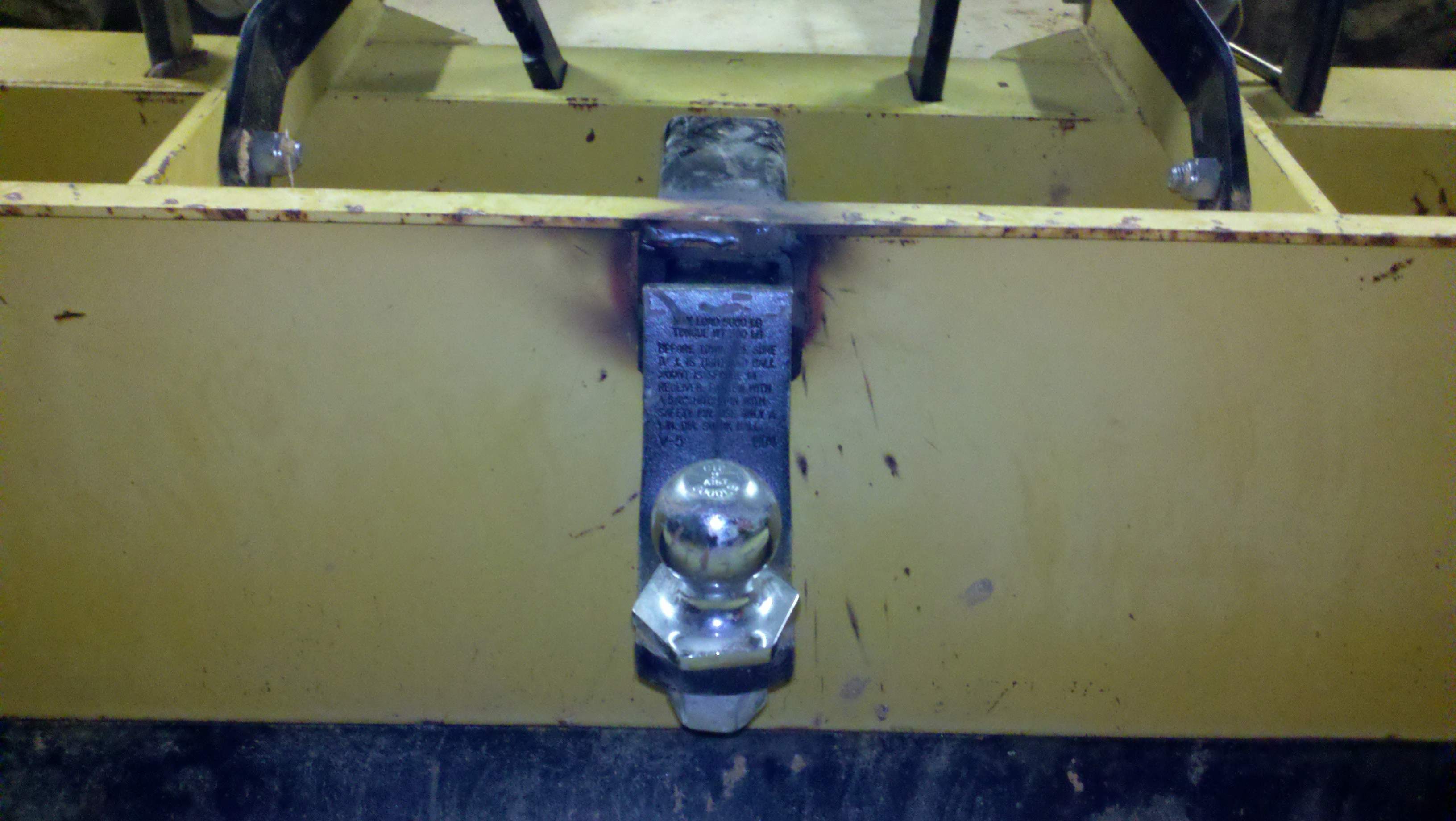

I know that this has probably been done allot but this is my rendition of it.:thumbsup:

The two inch receiver is a good idea.
Looks good.
/ Box Blade receiver hitch #6
nice!:thumbsup: now to coat the welds with paint, you are all set.;)

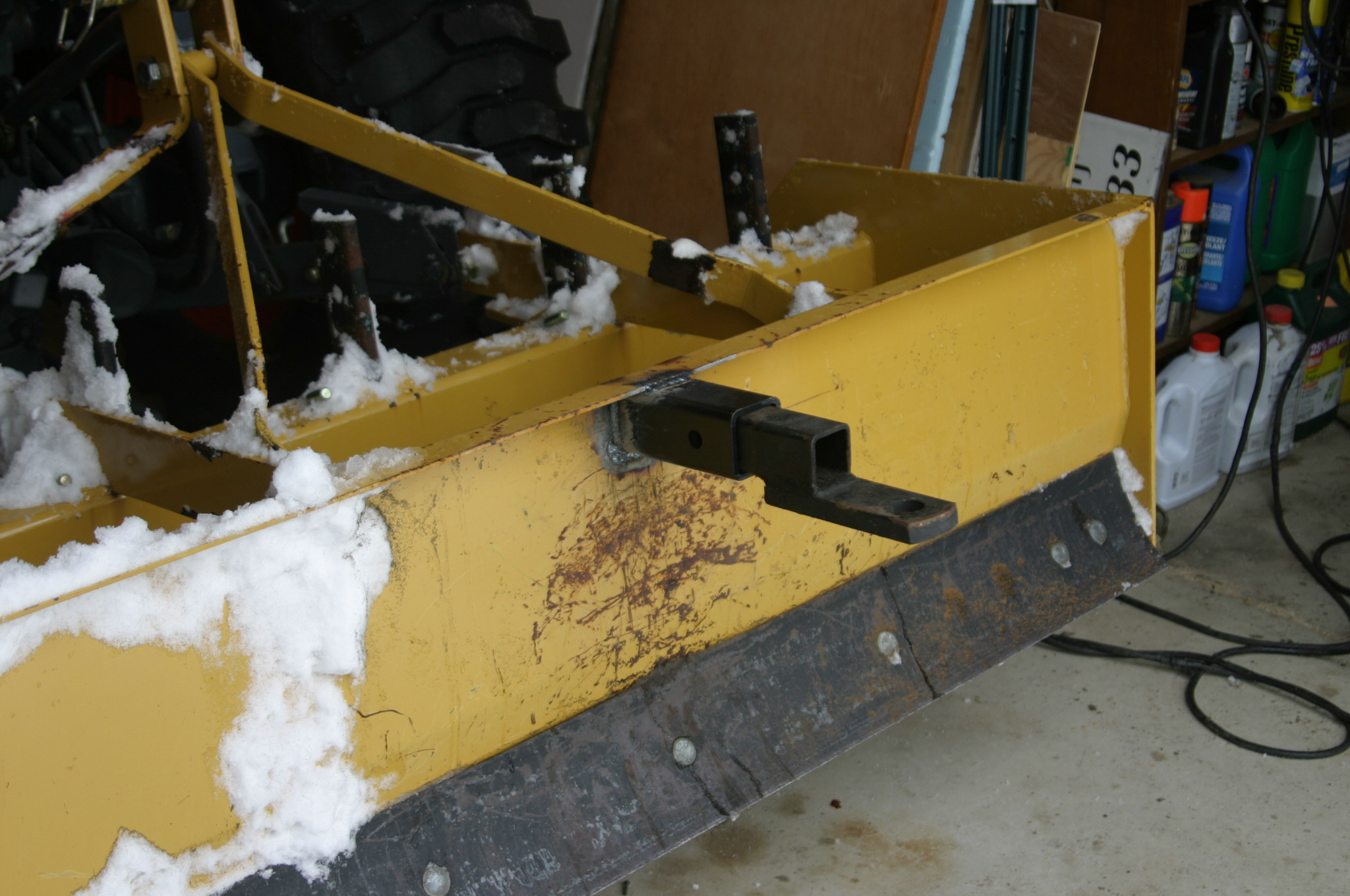

/ Box Blade receiver hitch #7
TSC has box hitch reducers for under $10 that work good for that.
yeah i used the same sleeve as Jake 98 the only thing really different in mine is I plasma cut a square out and recessed the hitch so it is flush with the back of the boxblade.:thumbsup:
/ Box Blade receiver hitch #11
I was putting it off because I didn't want to spend 40 bucks or so for a real receiver hitch to weld on there. I may buy a couple more just to have them. You can see the tell-tale scratches on my BB from moving trailers the barbaric way by just hooking the safety chains on and letting them crash around back there.. glad that's over with. :D I have a carry-all that's converted with a hitch, but the BB seems to be on there the most.
