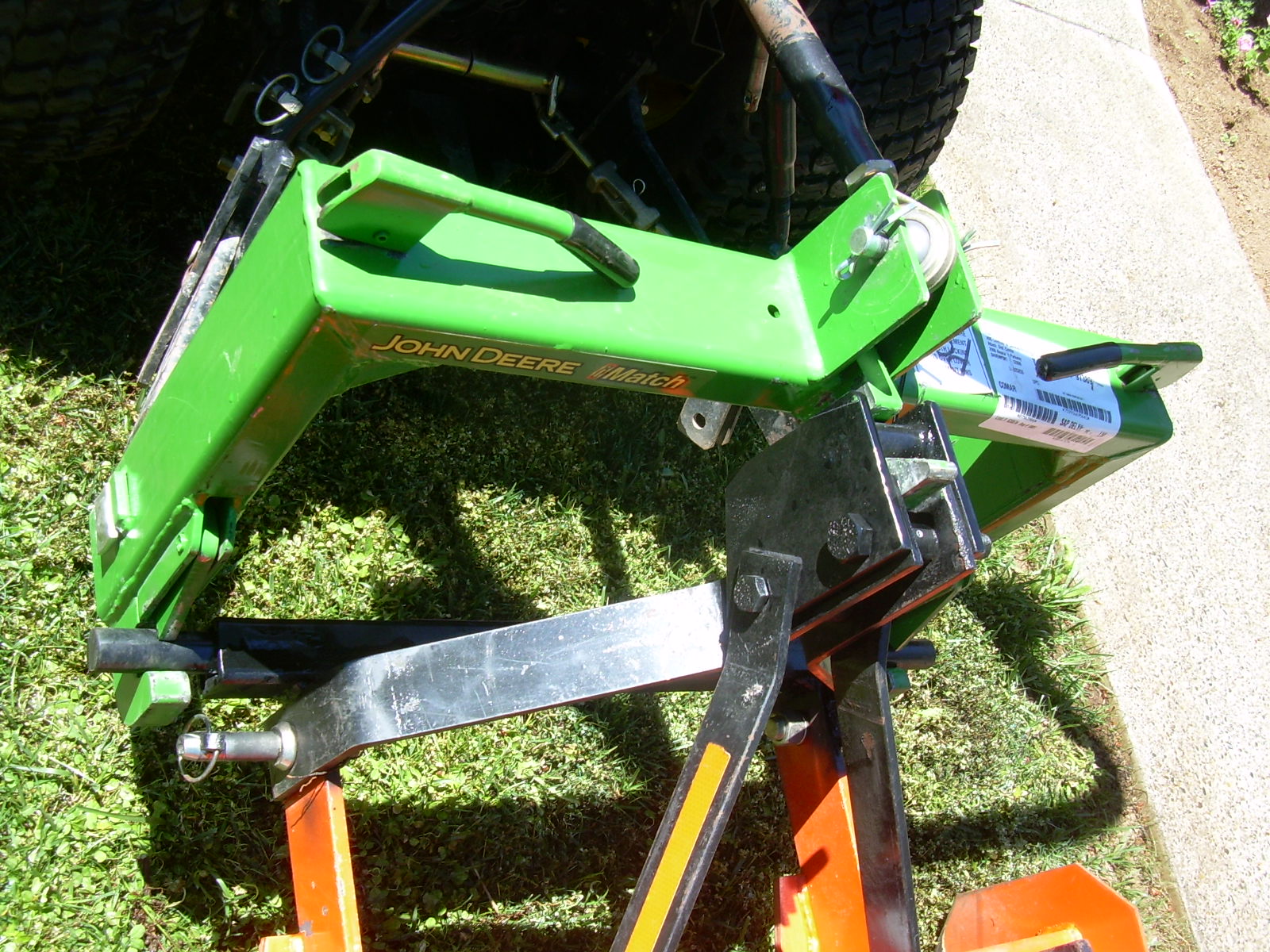

My boxblade (KingKutterXB 4') is a nice little implement.:)I have done some heavy duty work like tilling an arena as hard as concrete or when I dug out a footing for a concrete pad. Very nice little implement and it only cost $425.oo. This was my first implement and has always lived under cover. when I boutht my imatch system, it was to wide to attach to the boxblade so I had a new hitch welded on and it works great.:D sadly it only works on a tractor equipped with an imatch system.:(
