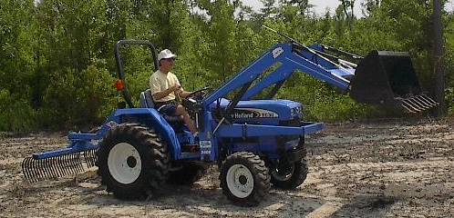

Cdash, I am doing the same thing on my 10 acres. I have cleared a 200' pathway from my home site to the area I will be clearing for horse pasture. Like you I do not want stumps, even small ones, in my roadway or pasture. So far I have used a combination of FEL w/toothbar and a landscape rake, and will finish with the box blade on the pathway.
My first pass through was with the FEL / toothbar grubbing up the small trees (3" dia max) and large brush. Followed that up with the rake set to a sharp angle to remove the root mat along with most small brush. Finally, I will be using the BB this weekend to smooth out the pathway eliminating high and low spots and getting rid of the dead-ender small brush that survived the rake.
I have a Loflin toothbar installed by my dealer. Loflin Toothbars
