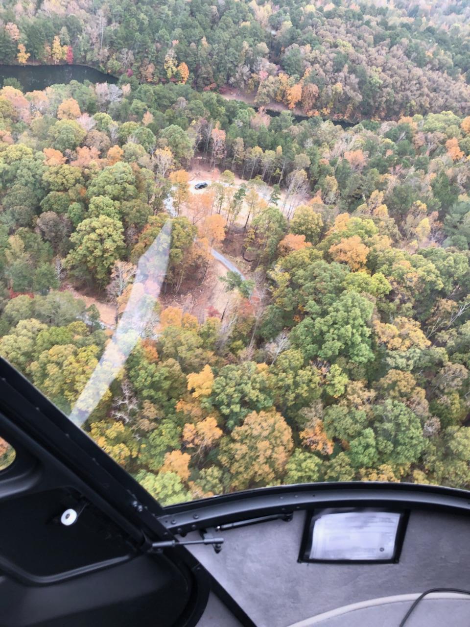

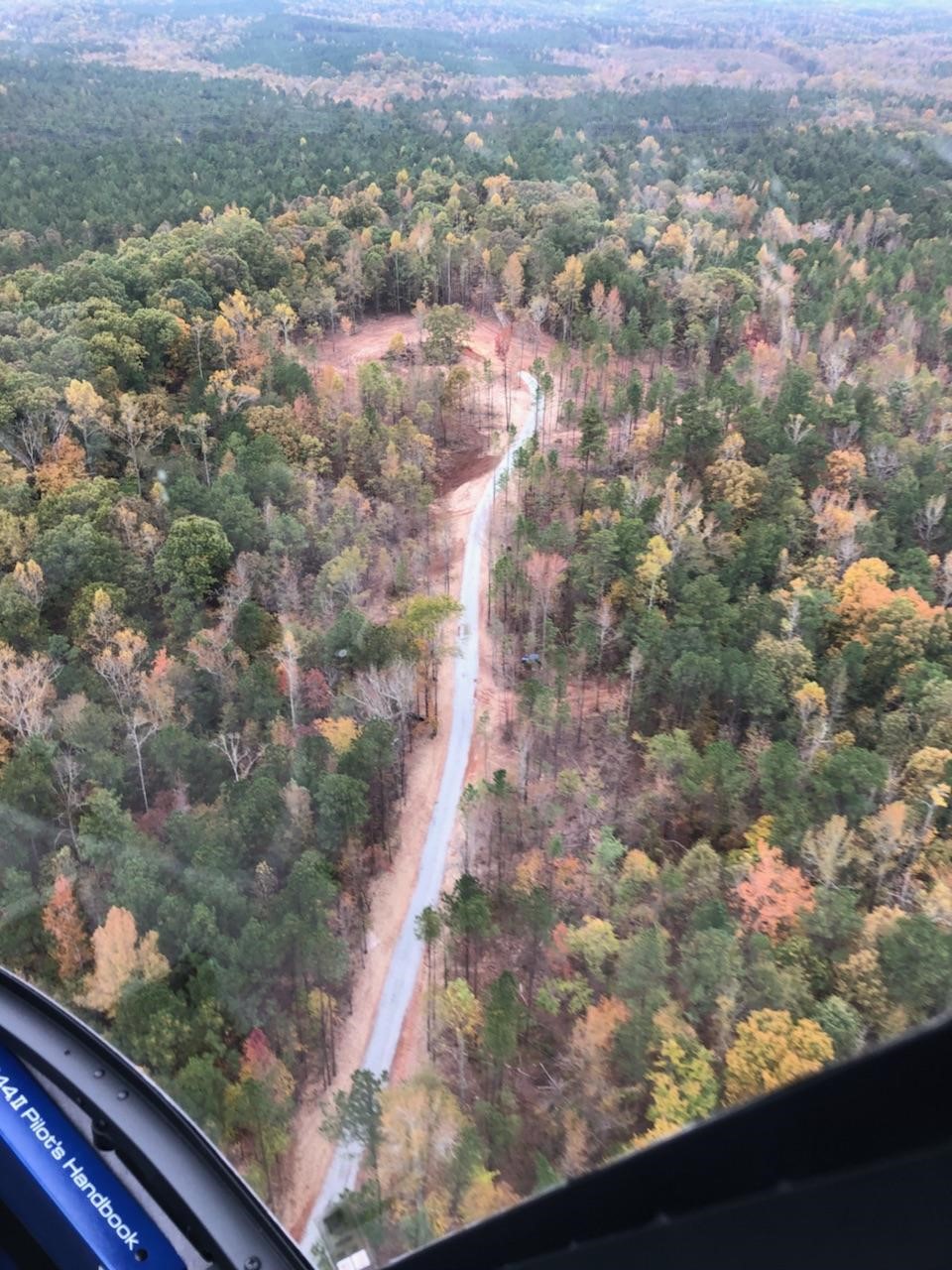

Wow, what a great post zzvyb6! This is exactly my intended us! My tractor is 72" wide...rake (EA Land Shark with center gauge wheel) will have 45 degree angle and 30" offset ability). Would you still recommend an 8' rake, or a 7? My road width is 12' wide, 15' in the curves, #34 rock. Photos below...kind of hard to see, I know.
The EA has a slot for floating...only about 5" of slot. Are you saying to not use that and instead use a chain since a slot might bottom out?
For the scarifier box blade guys, I would not do that. The last thing I'd want to do is dig up my compacted road bed, which took a long time to settle properly. Much of my number #34 is compacted so well its like concrete. Some places need dressing...mainly pulling rock back from the edges and into the low areas. I rather do a nice refinish with a rake with gauge wheels...2nd choice would be a rear blade w/gauge wheels, 3rd a land plane, 4th a box blade with no scarifiers, and last box blade with scarifiers down.
