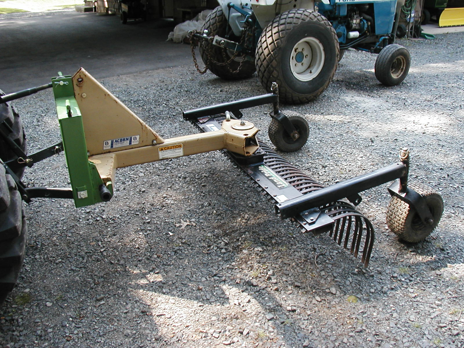

First of all, none of our 3pts have down pressure, so your not at any disadvantage there.
The sharing thing is a great idea, each of you only has to buy one implement, but have the pick of all 3.
As far as the cost of gauge wheels, they do whack you good for them, but just pay for the stock ones and don't fool around trying to make your own, JMO
JB.
Here's a pic of mine.
