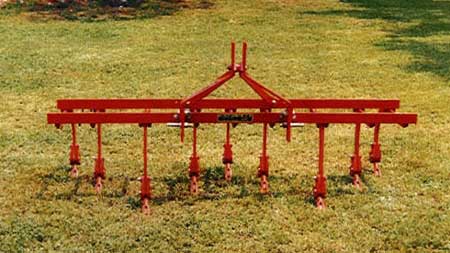

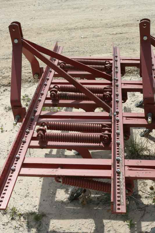

   / Box blade help #28
Hey Greg,
I reviewed this thread and was looking at those links you posted at the beginning. I was wondering if you knew whether some of those "plow shaped" scarifiers on one of those could be changed over to fit the box blade scarifiers. I was thinking of doing that if they fit. Now that my plots are ripped, plowing them (not too deep) with a set of those would really work. Maybe only use 3 or 4 instead of 7 (on mine). What do you think?
   / Box blade help #29
3RRL said:
What do you think?
You're talking about cultivator heads I think. If you can find a way to strengthen the shanks, I don't see why it wouldn't work. Because if/when you find them available individually, I'm wondering if they'll actually fit in the scarifier slots on your BB crossbar. I think I'd prefer to modify the shanks rather than the BB
In the end, it might be simpler just to buy a field cultivator.
//greg//
   / Box blade help #30
I think modifying the shanks is a good suggestion.
The shanks are cheap at Agri-Supply so I could buy a few spares and mount a cultivator head on them. Do you know if those heads are available separately? I would like to try it.
