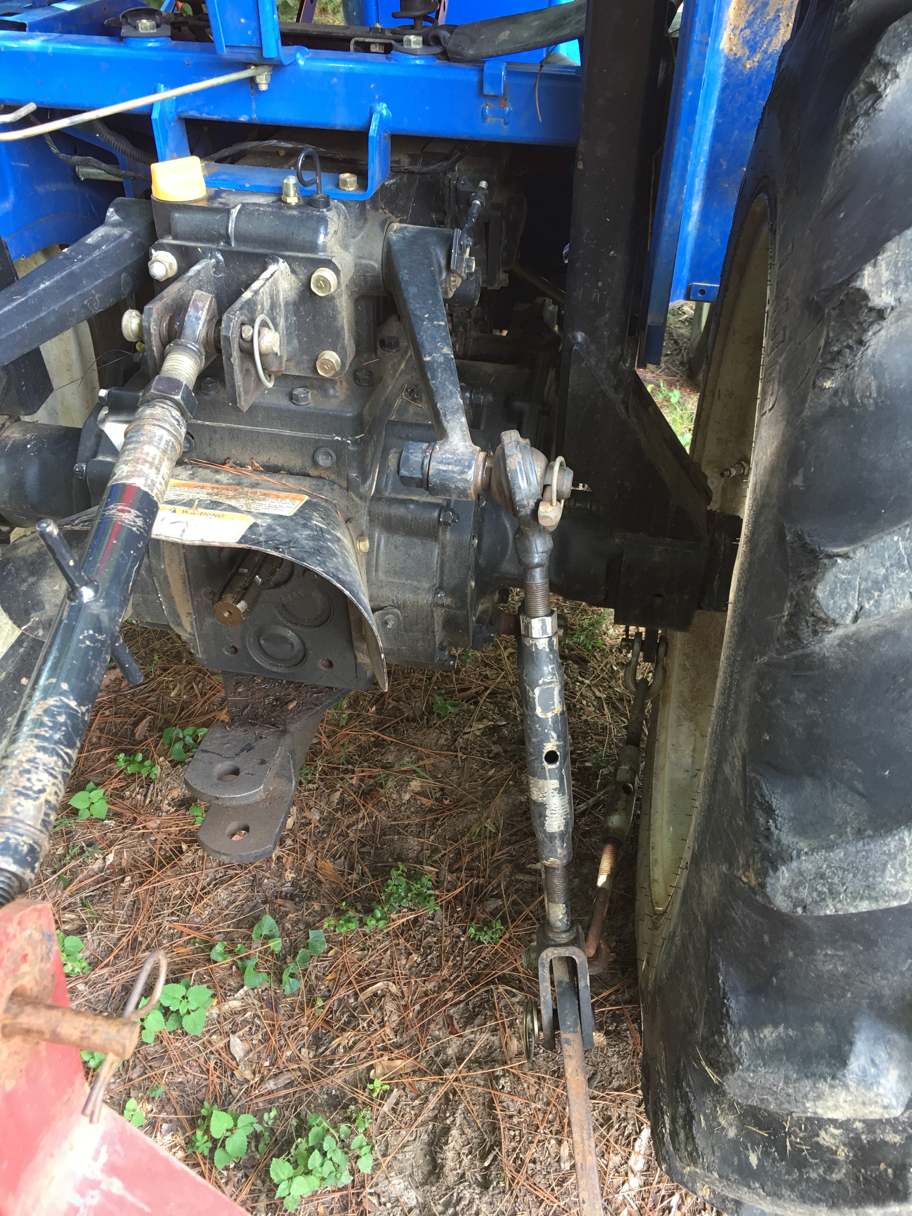

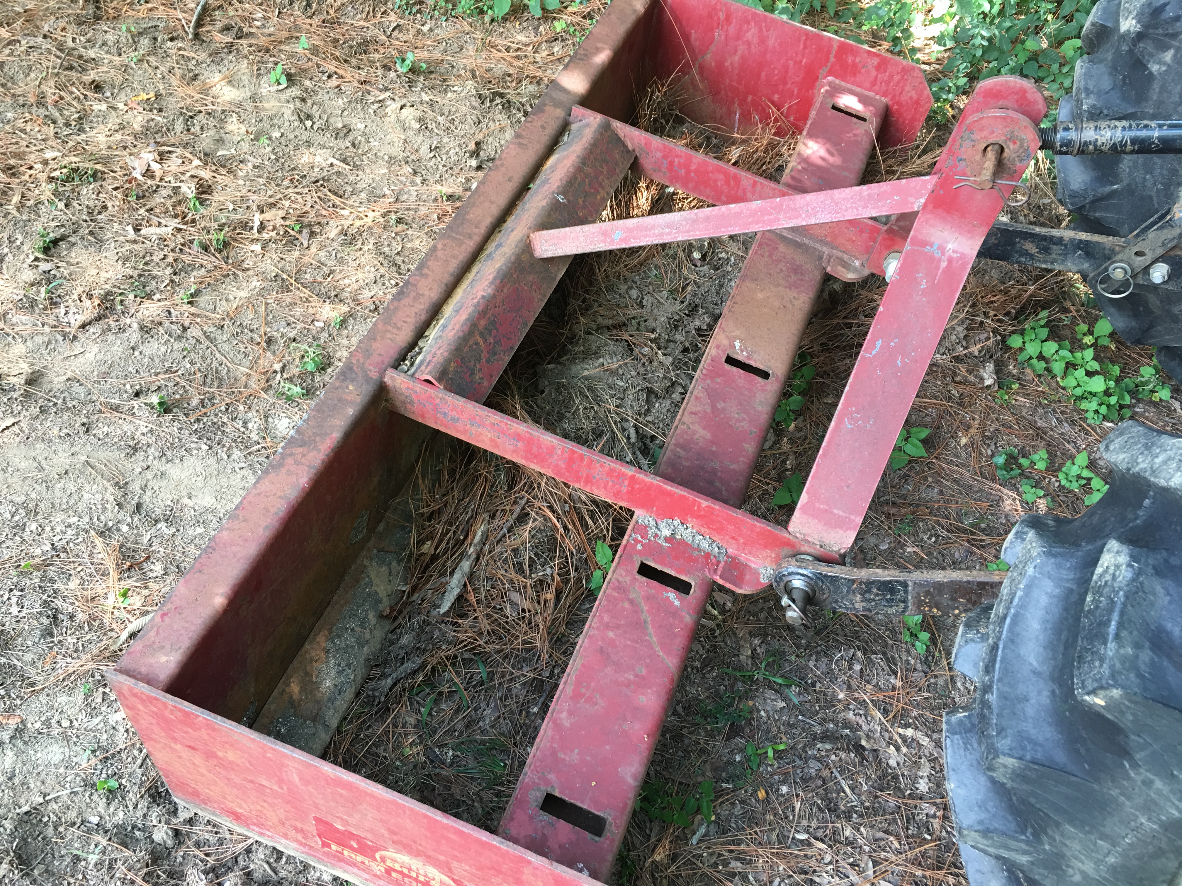

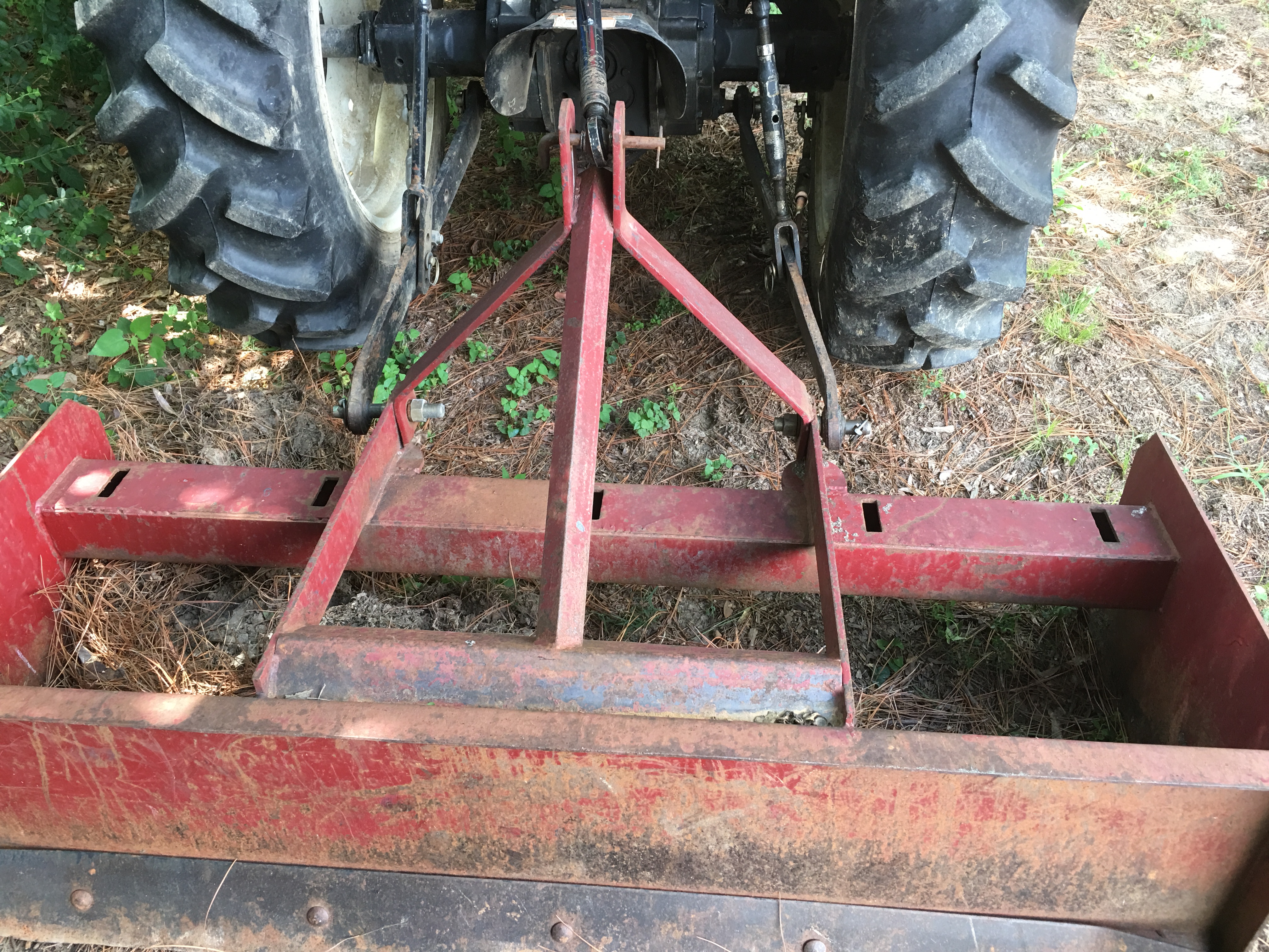

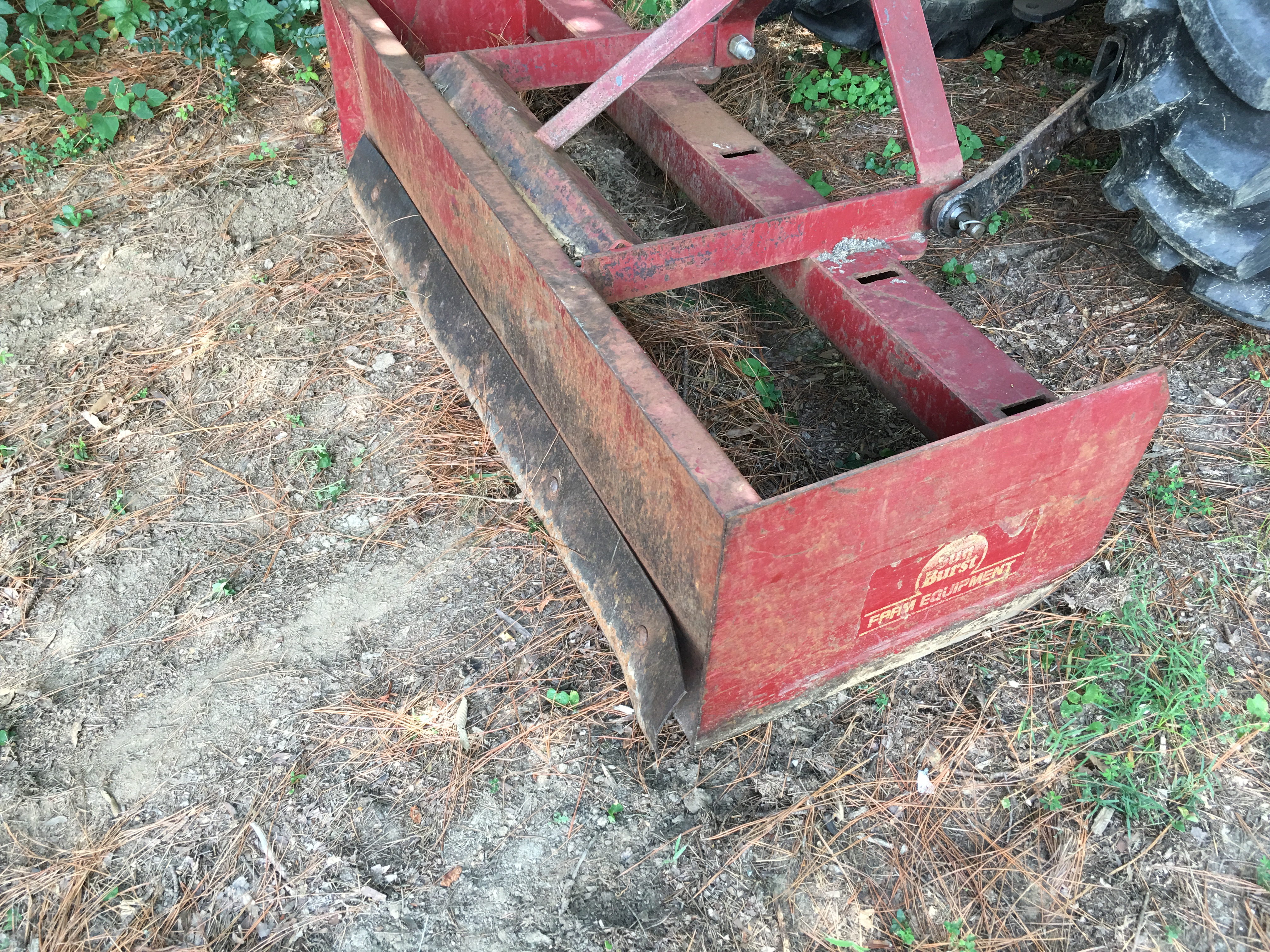

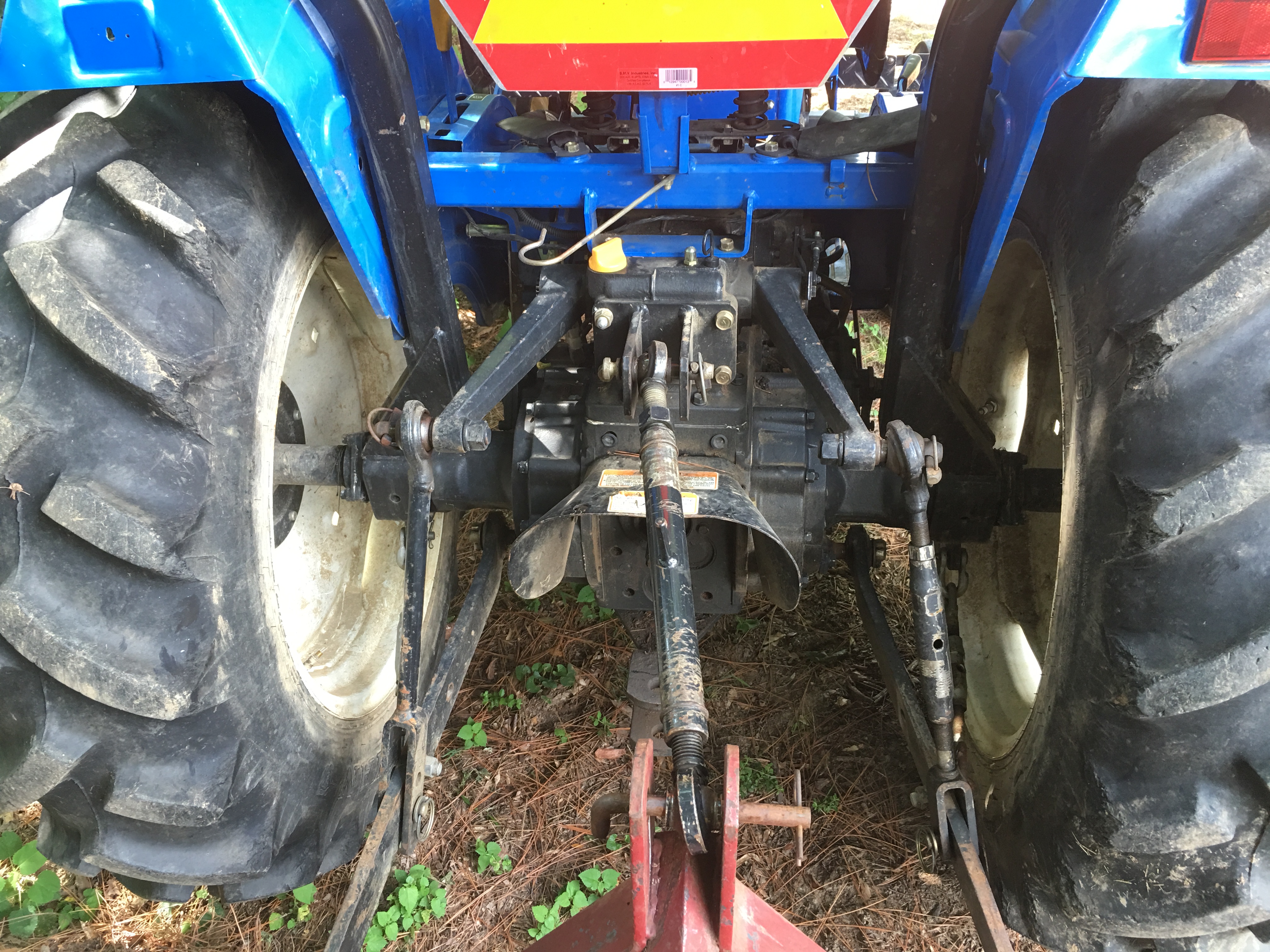

I have a TC-30 that came with a box blade that I've been using as is, but it doesn't have any scrappers and the adjustable turnbuckle need replacing I think, because I can't tilt the blade or adjust it with it.
Is this worth fixing and what would you suggest?
I'm attaching some images of the box blade.
Thanks for any help

It sure looks to me like you got enough adjustment on that top link to tilt it back. Not sure about forward. That sloppy ill fitting pin on the top link is stopping some adjustment. Also lowering or raising the drag bars might give more adjustment also.
   / box blade help 5' #3
I'll second what Jim said. You should have lots adjustment left in that top link. That pin looks wrong to me also.

I would fix the bent (rear) blade and buy some scarifiers and pins...

joybuz, You already have an adjustable side link. Is that the turn buckle you cannot turn? The vertical link on right side? It is missing the pin through the center tube, but there are wrench flats on the tube. Note that the jam nut on the top is left hand threads.
A hydraulic top link, though nice to have, is quite an expense to add as it looks like you have no rear remotes. I would work with what you have initially and take the time to get off the tractor to adjust the top link and side link as required. If you need to work in hard ground, it is definitely worth to getting scarifiers.

Thanks Stonehauler! I did as you said and adjusted the sidelink and also the toplink some and I ordered 4 scarifiers. Will try it like that and try to learn how and when to adjust a box blade like /pine suggested.
