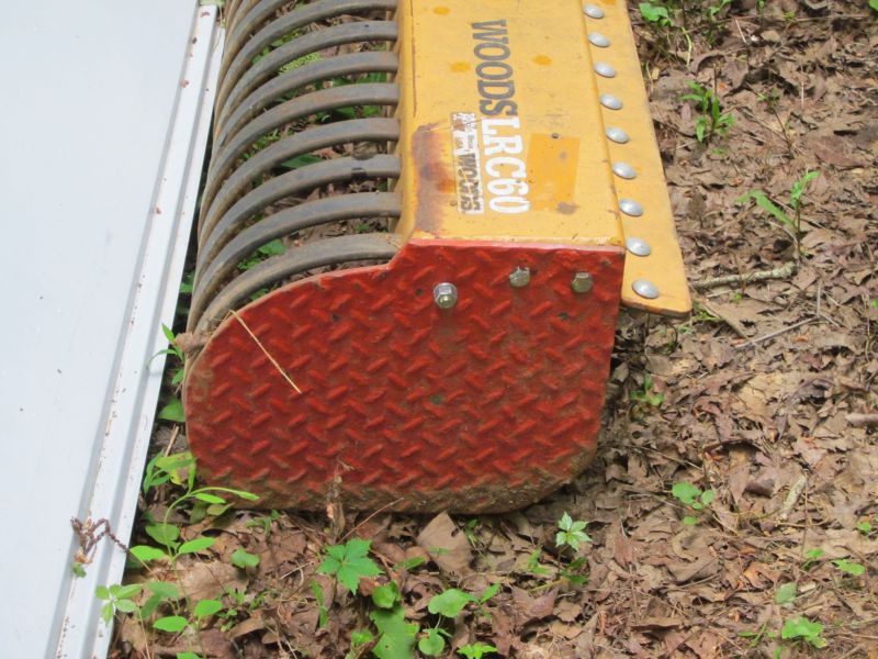

   / Box Blade Gravel What Am I Doing Wrong??? #23
I put box end plates on my landscape rake specifically for the purpose of eliminating windrows which it was notorious for leaving before...
