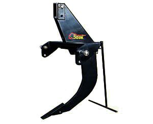

I would be more inclined to try a single subsoiler type ripper to go around the tree before hooking the stump and pulling on it. It puts a lot of forces into your box blade at weird angles when you have small isolated contact areas you're pulling from.
Something like this is what I have in mind.

Ahh, that's just the thing I've been thinking about getting. I would much rather use something like that than my box blade. I guess I first thought of the box blade because I already have it, ha! How much does a ripper like that cost, and where can a guy get one?
Thx!
/ Box Blade for Small Stump Removal #7
I bought the one that I have at Atwoods. It is a King Kutter I believe, though the shank isn't quite as beefy as the one shown in the photo I posted above. The one I have. I paid in the neighborhood of $130 for mine. A little easier on the wallet if broken.

TSC:
CountyLine® Middle Buster - 2128228 | Tractor Supply Company
Then, if you don't have the tools or ability to do it yourself, go to a welding shop and have them cut a piece of plate to make it into this:
CountyLine® Sub Soiler - 2128333 | Tractor Supply Company
I had an old shredder blade that I used to make the plate for mine. I've hooked roots up to 6" diameter and pulled them out with mine. You just drop the subsoiler blade on the ground behind the small stumps you are talking about and I bet it would rip them right out.

I have the TSC Sub-soiler ($130) and it can pull up decaying stumps pretty easily. Flush (2-4 inches) to the ground is easiest so you can drive right over them. Larger ones can be hooked and lifted/snapped with the 3pt. Used a toothbar on the FEL to pick up the debris. I also have a brush grubber ($95), but it is a 2 person job because you'll be jumping in and out of the seat to un-hook and re-hook. Works well but I'm limited to 3-4 inch max because of 25 hp tractor. I'll cut the trees to a 4 foot height and pull from there to remove roots and all. If you try to pull a 20 ft sapling, the top of the tree will be coming your way as you pull it forward. The grubber actually works the best with my 4x4 truck in low gear off the hitch receiver, but still a 2 person job. Pretty low cost approach for removing smaller tree stumps and roots.
