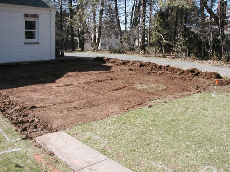

My first project was re-grading a 12' x 50' area on a slight slope fairly level for a place to put a mobile. I had to cut into the slope as well as move dirt from on end of the area to the other. To cut into the slope, I brought one side of the blade down with the lift leveler. Used the box to move dirt down the area, and finally, the back of the loader bucket to smooth it out.

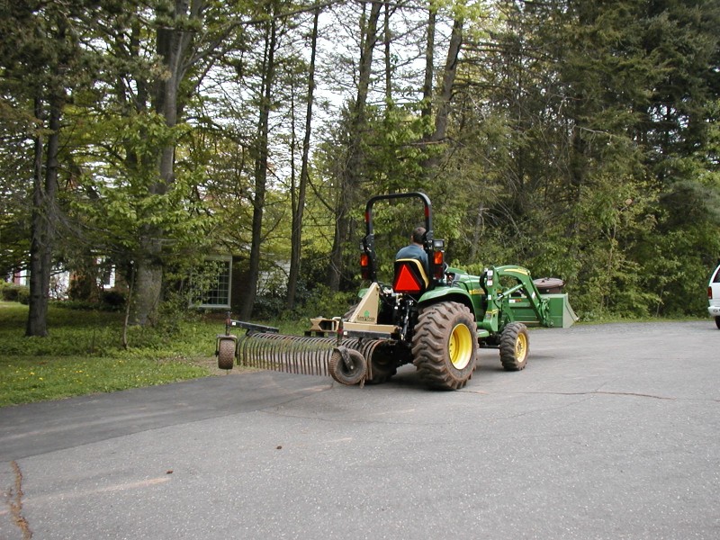

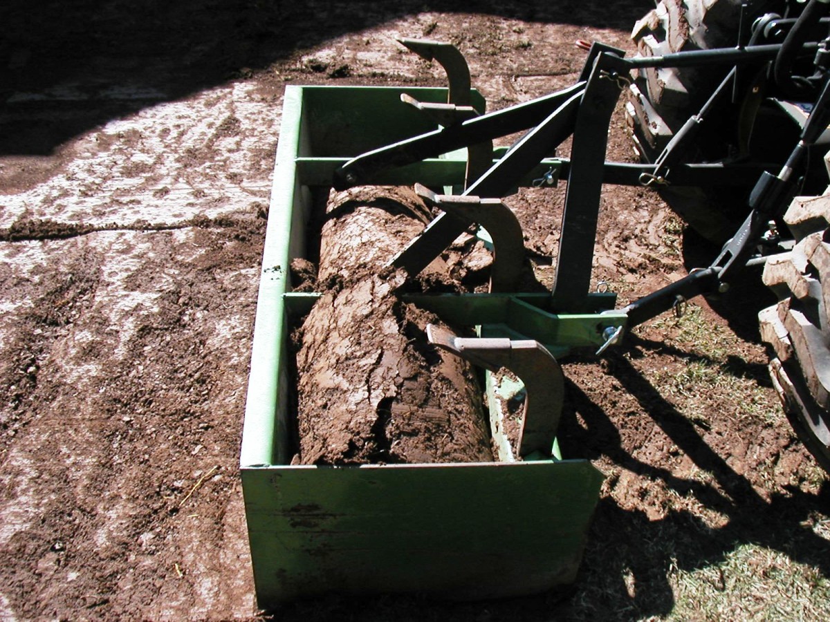

Are you cutting a new road or maintaining an existing? if you are just maintaining you might want to think about a york rake with wheels, even though I don't own one, I borrowed a 72" land pride from a friend and I was impressed at what that thing could do, I have a short dirt/gravel path/road into the wooded part of my yard about 150' long, I started with my 60" box blade and wasn't doing to good of a job so I put the rake on thinking I would just fix what I messed up and was shocked at how much rough work the rake was capable of doing and with the gauge wheels it was almost to easy and leaves a perfect finish. I've been bugging the guy ever since to sell me the rake since he doesn't need it.
Like I said I own a 60" box blade and with my 32 HP 4310 I don't think it could handle much bigger though I really don't have much experience with it, it makes an awesome sod remover and would be good to knock down heavy rough spots and fill deep low areas but it is tricky keeping it at just the right height although once it's full it tends to ride up on the surface so you can move material quit a ways, with the rake I was pulling out 2" saplings by the roots and never even bent a tine.
