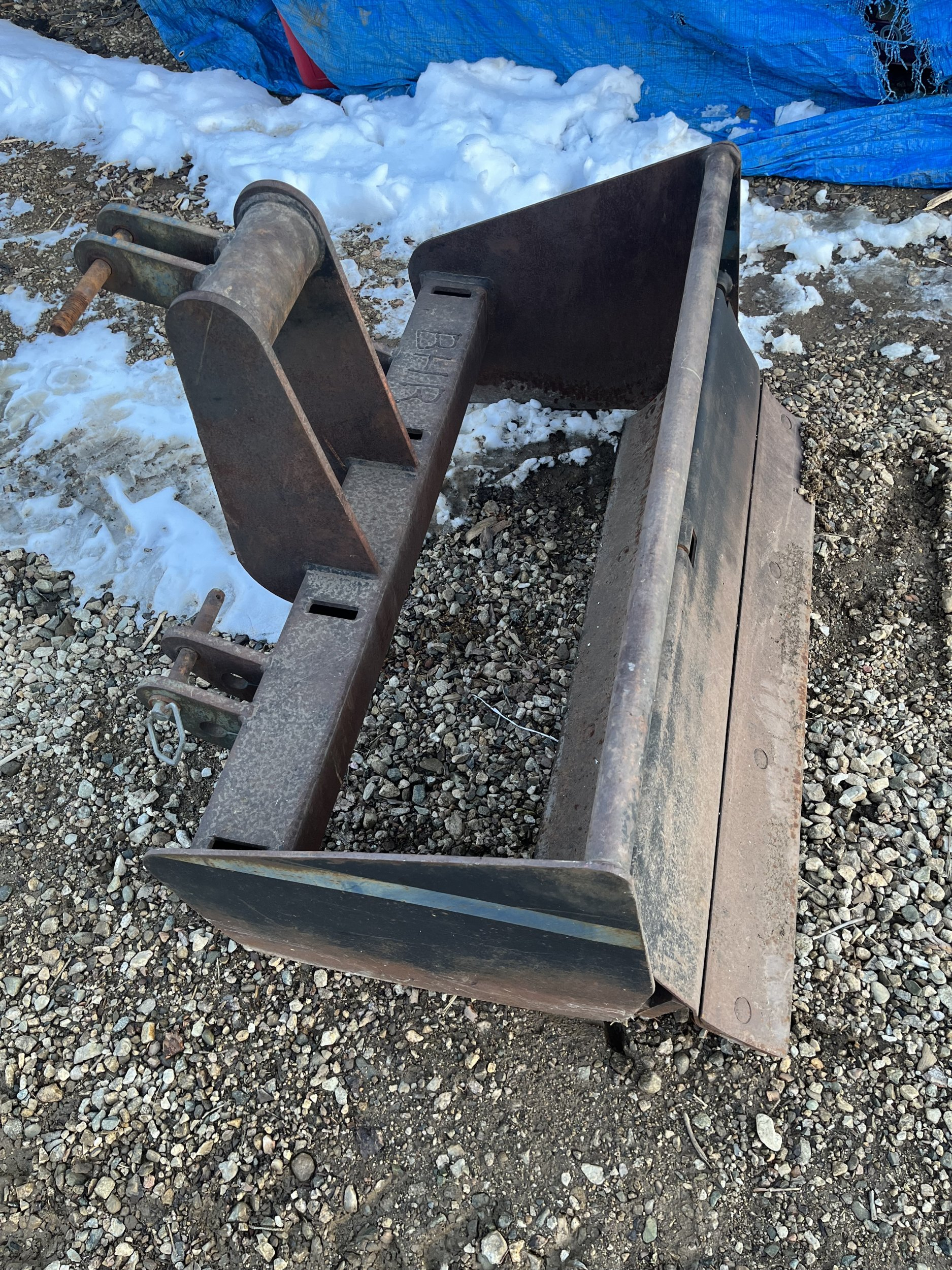

Older box blade bought without shanks 42” wide want to order new shanks any help will be appreciated
/ Box blade brand #2
That looks home made. Heavy duty for that little box!
You may need to do some measuring and possibly do some of your own fabrication.
/ Box blade brand #5
They sell shanks at tractor supply and other farm stores. I’d just measure the holes and see if you can match up something.
/ Box blade brand #6
Why do you say that?

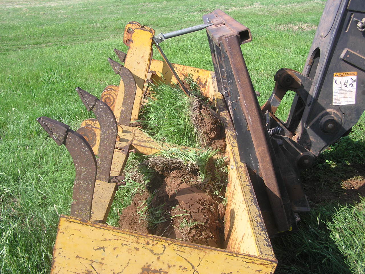

You cant use the hole style shanks with that by the looks of it. It does look close to the design of a older hayse tooth ripper.
/ Box blade brand #7

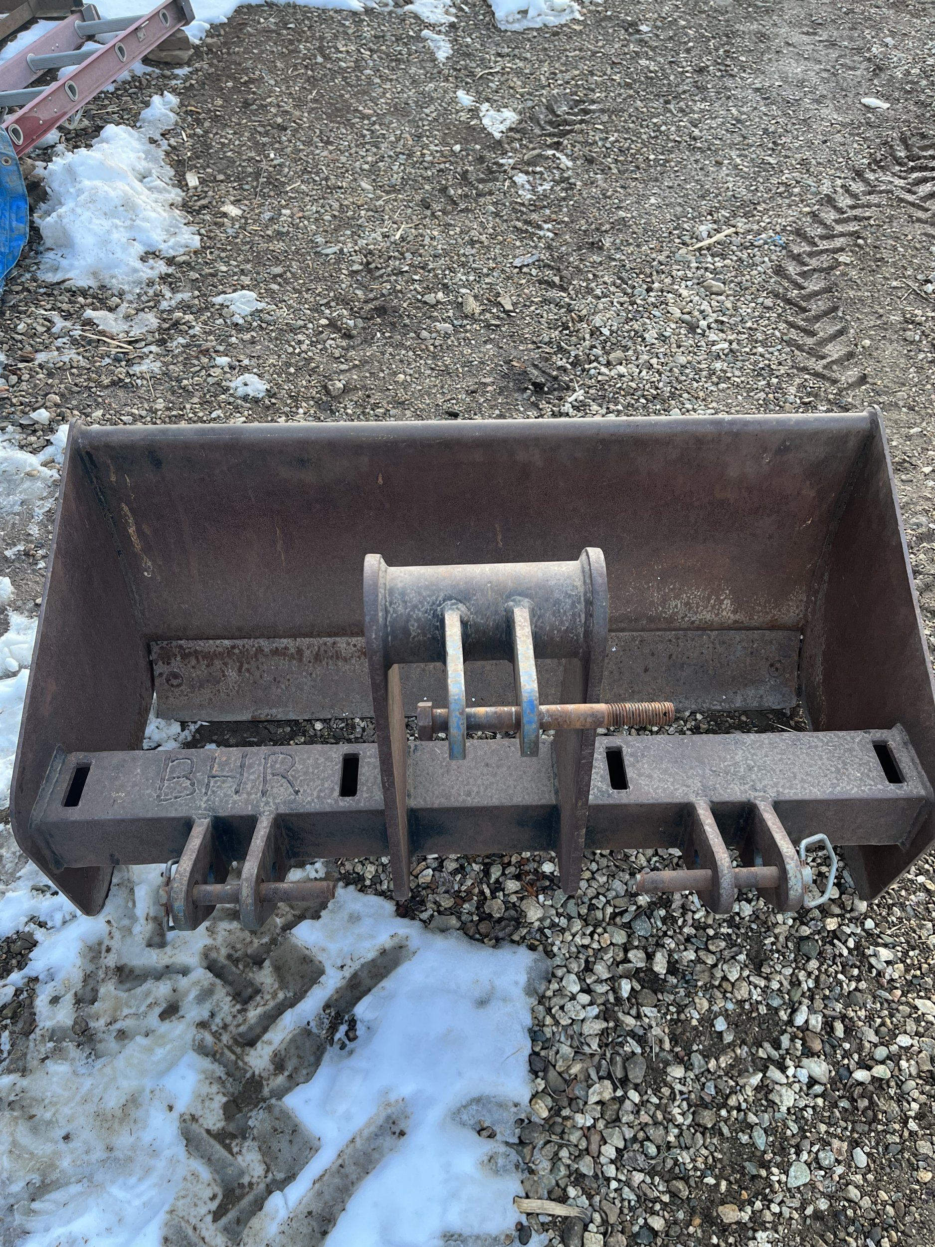

Well, all you need to do to pin some hole style shanks in place is cut some ~1/2-3/4" wide strips of angle iron, maybe 1 to 1.5" on a side, and weld them down on either side of the holes on that square tube with the points facing up, like an A. It looks like on the outer ones you might actually have to drill a hole through the side wall so that a pin inserted from the inside towards the outside wouldn't hit the wall, but that's no big deal. So, 8 small pieces of angle, 16 welds, maybe 2 holes. Would take 1-2 hours at a slow comfortable pace to be able to use the commonly available pin style shanks. I have seen them online for as little as $17/ea before shipping. On Amazon $119 shipped for 4 of em. link

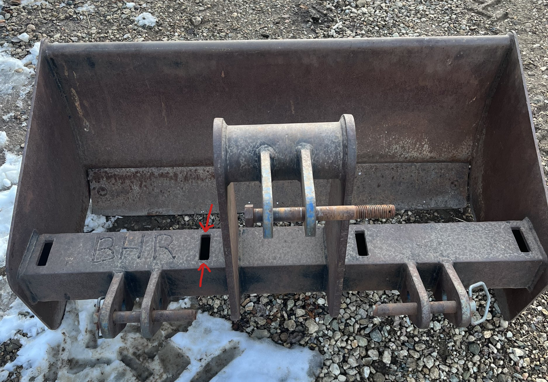

How are the shanks supposed to be held in place on that box blade? I don't see any tabs for the locking pins that hold the shanks in place to go into.
/ Box blade brand #9

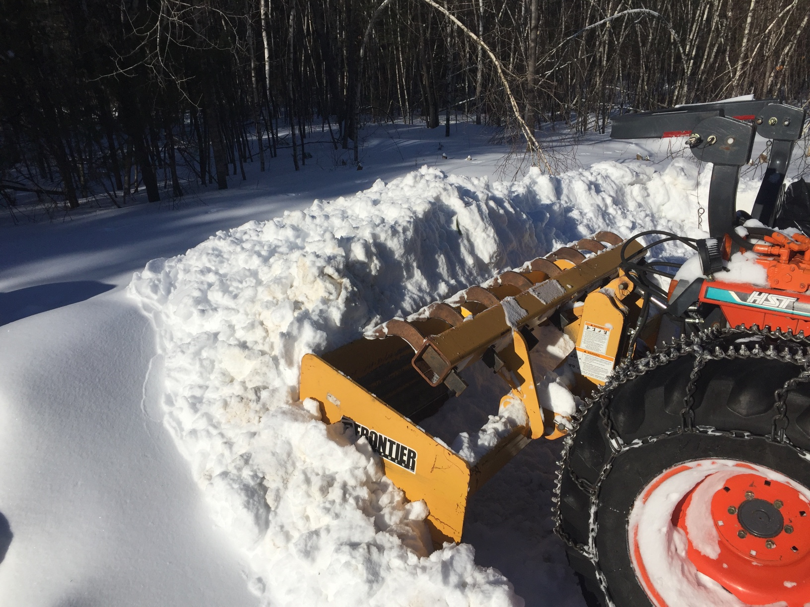

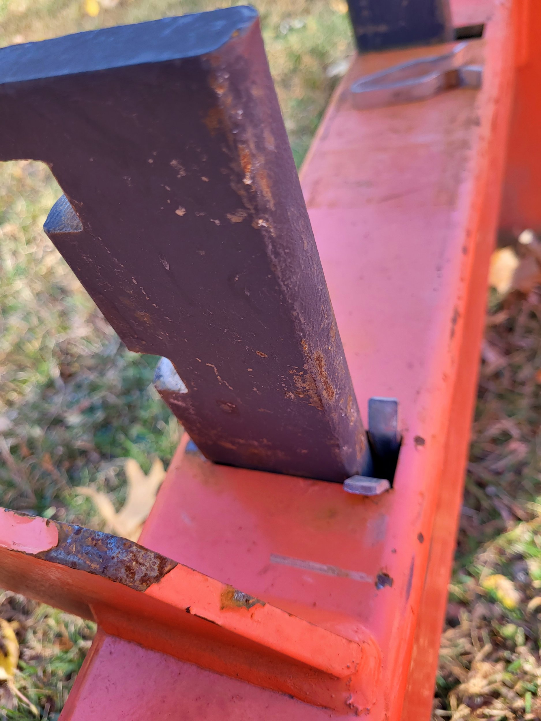

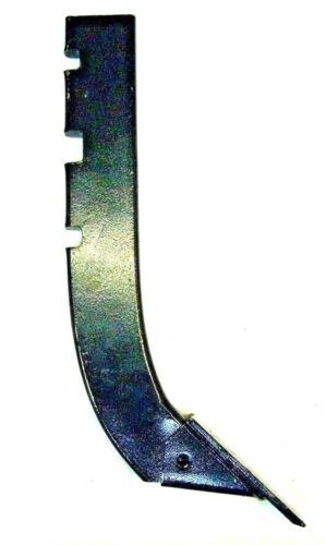

Some brands use gravity to hold the pln:
On this style shank:
/ Box blade brand #10

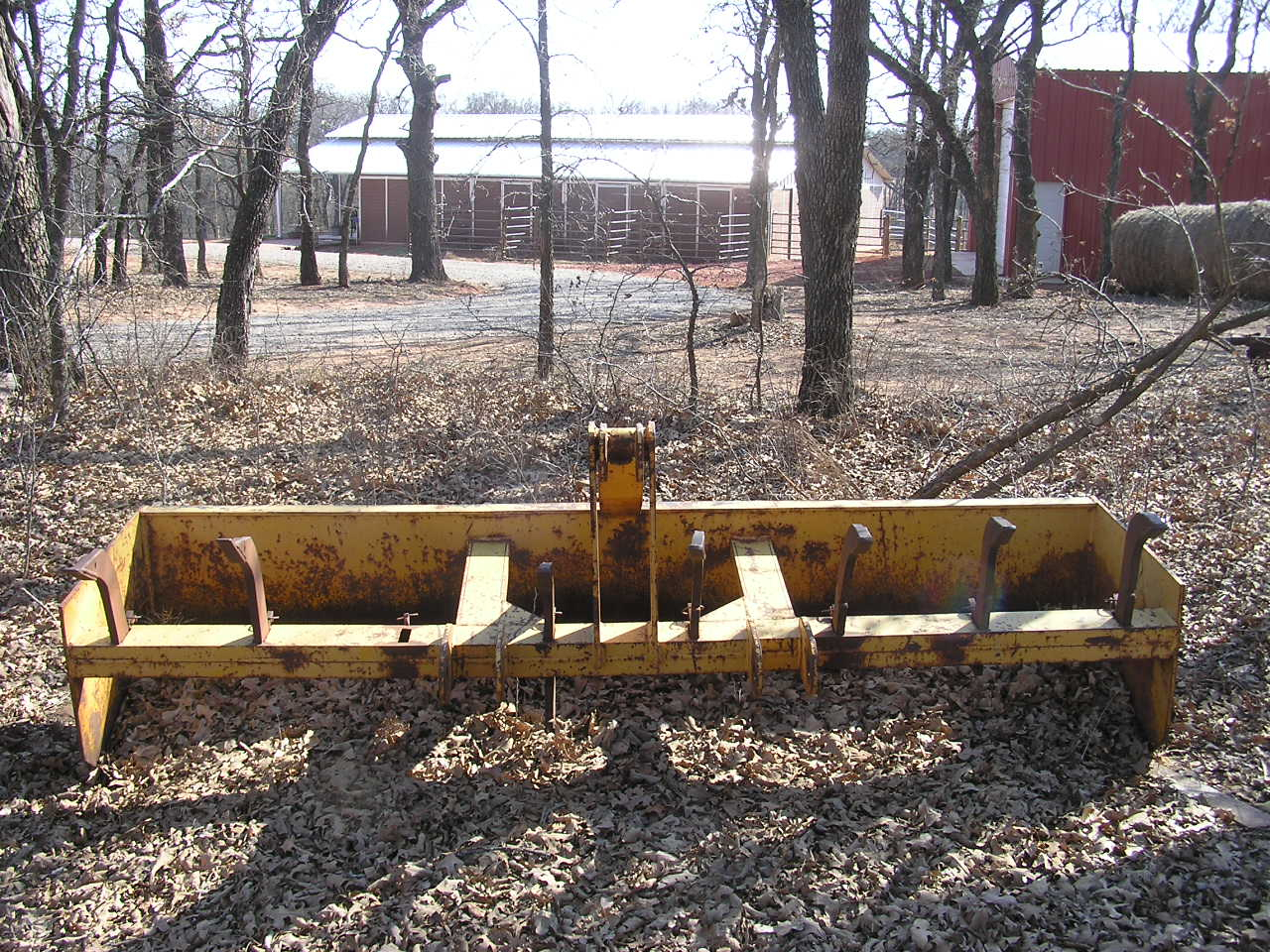

I thought there were spring clips in that style? Those things sticking out diagonally in front of the shanks?
/ Box blade brand #11
Those are the pins.
Some do have spring clips. My 8' does:
/ Box blade brand #12

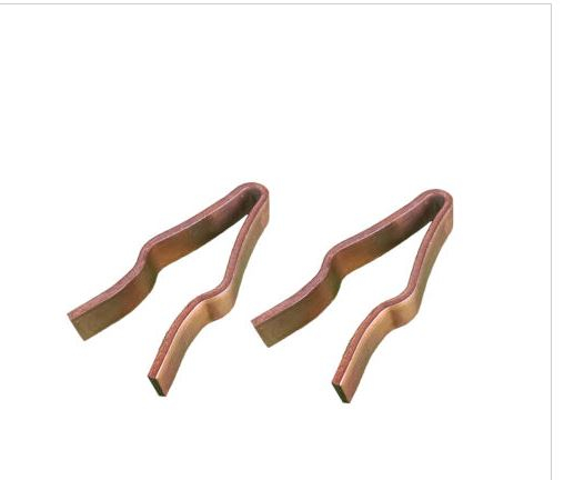

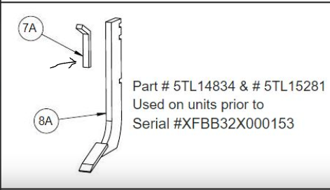

That is a very nice box blade! Certainly not homemade, looks like an older style Gannon or Woods. They use the spring clips to hold the shanks in. You should be able to get them from a local john deere dealer as well, it should be the same shanks and spring clips as a Frontier BB1284
This could get you started:
(EDIT: Removed photo as it was the incorrect style, see post 15)
/ Box blade brand #13

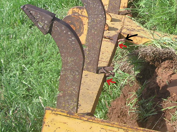

The spring clips on mine are welded on:
The black arrow points to the missing spring ring for the short pin.
You are right, this is the long pin the OP needs:

Another consideration is slot spacing and front or rear slots.
Front slots:
Rear slot:
Also need to measure the openings to see if the top and bottom are the same length:

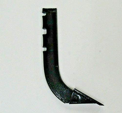

I was mistaken, the photo of the part that I posted is incorrect. I didn't notice this until xfaxman posted. The style you have xfaxman is not the spring clip the op needs, it is different.
This is the style you need... (see pic) and https://www.amazon.com/Gannon-Box-Shank-Spring-Clips/dp/B07KS4DGM7
Note: I wouldn't buy them from amazon, I'd go to the dealer if close by, in case you get the wrong size/style you can easily return them. I'll edit my original post to avoid confusion.

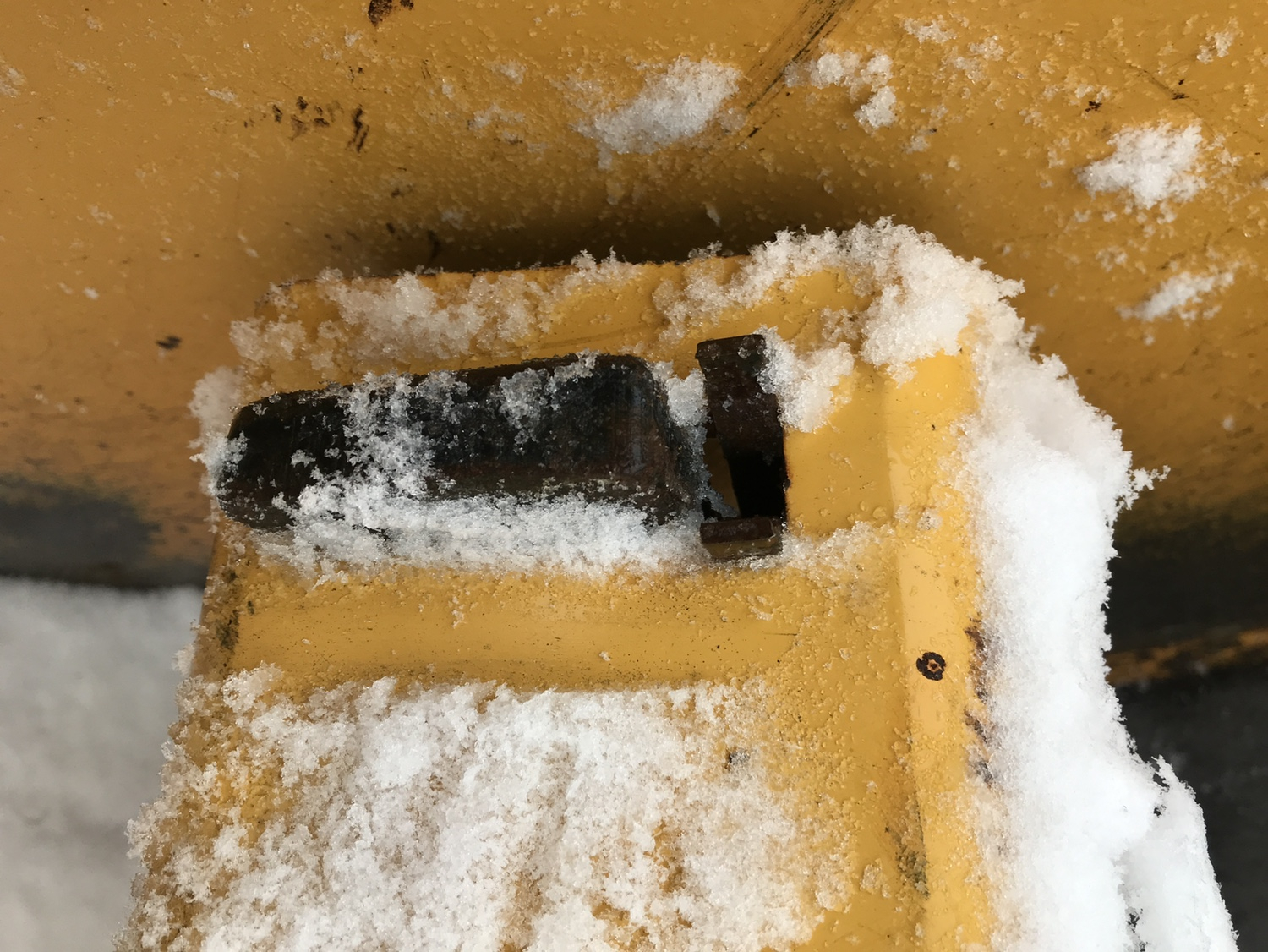

If you zoom in to this photo you can see how the shank looks through the steel, and you might be able to see the spring clip.
/ Box blade brand #17
There are two different styles of spring clips.
Your type works if the top opening in the square tube holder is wider than the bottom opening.
