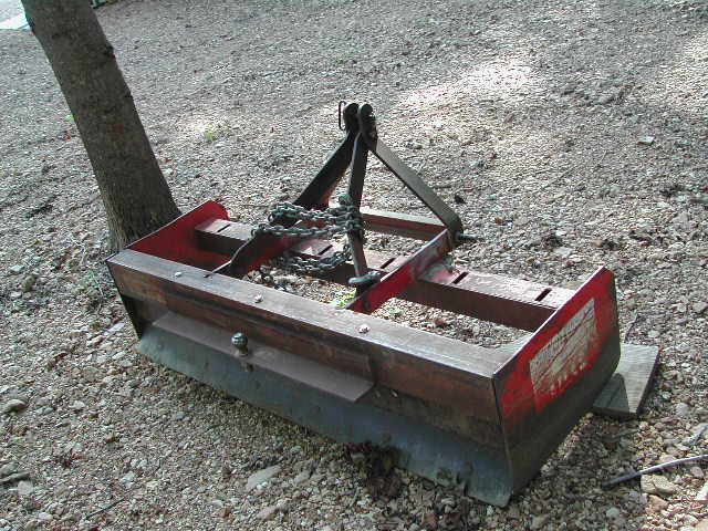

Does anyone have an idea on how to bend back a box blade that is racked out of square about 2 inches? It is a Atlas 5ft blade that I just bought $150 and is only a few years old. Other than being slightly bent in good shape with newish paint:) After I get it back to square I plan on adding a few more pounds of steel to make the heavy duty a true heavy duty. Atlas's idea of HD is not the same as mine:confused:

Picture or 2 would be helpful..maybe light heat or iron fab shop could square.
/ Box Blade Bent
Ok- the results of almost pulling a tree up:confused2: I chained the box blade corner to a tree and took the winch on the truck and pulled it almost back to square. Then cut the lower arm off and did the heat and beat back straight, well almost. I welded some channel iron I had to add strength. Even thu channel has drilled holes in it, its pretty heavy. Its like the lumber racks at Lowes or Home D. Then braced the corners. The corner braces are the only thing that I fell like might come off after I see how they affect the dirt as it fills up while I am using it. The last picture shows the plate stell on the side is still alittle off:mad:

I did the same thing to my 7 foot BB and added the metal to the same places. I though you had taken pics of my blade at first. I havent bent the BB after adding the extra steel. Good job.

Nice Welds! You use a stick or MIG? Mine usually look like I held the stick about three feet over the piece and dripped some slag down.:laughing:
/ Box Blade Bent #6
When I first started welding my buddy would say my welding looked like goose poo by candle light.:laughing: I have gotten a little better.
/ Box Blade Bent
Thanks- started years ago with a AC welder on 1in square tubing making deer stands- wow that will teach you how to burn holes real quick. I have a MIG now and use it on almost everything. Only break the stick out when I cant get to the joint with the mig gun or its to rusty and I dont want to grind it.
