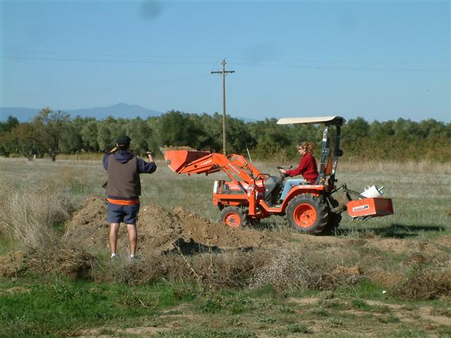

I need to add some weight, maybe around 200 lbs or so) onto the back of my 6' box blade. My L2501 won't have any trouble with it. When the driveway is a little dry and I need to scrape it, it won't dig in very well. I also scrape my oldest son's drive across from me and he stands on the back and it cuts well into red clay, even when dry. When I do mine by my self, is when I need the extra weight. If it's wet, no problem. The red head complains if it gets a little rough so you know what that means....it's gonna get fixed. I drive a truck so it doesn't bother me. She drives her VW and it will bounce around a little. :laughing:
Any help on this? I figured some of you smart fellows have already addressed this. Thanks.

On my 6' box blade I was able to put a weight lifting bar across it with all the weight I could fit on it. I put the big cast iron weights on and also a set of the plastic covered ones. They were laying around anyway and it worked quite well. They can be bought cheap from old guys who are past that phase.

I just used a concrete-filled 5-gallon plastic bucket to add weight to the 4-ft wide box blade on my 2005 Kubota B7510HST. Weight about 100 lb.

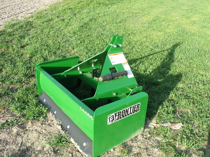

Is there any trouble getting them to stay on? i have tried concrete blocks and they shift around and get busted sometimes.
No. Except for once when I was really bouncing along one side fell off.
The frame on my Frontier allows the weights to sit in a pocket between the frame ends and the bar goes from side to side and just lays in on top of the side ends and the center framing..
