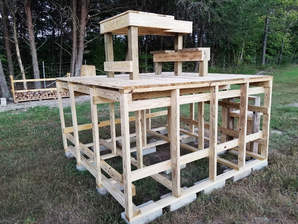

Had an example yesterday - I was lifting one side of this platform up a little to put it up on cap blocks. No idea what it weighs, but not insane weight, and I was only tilting it up, not lifting entire thing off ground. Shooting bench wasn't up there at the time either. But pallet forks that high, weight 1/3 distance from tips, and was really surprised when the arse end got real light on me - was not expecting that at all.
