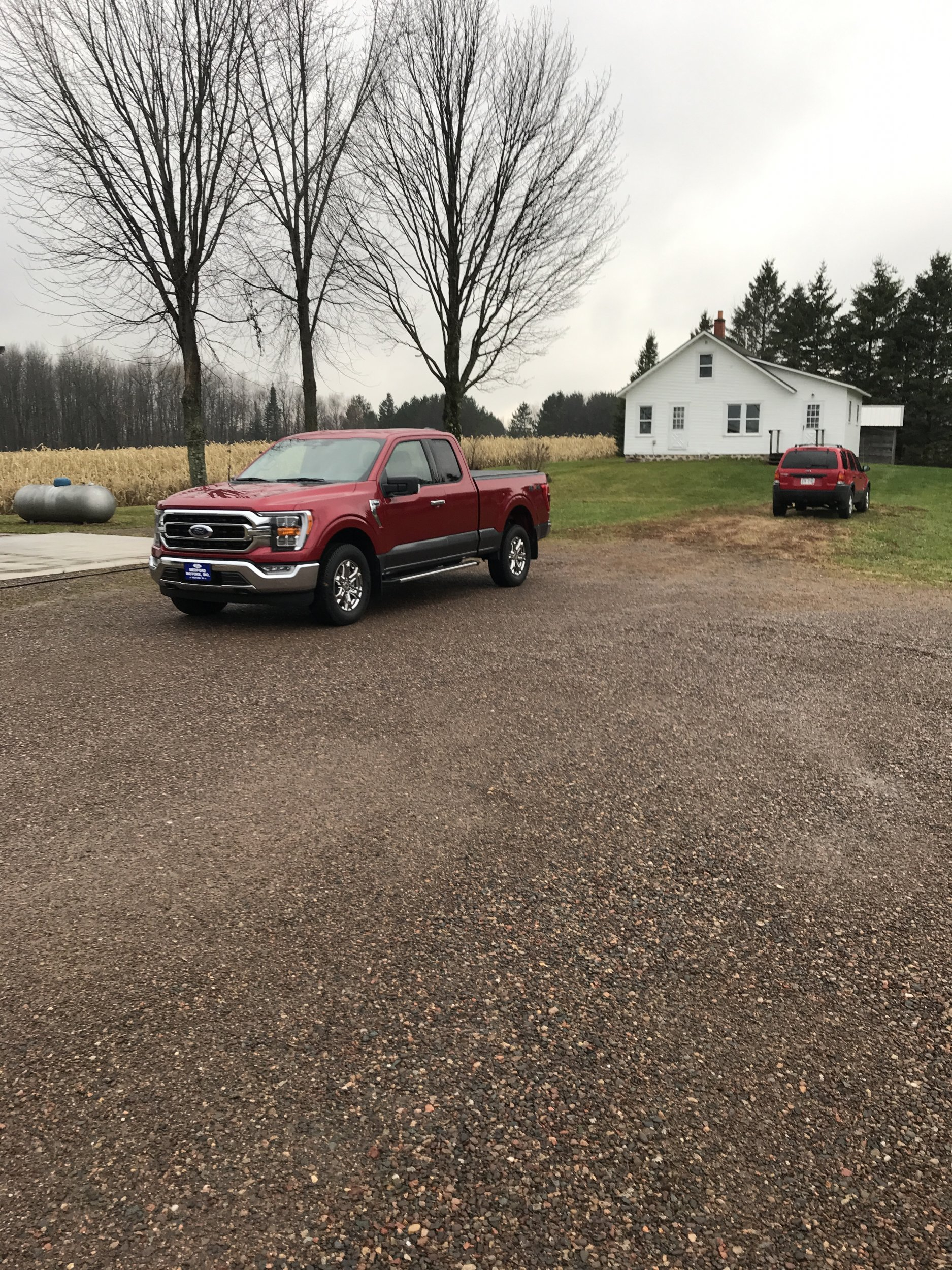

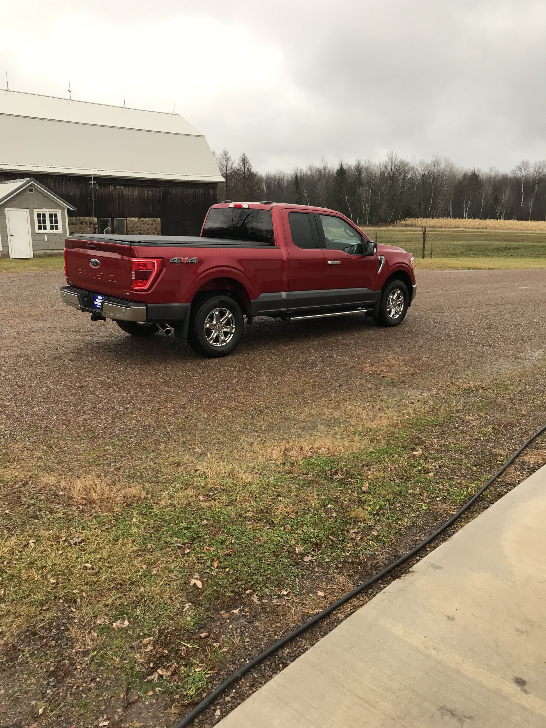

Brought the new F150 home Wednesday, decided not to have it undercoated. Other than the crazy high price I’m pretty happy with it, never owned such a high tech vehicle before so it’s going to take awhile to get used to using all those controls.
A couple pictures
I'm a sucker for two-tone trucks, looks great! Good pick!
