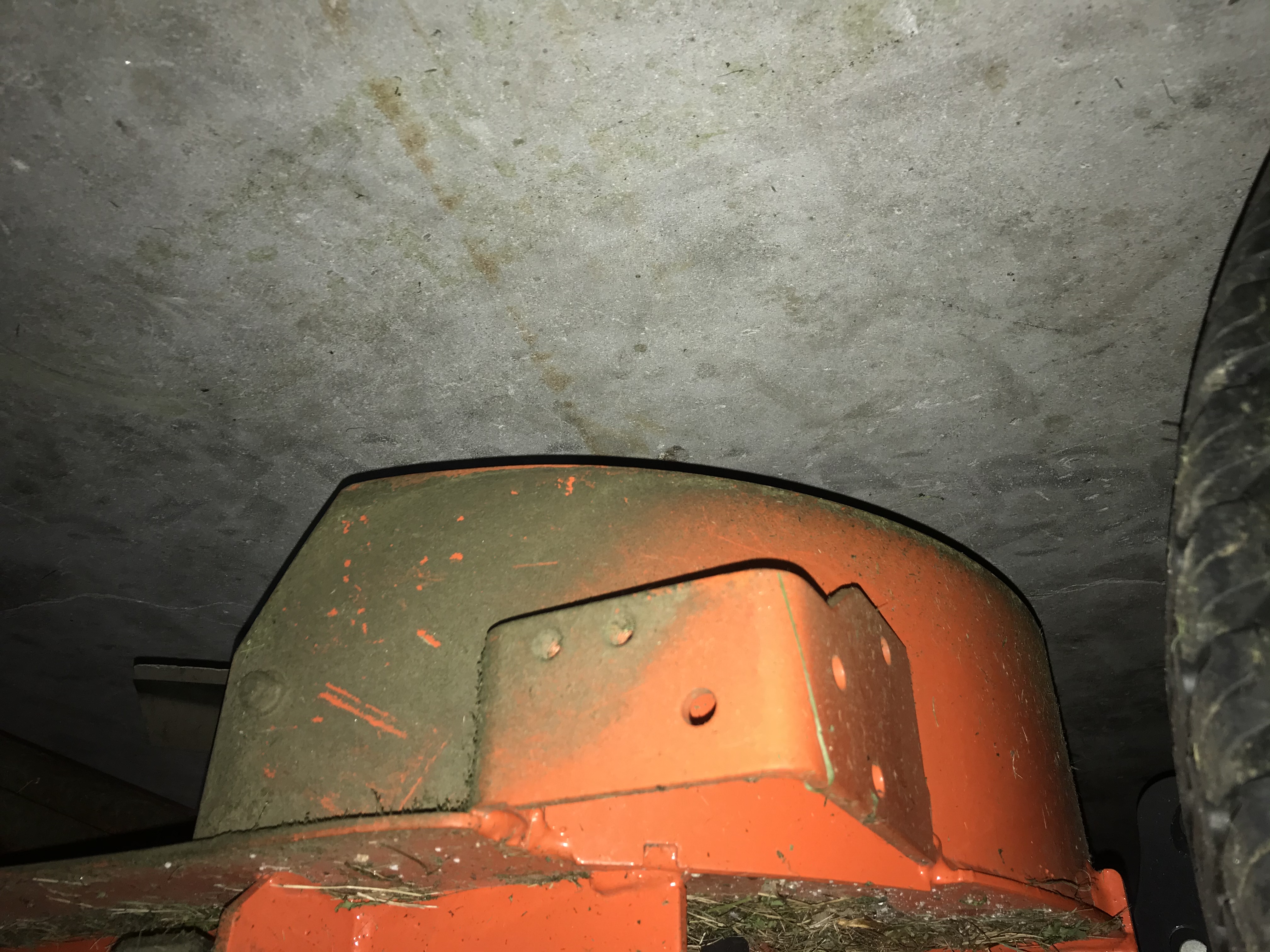

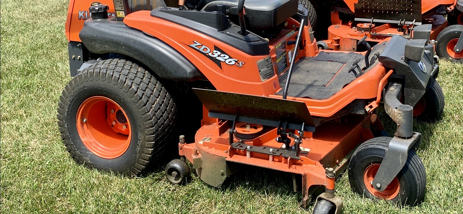

I assumed you meant your 60 deck did not have rear anti scalp wheels at all, and saw photos of other new 60 decks that were the same. My older zd326 has rear anti scalp deck wheels. Do you want a photo of that?
If you have a left rear wheel, there should certainly be one on the right.
Yes a photo would be helpful.
There is one on left rear but not on right rear.
Thanks 90cummins
   / Bought a new ZD1211 #12
Thanks 90cummins
Here you go...
