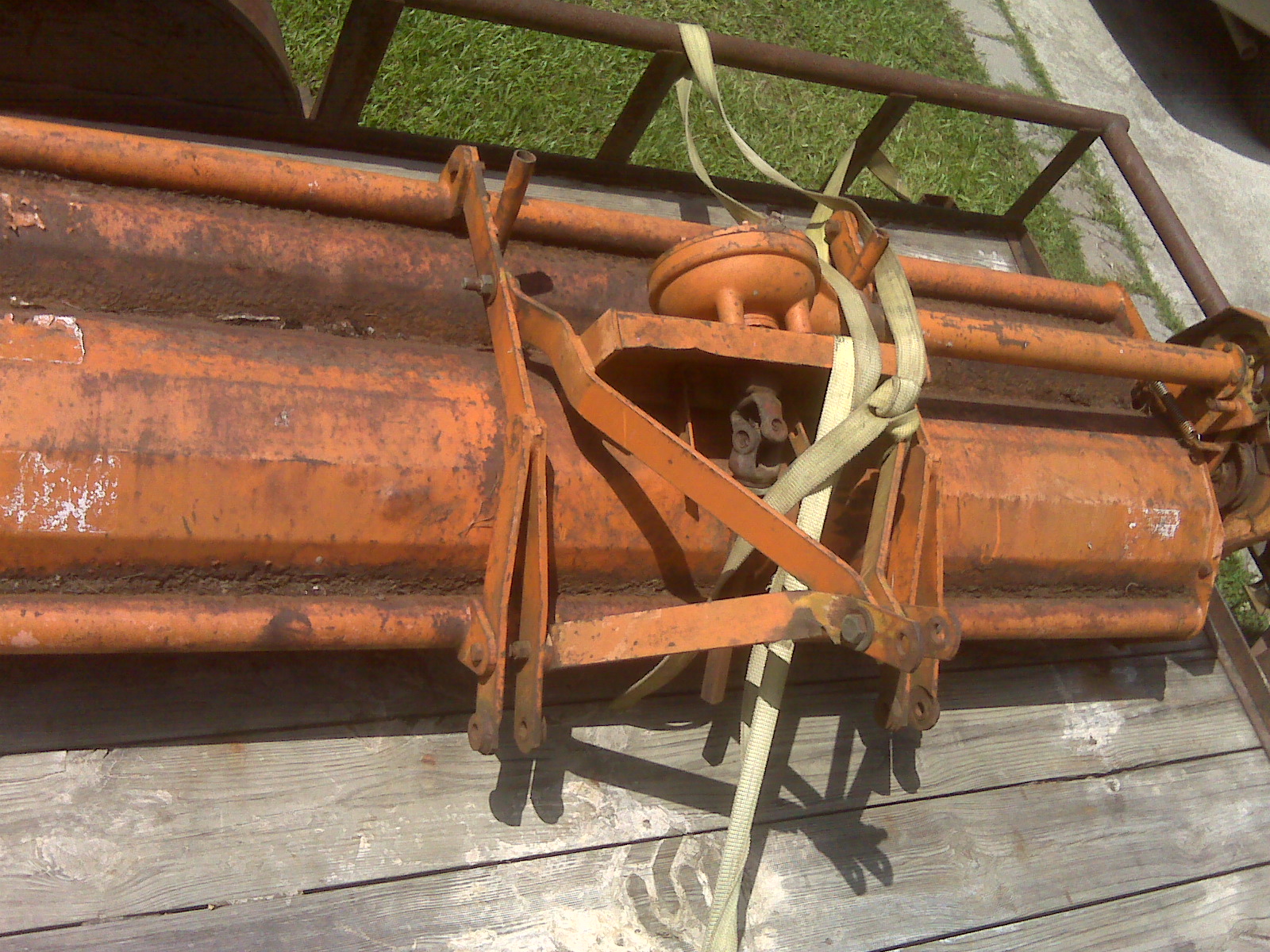

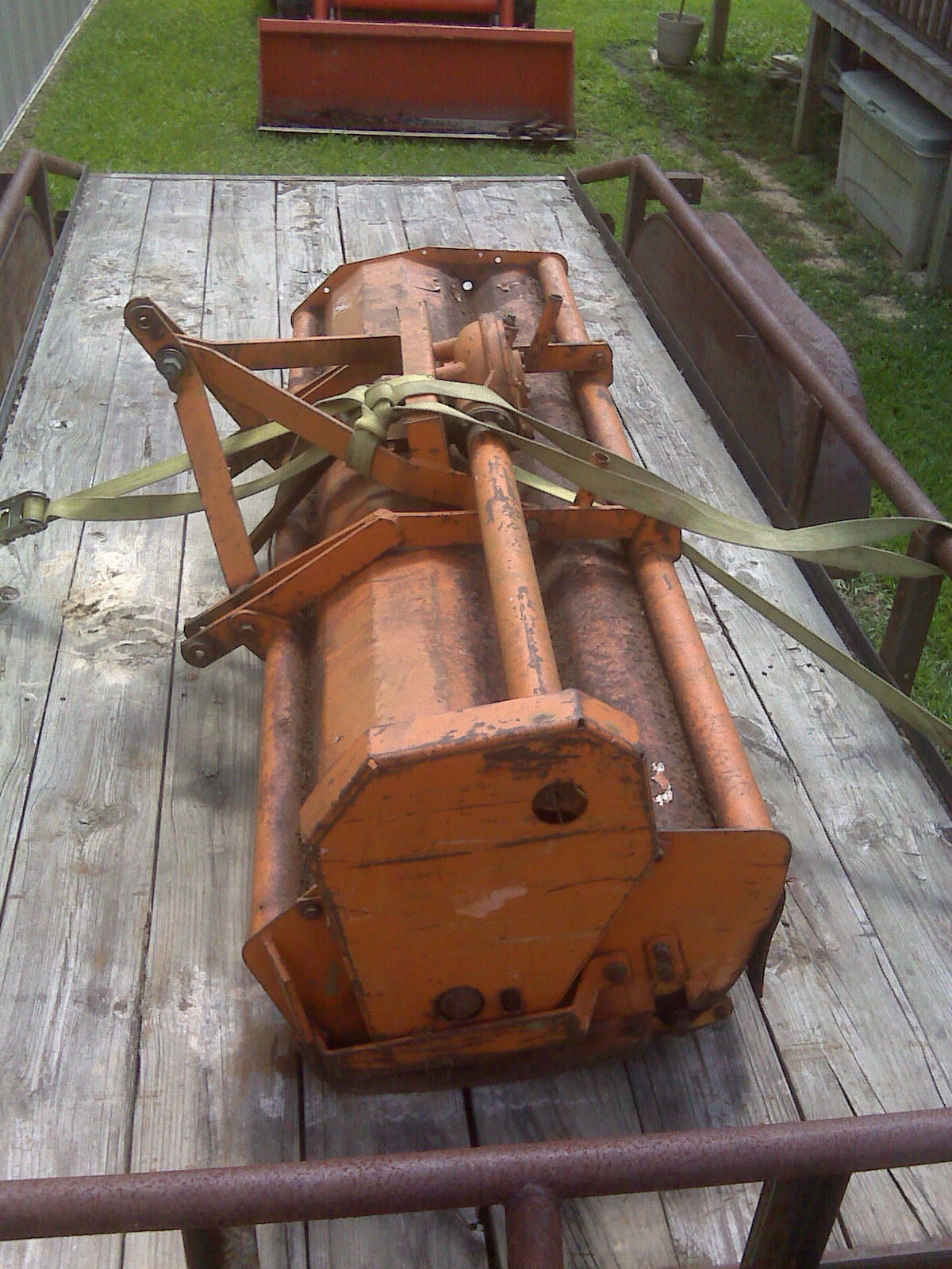

I bought a used flail mower this past weekend. It's a Mott Model 88 Utility. It's in pretty good shape. I gave $700 for it. All but one bearing feel smooth with no play. The bad bearing is the one on the end of the extension shaft at the drive pulley. The housing for that pulley is broken as well. Everything turns freely. It has some rust on top where grass/straw/debris was left sitting, but it's still structurally sound. I've already placed an order with flailmaster for the new housing/bearing assembly, as well as a belt & new blades.

Nice, I'm sure you'll get some good use out of it. can't beat the price
