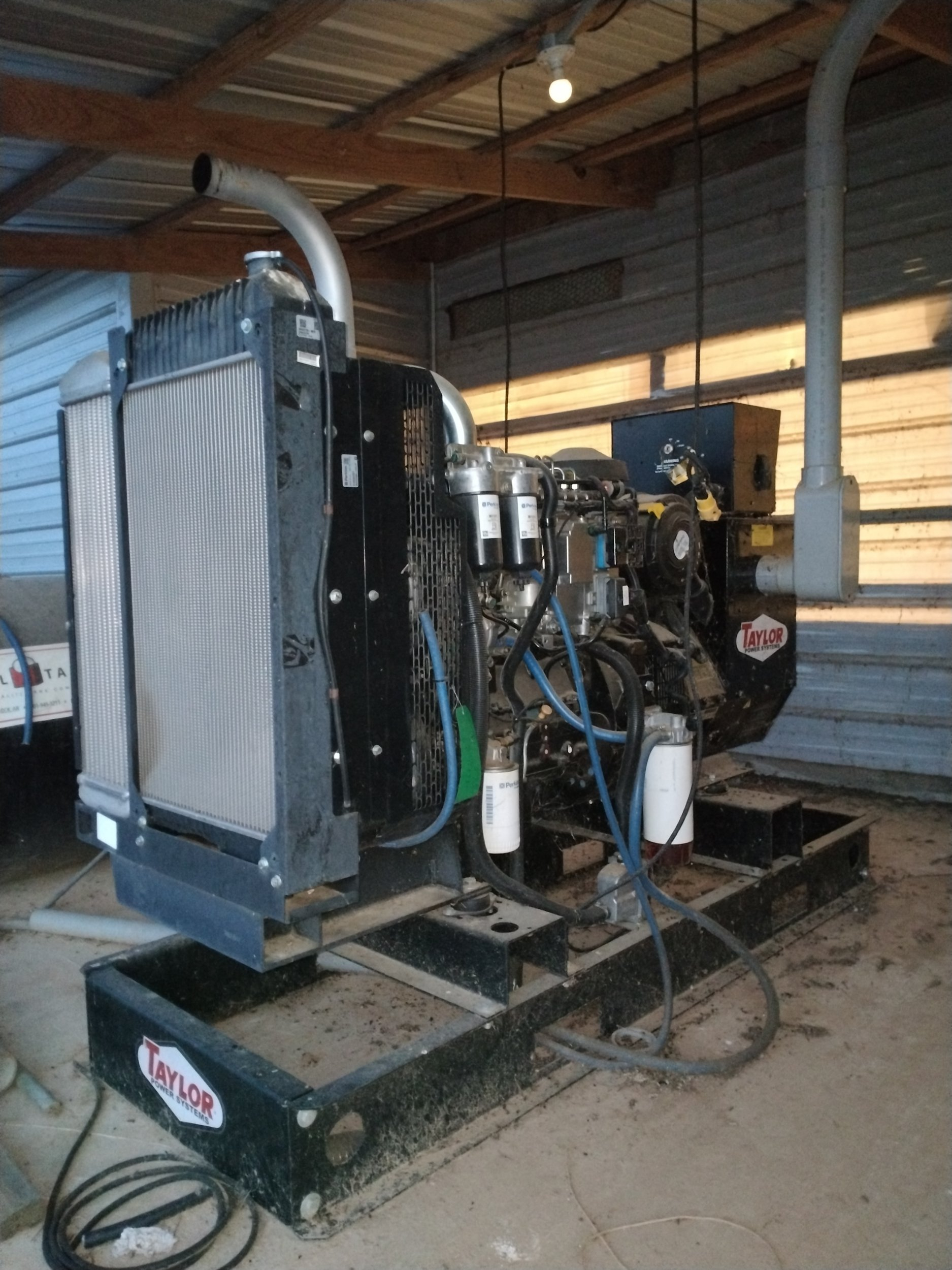

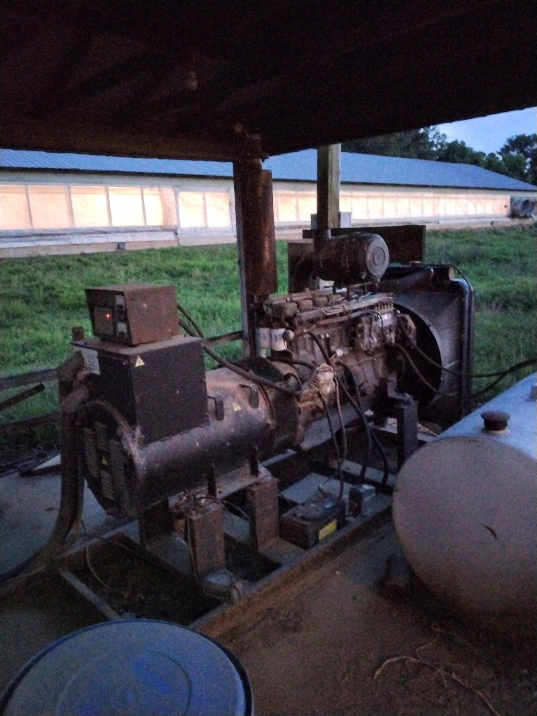

I have a 60,000 watt here with less than 8 hrs on it. Allis Chalmers six cylinder. I would like to sell it. 5 k sounds fair. I'm thinking this one does single and three phase. If the oilfield was still rocking I'd keep it.
I have a 25,000 watt pto generator that was run along with it for the same 8 hrs. I figure 2500 for it.
One day the power was off 4 hrs at the farm and another day 3 hrs. Now we have 125, 000 watt generator on each set of two houses. We kept the two old generators just in case until we bought real ones with automatic transfer switches. Comes on and runs once a week. Calls your cell phone if any trouble.
