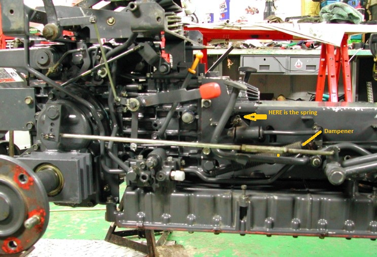

Great advice from all, I took a look at the pedal this morning before heading to work and it seems to move freely, but just kind of lazy. In addition to the spring, is there a damper on the linkage? The movement of the pedal feels like it's moving through a thick fluid (molasses?). Smooth, but not in any hurry. I'll have to get in there next weekend and see what the deal is.
I'll post some photos soon.
   / Bought a B21, have a few questions #7
Smooth like thick molasses is exactly like mine works but it returns to neutral quickly. The dampener as Kubota calls is is P/N 32721-43350 and if you search on TBN you will find other threads about this topic for other models.
The B21 per the manual doesnt have a spring that I can see, only the dampener and looking at mine it is as the manual picture on page 174 of the B21 Manual.

Yes - you are right there is a spring inside the frame that appears to be a bear to get at. Attached are the pics you posted - and an updated word doc showing the spring. I went out and looked at mine and could see the spring inside the frame. When I moved the hydro pedal it didnt move but assume it must be a tension spring.
The dampener is shown too. Is ths internal spring what you refer and not the dampener?
