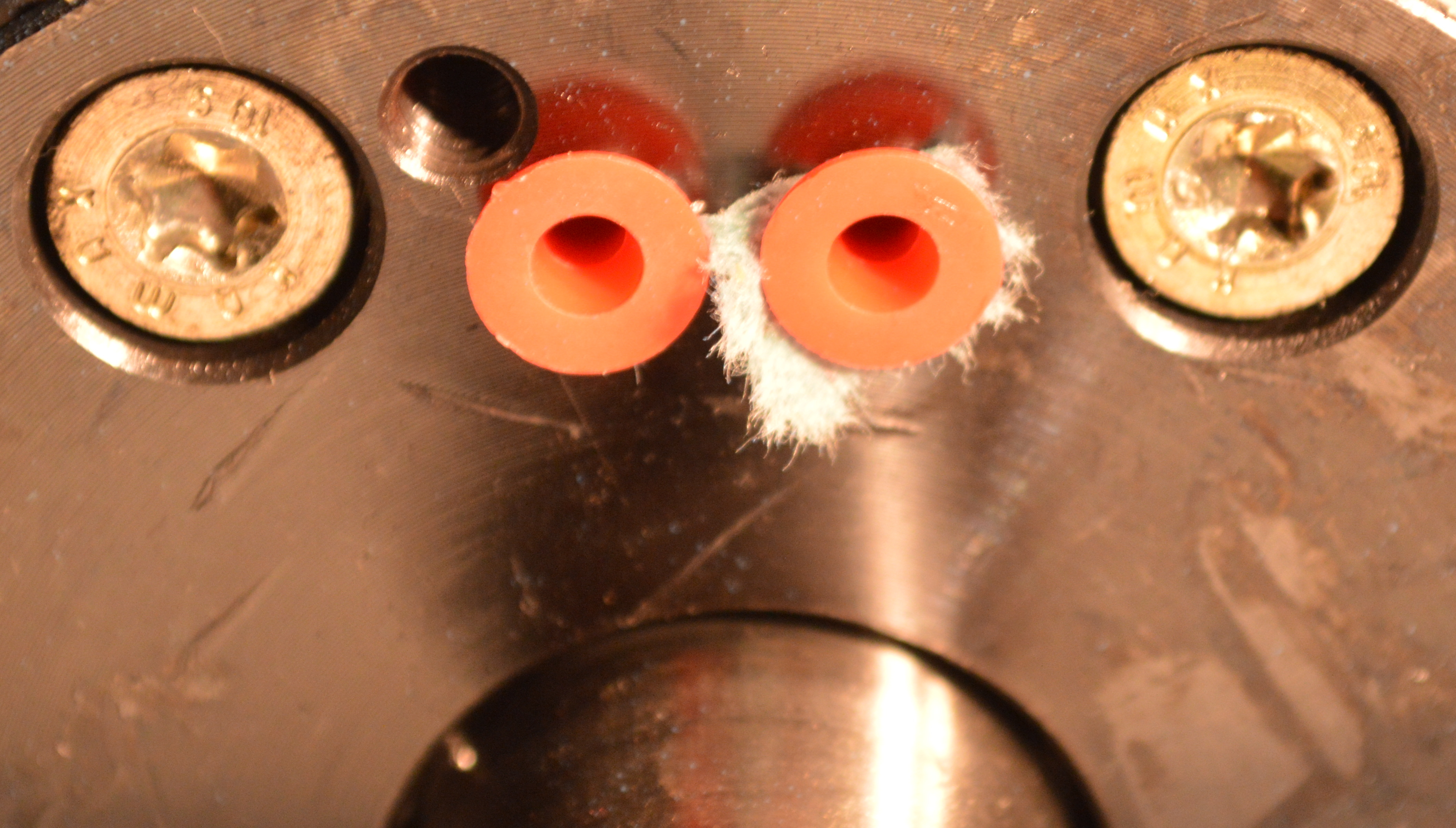

I pulled this pump offa the ram truck engine I'm rebuilding. The pro shop did not overhaul it per-se but 'looked at it' and it so happens claimed to have 'fixed a minor snag'. I'm in the process of cleaning it up before returning it to the parent engine and noticed that they left two little plugs in two little holes on the face just above the conical gear shaft.
What are these holes for? I figure I should remove the plugs but there may be a proper time to do so and a wrong time. I haven't been able to find a service type manual that explains the pump in detail (what does what, how, when, why sort of thing with illustrations).
/ Bosch P7100 injection pump #2
YES.. REMOVE THE PLUGS..
THOSE are the oil drain plugs back to the engine..
They put them in there to keep the excess oil from dripping all over you & your car..
They are JUST FOR travel.. NOT installation.

I was afraid so, seeing that the shaft is not keyed I would have put them under it.

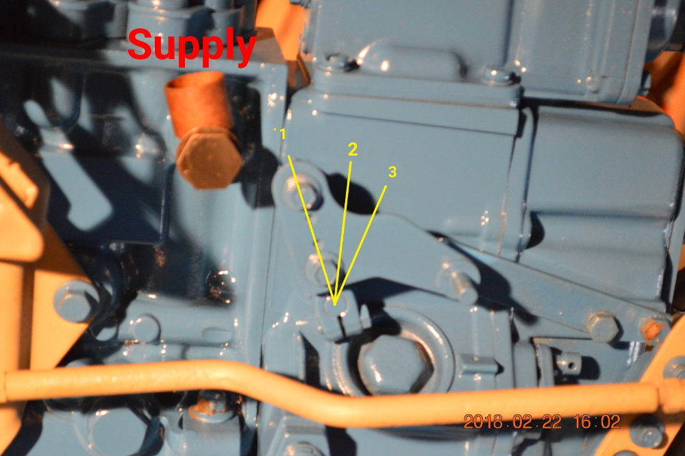

On the fuel "Supply" banjo there's a cardboardish paper sleeve, what's its purpose and where does it go?
2
What does the #1 "start" position do, just flood with loads of extra fuel?
3
The shutdown lever is mechanically sprung OUT of shutdown position #3. I presume the truck solenoid has 2 coils one of which holds the #2 "run" position, both of them pull all the way to #1 "start", but what forces the lever to the #3 "shutdown" position? Are both solenoid coils momentarily reversed and powered?

. same as the plugs by the camshaft, just wider.. throw away..
There are ONLY 2 positions on the shut off.. run & shut down..
I don't know where your getting your information from.. but only 2.
The shut off solenoid is spring loaded to the shut off position.. so when power is cut, it springs to shut off..
Yes, the solenoid has 2 circuits.. PULL & HOLD.. On starting[pull] it has a VERY heavy amp draw & then switches to low[hold] AFTER starting..

It's more like a paper sleeve, there to protect the banjo I guess?
The spring-loaded shutoff position is straight forward, but when you come out of that to the detent then the lever can still move more in the same direction. I guess once it's open it's open.
