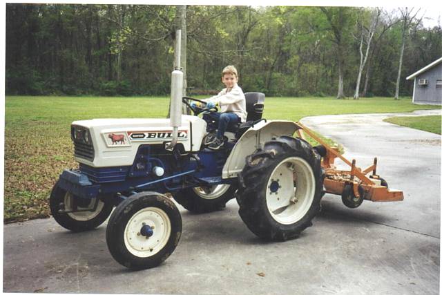

Thanks everyone for the input. Lots of good info here and sounds like both units are excellent. As for the 30+ HP, I live on the Gulf Coast and finish mow 6 acres. The grass grows really fast here and if not cut every 7 days max gets totally out of control. We get lots of rain too! 60+ inches per year. This means the grass does get really thick. I have a 25HP Mitsubishi Bull (21HP PTO) I bought new in 1981 and have decided to sell it /w3tcompact/icons/frown.gif and get a new tractor /w3tcompact/icons/smile.gif. I thought I should get the new one with a little more umph... I have a six foot Woods finish mower RM-660 and it really taxes the Bull when grass is tall or damp. I really need to get to dealers and drive new tractors to compare size and power to what I have now. All Kubota and NH dealers are closed on Saturdays here. I don't understand how they can afford to do that. What else are Saturdays good for if not spending money? That's my Grandson sitting on the Bull. (The key was in my pocket).
   / Boomer TC-33 Kubota L-3010 #9
Here's the attachment. Thought I included it with my previous post.
