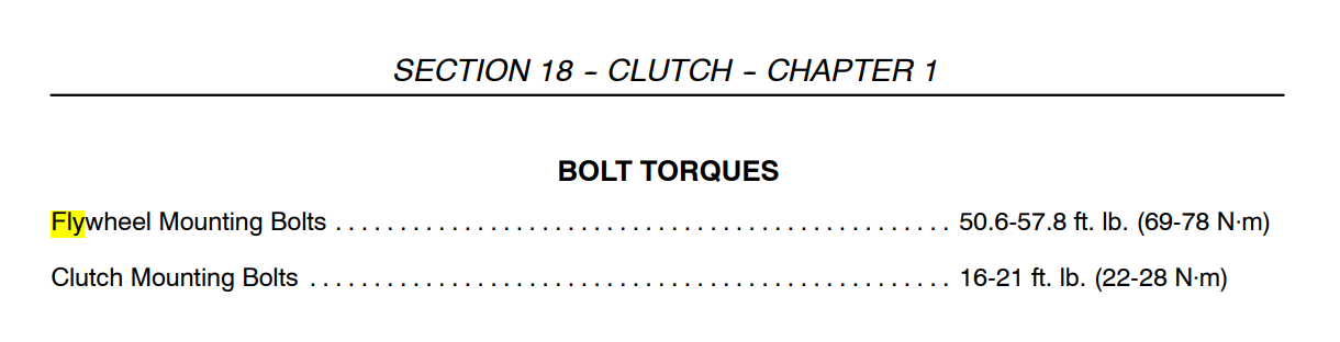

Tracnun you can verify the diameter and grade of the bolts,then lookup on the web “bolt torque chart”. This has helped me when torque values are not listed in the manuals.
   / Boomer 40 flywheel torque value ? #4
Sorry my reply was for TC40, not a Boomer 40
thanks, i had those resources as well, i finally went 60 foot lbs, hope that will be ok, one post somewhere said 150 and i was like lol no way
