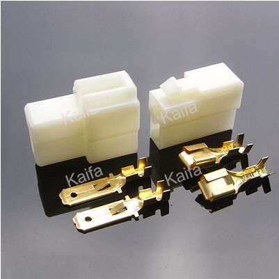

I "think" I found it under the plate covering the hydraulic lift/lower lever on the right side of the driver seat. The wire bundle going to the rear lights comes out from there
also. Is there a name for this type of connector?
   / Boomer 35 worklight install
#9
The plug under the hydraulic lift lever plate where the rear light wiring bundle comes out from a rubber grommet plug has this rectangular white plug with 2 flat connectors on it with each in different directions ie: one is --, the other | if you know what I mean. I have a query into my local NH dealer to get more info/exact info on where the work light connector is supposed to be. Will update the thread if they respond with anything useful.
Here is an image of what the plug/connector looks like:
   / Boomer 35 worklight install #10
Might this be it ? 18 JUMPER,765mm L JUMPER, Worklight 84360959 $32.08
