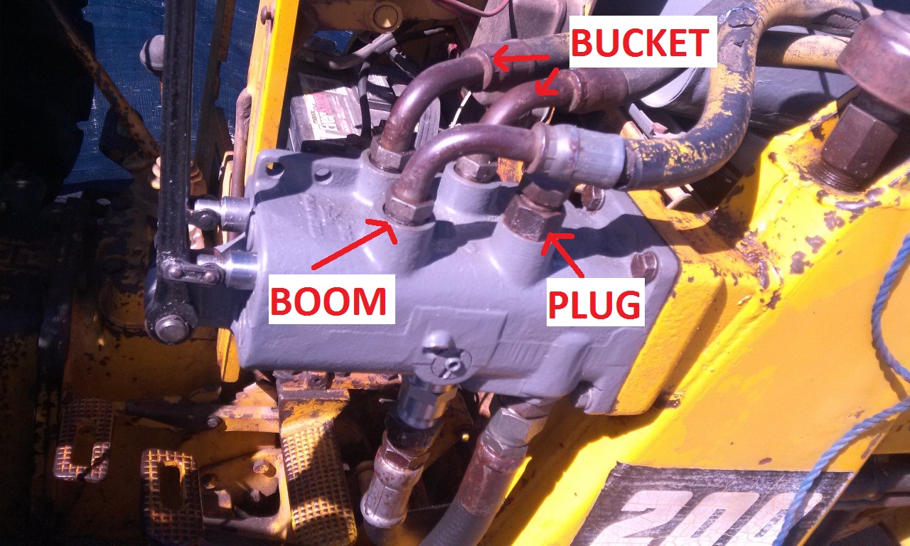

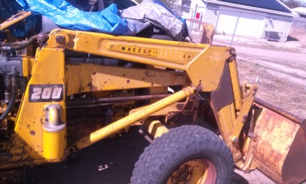

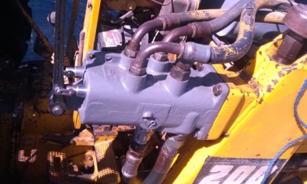

I have a beat up MF3165 with a MF200 front end loader. The bucket will go up and down, but the boom will not lift at all. I changed the hydraulic fluid and filter. I took apart the control valve, and it was pretty beat up. I did what I could to clean it out. The boom still won't lift at all.
Any suggestions for troubleshooting?
Thanks!

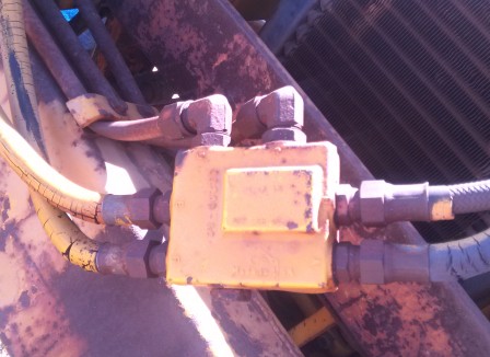

How long since hyd filter in RH photo has been changed? Checking pressure is a good idea. I'd guess pressure needs to be in the 2000-2500 psi range
/ Boom wont raise on Front End Loader
Thank you again for the replies.
I just replaced the filter and hydraulic oil.
/ Boom wont raise on Front End Loader #7
Since there is only one line connected to the valve, is that is going to the bottom of the boom cylinders to raise the boom. Could a previous own have broken a hose and just plugged the return line on the valve and the cylinders? That would let the boom rise under power and lower with gravity for a while until internal leakage in the cylinder filled the return side with oil. Check the cylinder for plugs in the return ports. They may be at the end of the rods.

Thank you very much for your suggestion! The top of the cylinders (end of rods) are being fed by the line coming out of the top of the control valve. The bottom of the cylinders are connected by a line that runs directly between them. Does that mean the all of the power is pushing the boom down, but there's no power to push it up?
/ Boom wont raise on Front End Loader #9
That would be my guess.
Is there a tee with a capped port in the line between the bottoms of the two cylinders? I suspect that line on the bottom is supposed to be piped to the plugged port on the valve.

I didn't see any quick connections, but it looks like someone may have added additional lines and splits. I'm not sure if they are supposed to be there or if they were used to connect to another piece of equipment. Here are diagrams of how the lines are routed. (lines to the bucket not included)
Thanks again for the responses. I'm lost without them!
/ Boom wont raise on Front End Loader #12
I don't see how the cylinders can work piped as you have drawn. I still think plugged port on the valve needs to go to the bottom of the cylinders.

It won't work like you have it draw. There should be 2 lines ( with a T providing flow to both cylinders ) coming out of the valve and running to opposite ends of the cylinder. It takes 4 lines coming out of the value to make a FEL work. One line to lift, one line to provide power down, one line to curl the bucket up, and one line to curl the bucket down.
/ Boom wont raise on Front End Loader #15
Agree with what has been mentioned. IT wont work as is. Those are double acting cylinders, designed to be power in both directions.....and use that capped port at the valve.
Even in a pinch, if someone wanted to make it power up and gravity down.......they did it wrong. The hose going from the valve to the cylinders should have gone to the base end of the cylinders, and the rod side should have had the hoses removed and a breather vent installed.
