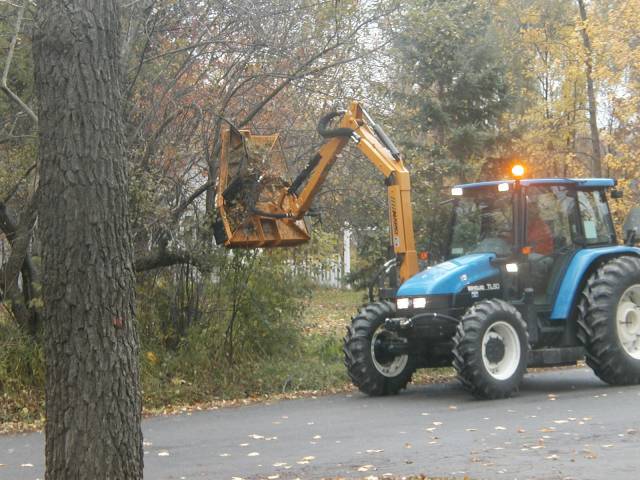

That is just to SMART: /forums/images/graemlins/smile.gif Very nice job, i can use something like that along my 600ft of ditches, i often dreamed of something like that when every fall i see the town come thr with their big one to clean the road sides of shrubs and undergrowth.

Several years ago the state had something like this mounted to a road grader instead of a tractor. They only used it one time on my St. Rt highway and I never saw it again anywhere.
It was wicked and threw pices of the cuttings clear into the side of my house which is about 100 feet from the road.
That is probably why they never used it again- to dangerous and damaging.
Have you ever seen the giant machine that has a long arm with about seven 16 to 24 inch circular saw blades attached to it.
This thing will reach tree limbs that are above the wires on electric poles.
This is what the state used a few years back to trim trees and brush along my road. Quite a monster machine.
My Elect. Co. uses a same type set up except the arm with the saws hangs down from the bottom of a helicopter.
They use it for trimming trees along their right of ways.
