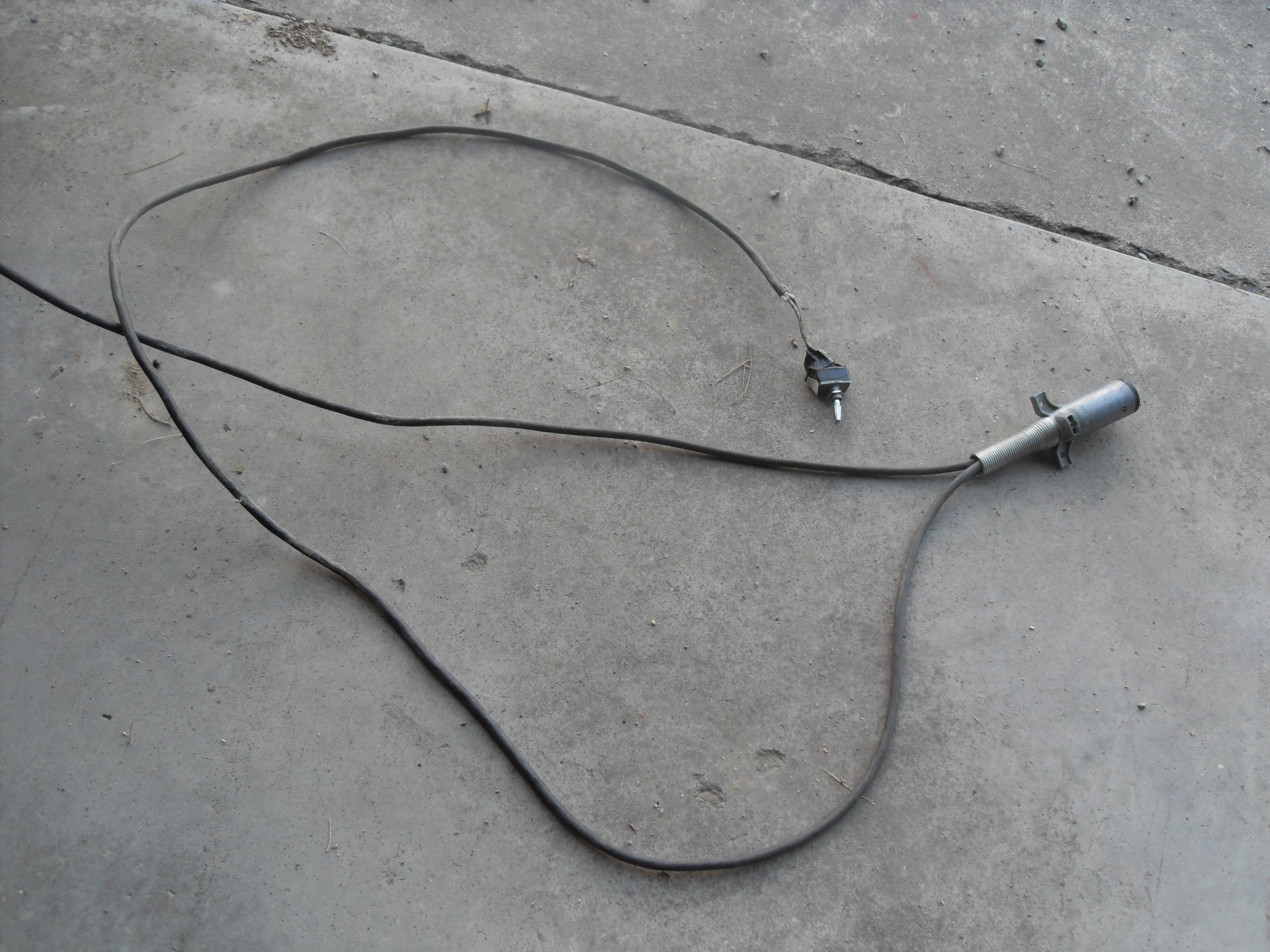

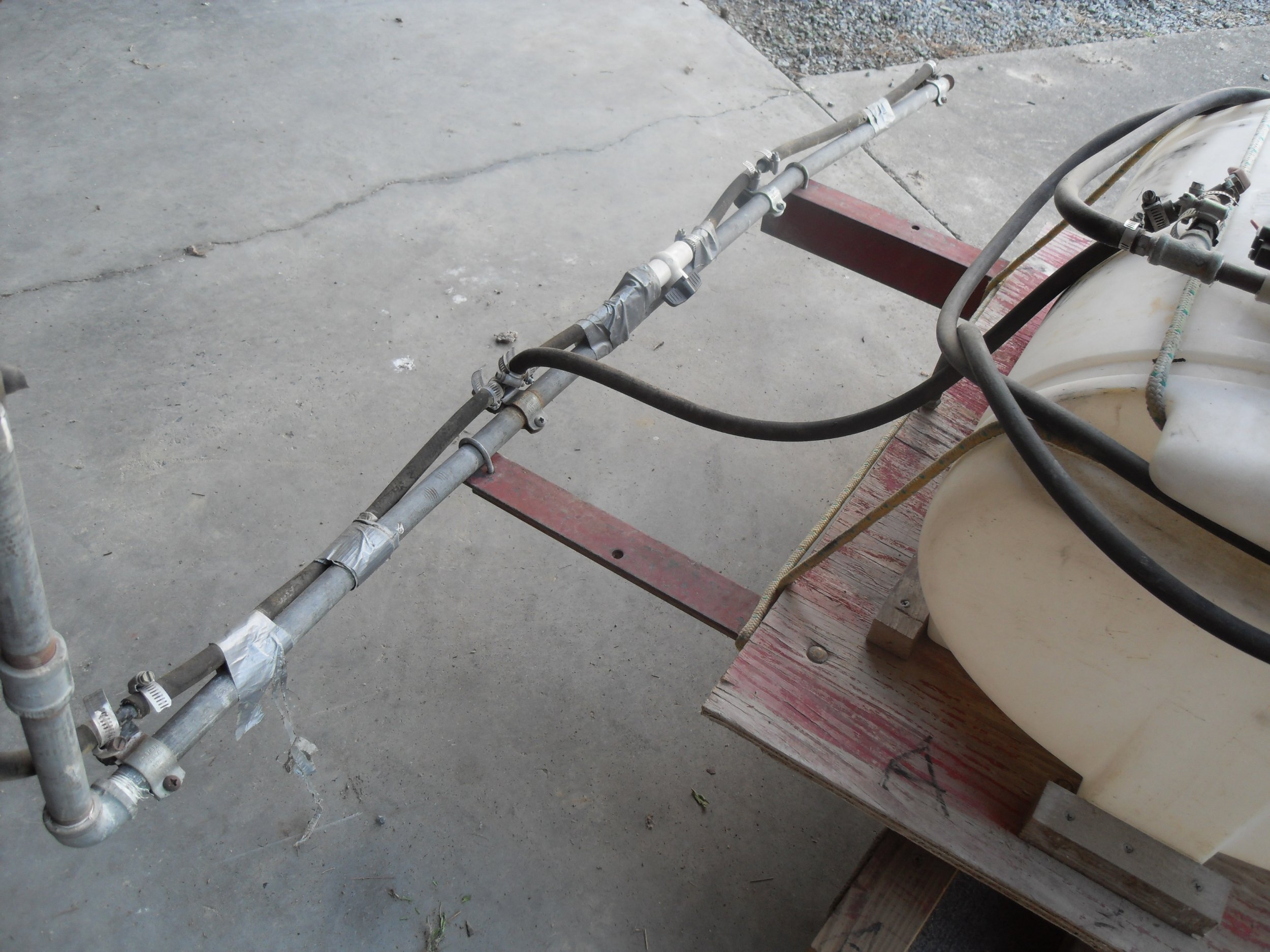

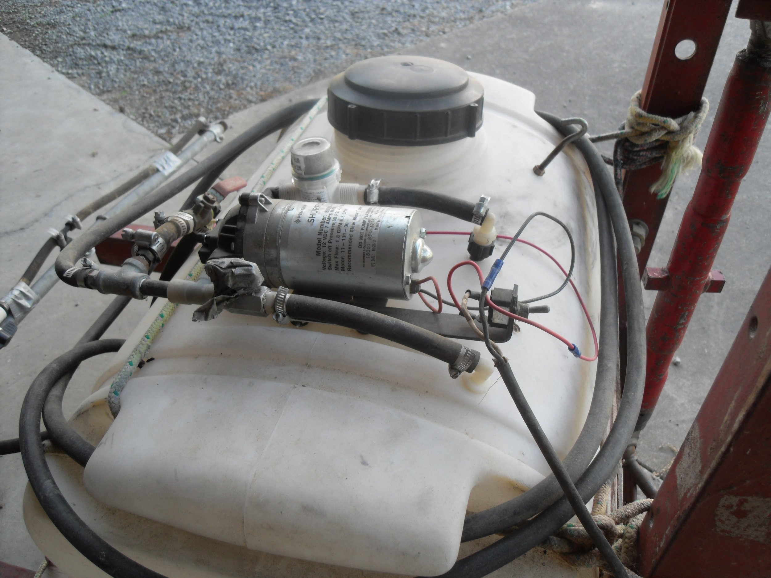

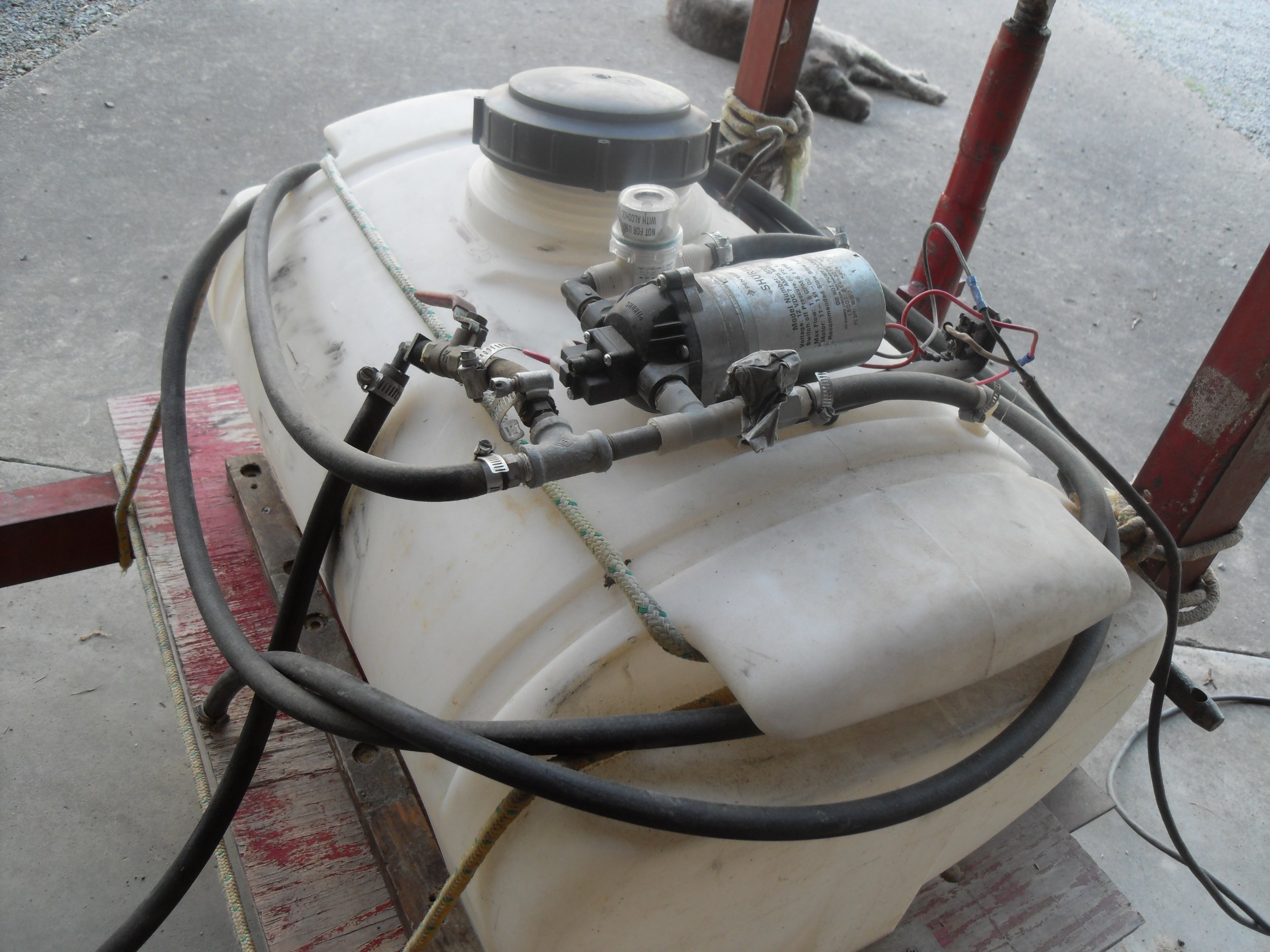

"hire someone with experience to set this up for you" would do that gladly. I must say, I am a quick learner and with information from this forum I am better informed. I do not have an atv, just a tractor.
Steve, attached are pictures of my current spray system.

Fimco makes a 3 pt hitch 45 or 60 gallon spray unit with a folding boom and 12 volt pump,

Thanks for the pics, if we continue I'll need a few more; but first -
JAXS makes a very valid point about cutting out (or better, SHARING with) the middle man - one example might be thinking that 12 volts isn't enough to hurt you - while it's true that MOST people might only feel a slight tingle touching 12 volts AND ground, if you accidentally touch 2 adjacent terminals with the same probe, you just created a dead short - under THOSE conditions, the metal part that's causing the short will become RED HOT in 'way less than a SECOND.
This is because a decent battery that's shorted out will easily put out several HUNDRED amps of current (think "arc welder") - I've known a few mecanics who found out the HARD way why you shouldn't work on electrical stuff wearing your wedding ring, or grab a wrench with bare hands after dropping it across battery terminals, etc -
Don't get me wrong, I'm too stubborn an old SOB to give up; but I do think you need to pick the LEAST un-informed (electrically) friend you have and get them involved before continuing.
The courses I used to teach in the military were typically 20 weeks long, with the first 6 weeks devoted to basic circuitry and component identification - if you passed that phase, the entire REST of the course was classified top secret/crypto (the highest classification in the military) - if you hadn't been vetted for that classification then you better be able to either drive a truck or cook - no exceptions -
I only bring that up 'cause either you and/or your helper need to understand basic circuits or this is gonna be one of the longest threads ever (see previous part about "too stubborn an old SOB to give up")
