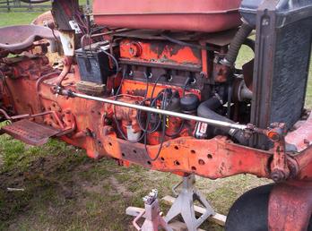

Looks fine to me. I sometimes build vs buying.. either just because.. or 'need it now'.
While I could have bought a steering draglink for my 951 I am working on.. I opted to weld one up.. here is before / after.

Looks good, wondered what could cause the bend like that in the first place. Did the front fell in to the hole and the draglink took the fall on something?
JC,
/ boom pole #9
Dunno.. happend before i owned it.
System used to have power steering.. but pump and cyl were removed, and the old actuator rod fo rthe steering vslve was crudely welde dtot he front support wher ethe cyl whould have bolted to, and to the draglink/tie rod. I 'almost' thinkt he prev owner bent the rod to make it fit, as it would be too long to use welded straight... I whish he would have simply cut the 'long' end off and made it look half way decent.. then i wouldn't have had to further dink with it. but who knows.. it might a hit a treelimb /stump or something?
