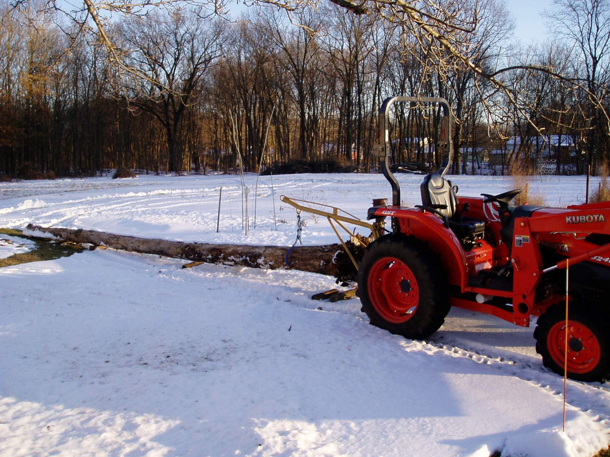

I think they like to lift the front end of the log so it skids/ slides rather than digging in as you drag it. (haven't tried it myself)
Exactly! Keeps the butt from digging in and keeps the grit off the log. When I did this I also ran a chain from the drawbar to the log so the boom pole was lifting, but not pulling ....
   / Boom Pole or FFL? #12
The boom pole is an inexpensive option when none of the loaders are available.
   / Boom Pole or FFL? #13
Another nice idea for the attachmnet to the front. I used my boom-pole a lot before I bought an fel.. It paid for itself quickly and saved by back many times.It can pull the front wheels off the ground if not careful..
