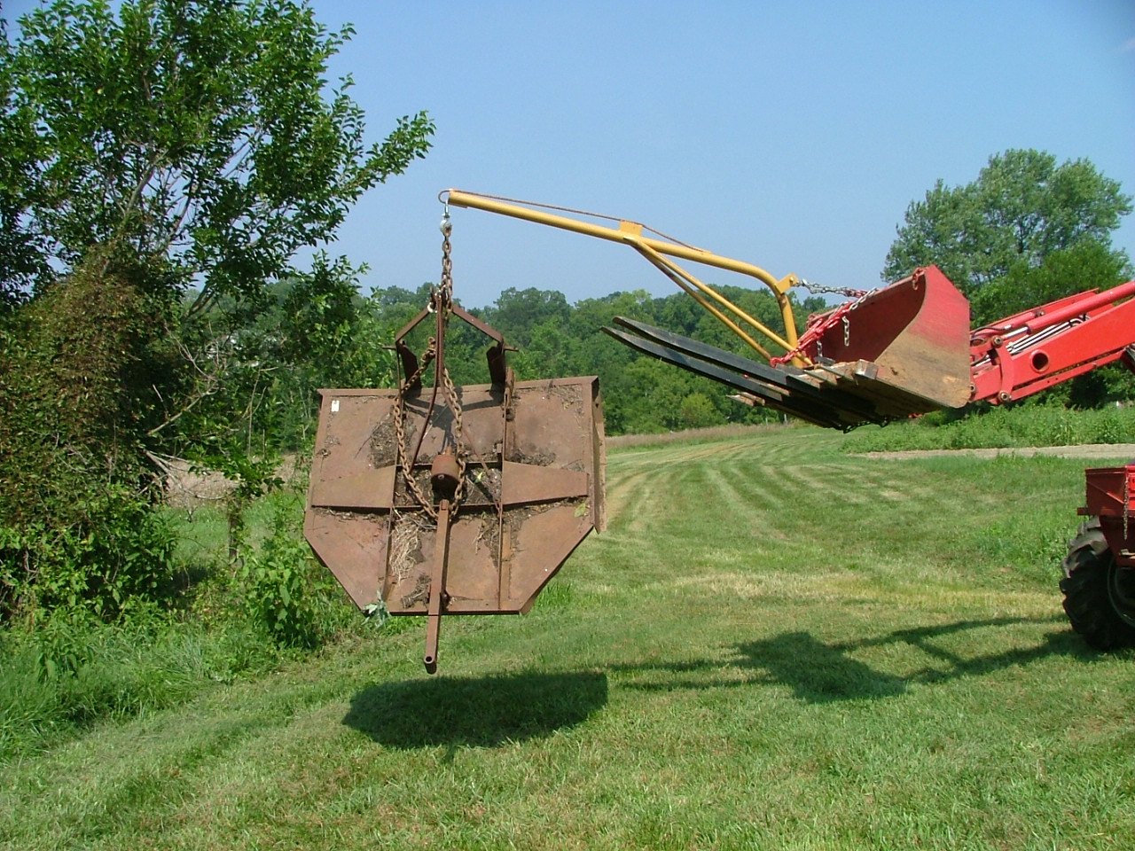

Hey Guys!!?? What's this "3pt" stuff all about?? Here's my boompole.... (Grin)... BobG in VA
