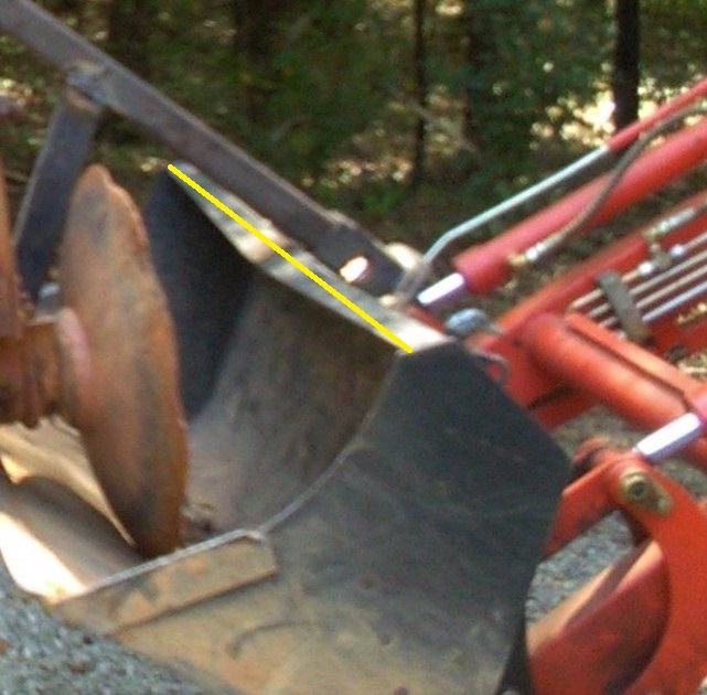

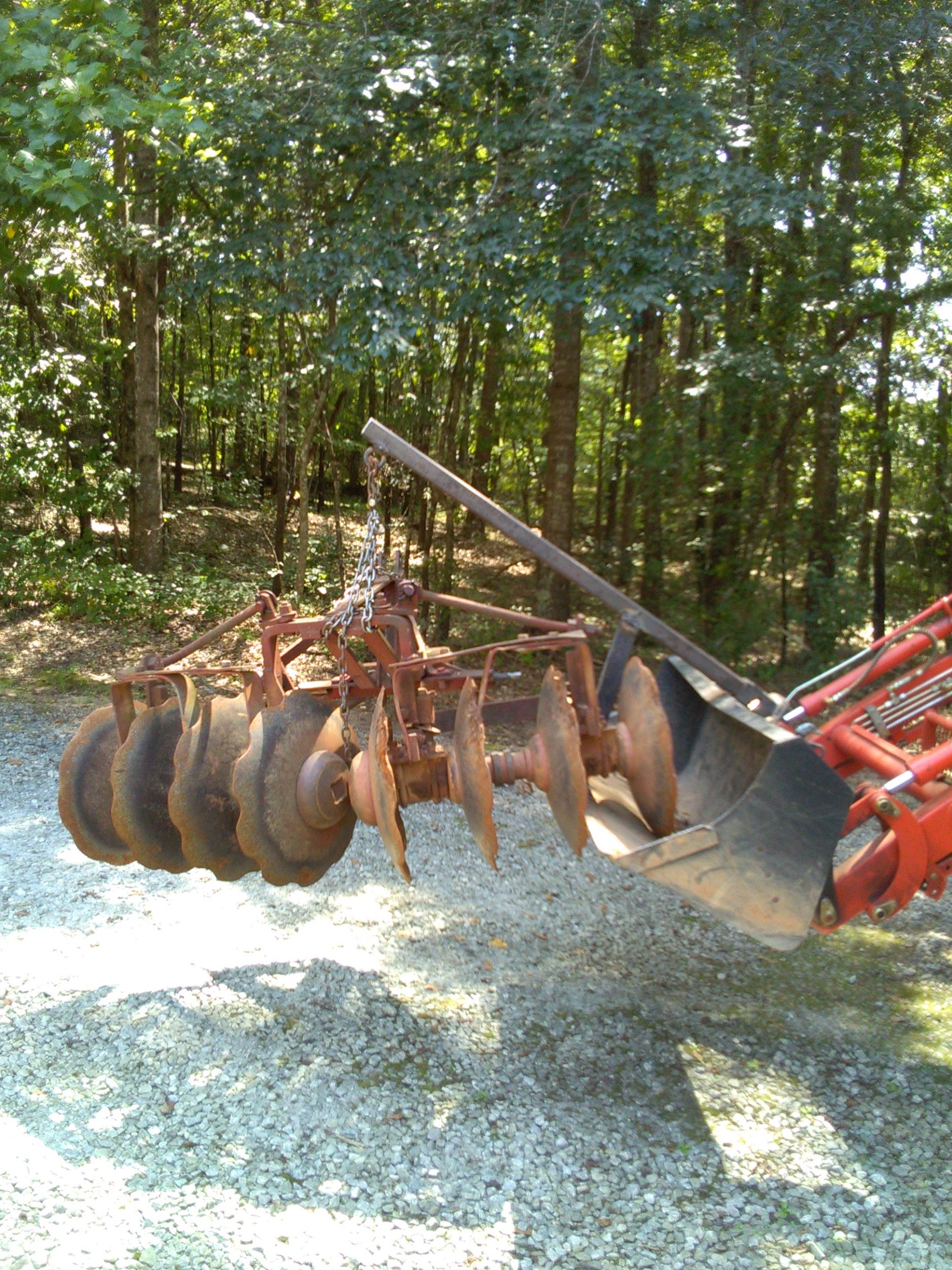

Got this made Today. It's main use will be to lift large firewood onto the wood splitter. The set of disks is the max on my Kioti CK2510.

A boom could be handy, but is there a reason you didn’t go with pallet forks?
/ boom lift
My tractor does not have a quick attach bucket. I do have clamp-on forks. This is faster to slide in. It has a chain with a grab hook at the top of the eye.
/ boom lift #6
It has a brace that goes to the bottom of the bucket!
Don't matter as the top lip of the light duty material bucket is bending in.... and it will never return to it's 'before bent shape either. The other issue you have and probably not seeing is.. As you deform the top lip inward, it also pulls on the side sheets of the bucket and can very well crack the welds.
I would neve do what you did there. Pallet forks are a much better alternative and no clamp ones either but true pallet forks.

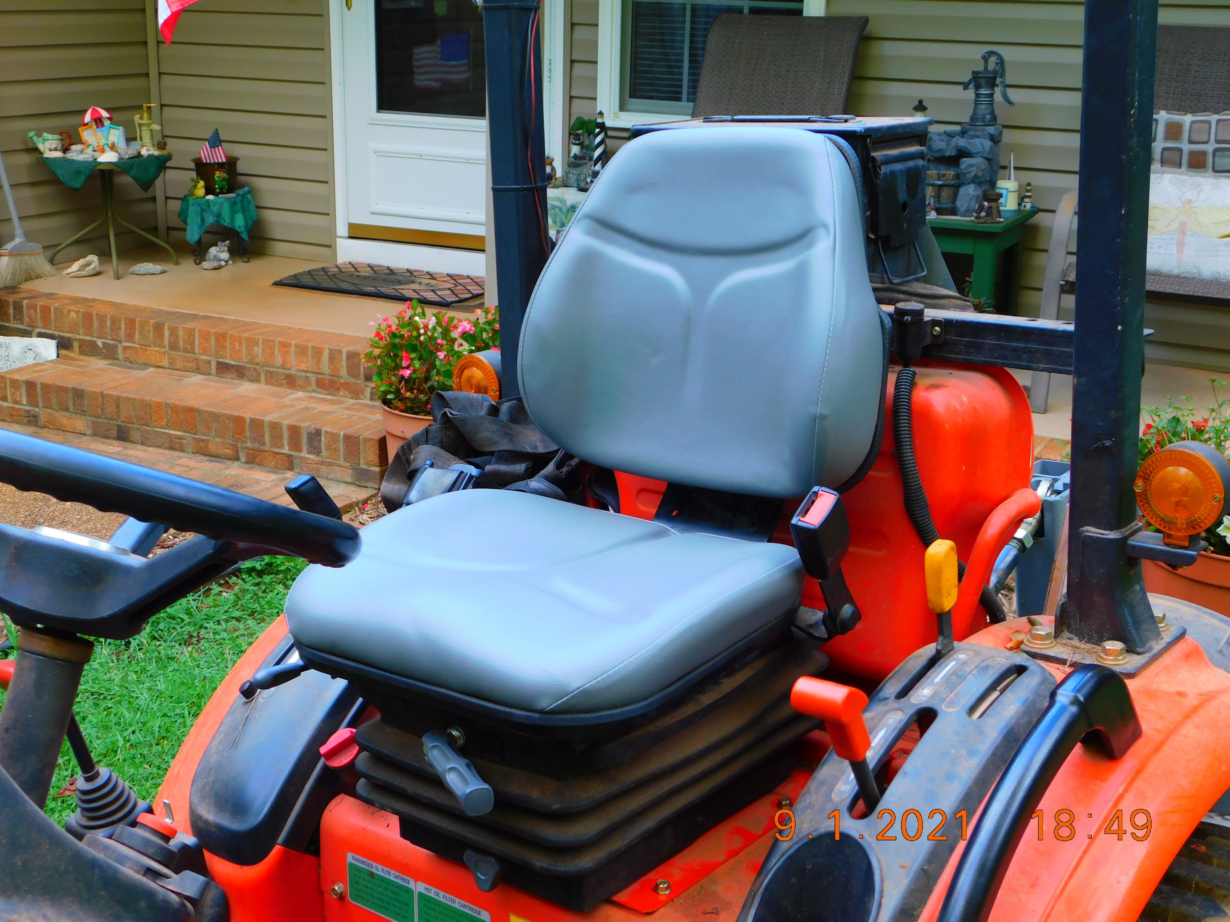

I had negative comments on my Upholstery redo on my seat! you post before you know the whole story!

Are you keeping some type of ballast on the 3-point hitch for counterweighting? Putting a lot of weight that far out in front of your tractor will cause you to lose traction at the least. Loaded rear tires will help with the traction but you'll also need something hanging out from the rear to get adequate counterweighting.
/ boom lift #15
I put my home built A frame boom on the back! That way I keep the functionality of the FEL.
It's just two pieces of heavy wall 2X3 steel attached together at one end, and pinned to a typical 3pth tool bar on the other ends. I use a short length of chain for the top link.
I use it for lifting big rounds up onto the splitter. Just as the original poster mentioned. Anything to save my back!.

When someone posts something they fabricated and flaw(s) pointed out it should be appreciated! I bought bolt on forks for my bucket and almost dropped something so I bought a stabilizer bar. It still wasn't good so I bought a real made in USA fork attachment which has been great. The real deal, heavy duty.

Yeah there are few Grumpy Gus's here and feel free to ignore the sniping, but the point still remains: reinforcing the upper lip of that bucket is a wise idea and will improve the performance and longevity of the bucket and your boom pole. That is sound advice, and you can take it or not. Up to you.
BTW, the seat looks quite nice. Not sure what the beef was...

If anything, the bucket will "fix" itself since the extra brace was added. With a load on it, it will try to pivot on the cutting edge and pull the dent up.
