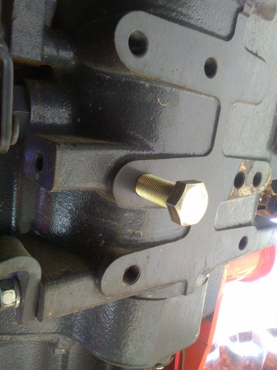

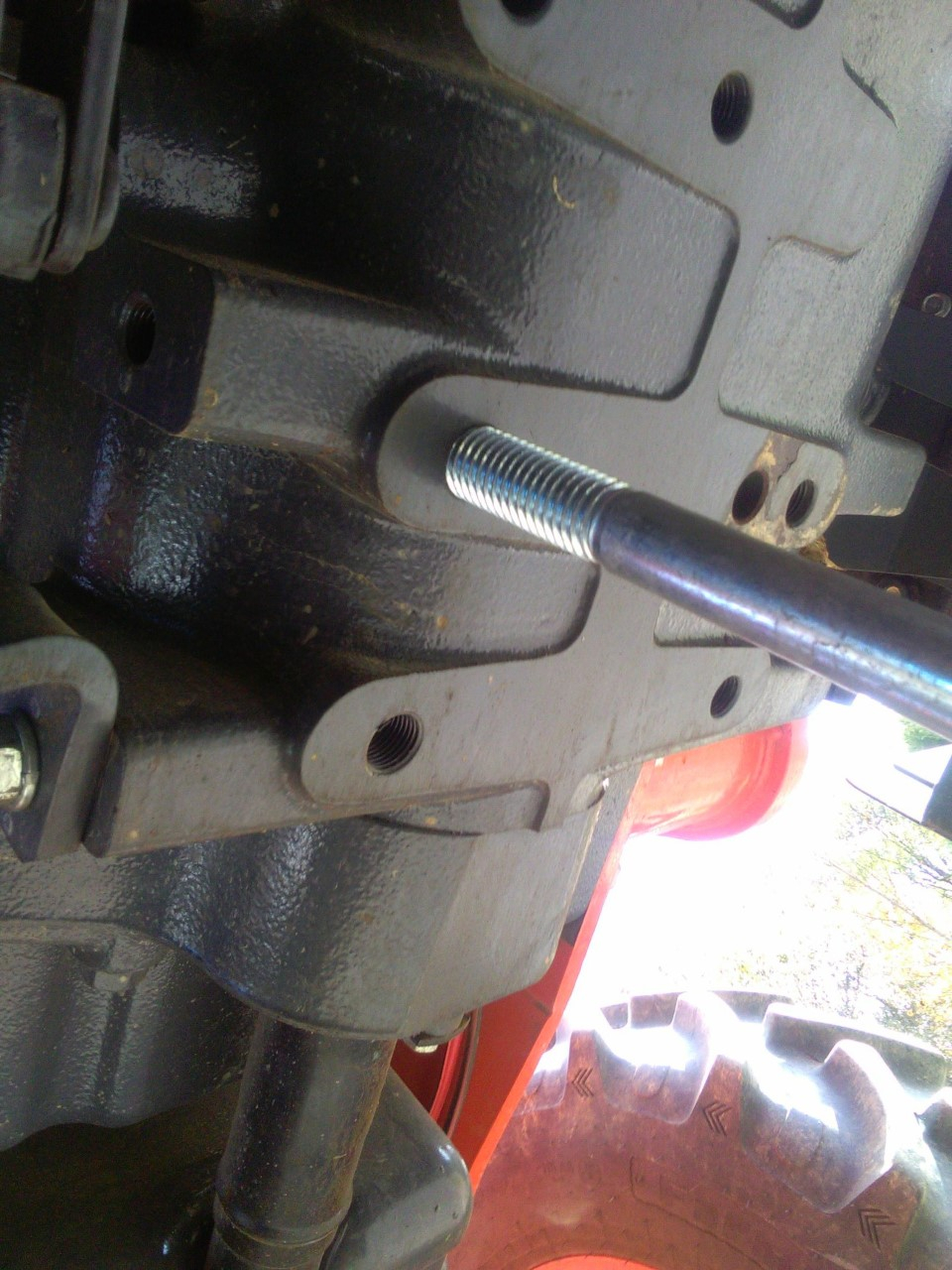

Bolt Update....here we go i have had time to fiddle with it some in between trying to do another million things. 1st off my tap and die set only goes to 1/2 inch bummer, that's just too small. Second 14 mm is just too small and 16mm is too big to start or even go in the hole. Third, and the pictures I will post show both a fine thread then a coarse thread 5/8 bolt starting into the holes. They will start however the fine thread just isn't it best I can tell. The coarse thread will seem to continue to screw in but it is extremely tight and i stopped after about a quarter turn out of fear! I have not worked out if this is a paint issue yet or a wrong pitch issue.....still trying things...and i will keep updating Thank's to all the third picture is just the hole itself showing the threads...

Rule of thumb: Cast iron and aluminum will always have coarse threads, whether SAE or metric.
