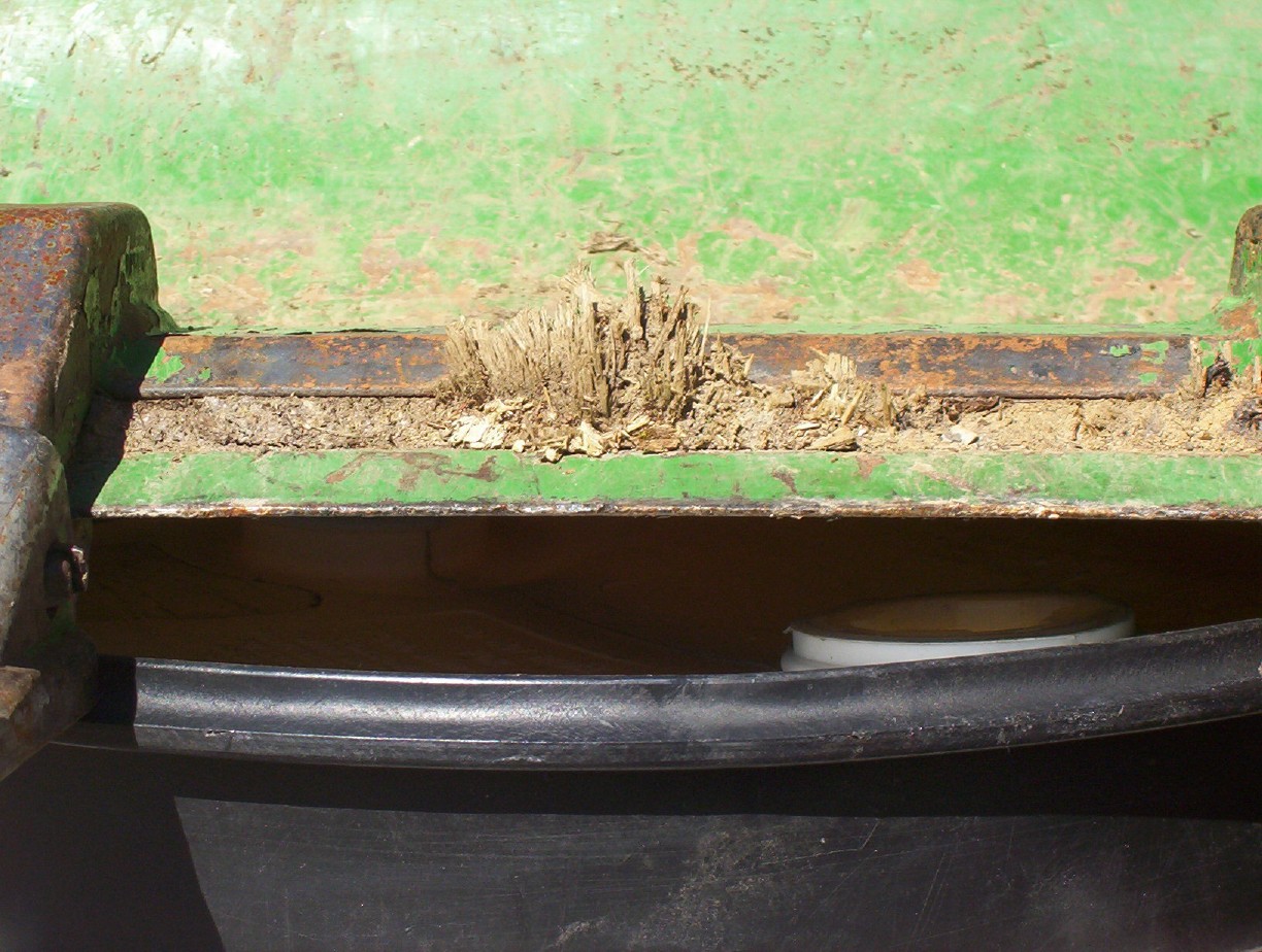

I am lucky enough to have 2 buckets. Large one with plain edge, and a 5 footer that I have made into a dedicated digger.
The digger did have a bolt on tooth bar. As seen in the picture, "stuff" would get wedged under the bar pretty badly. So I welded it on. Try as I might, I cannot break that little bucket.
