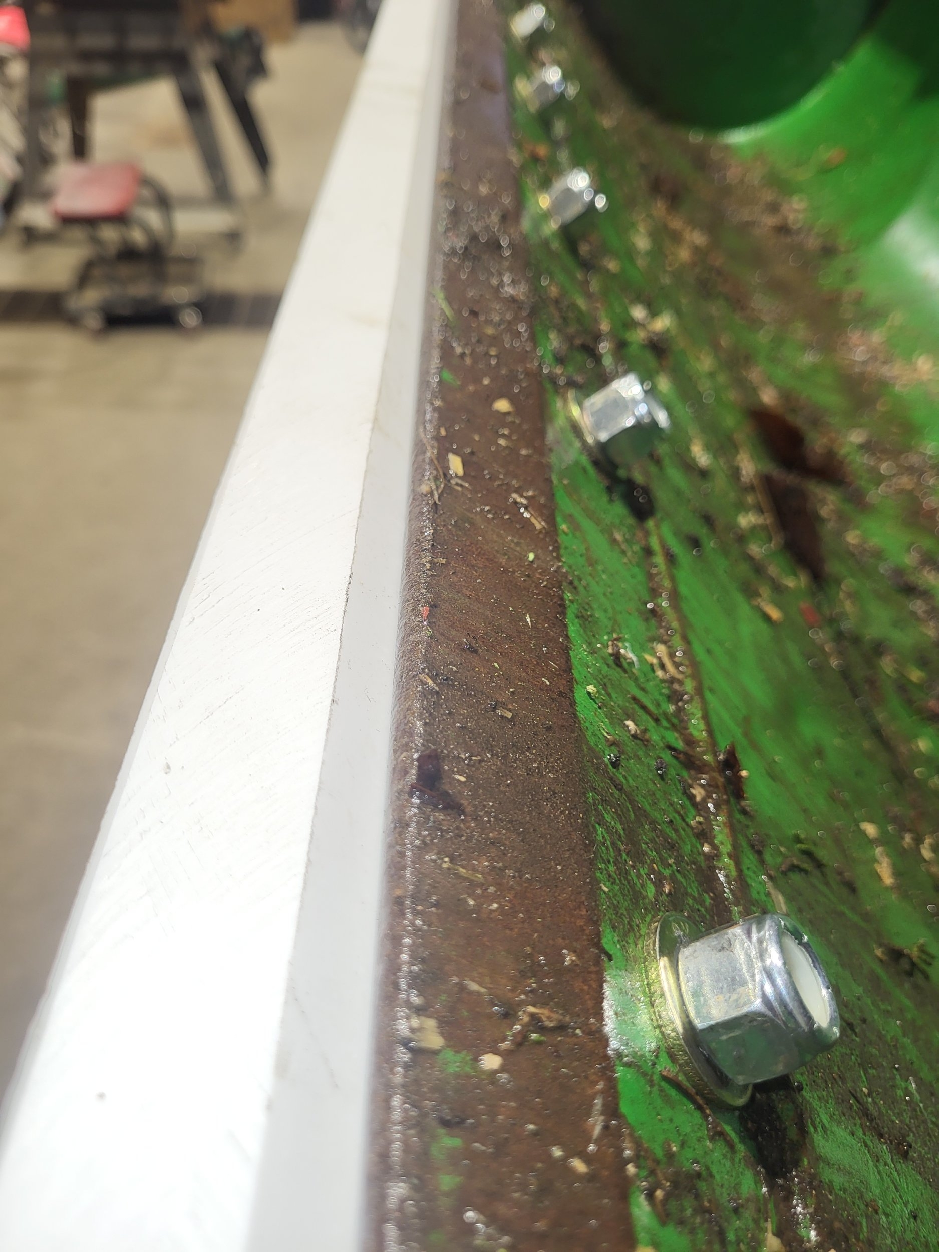

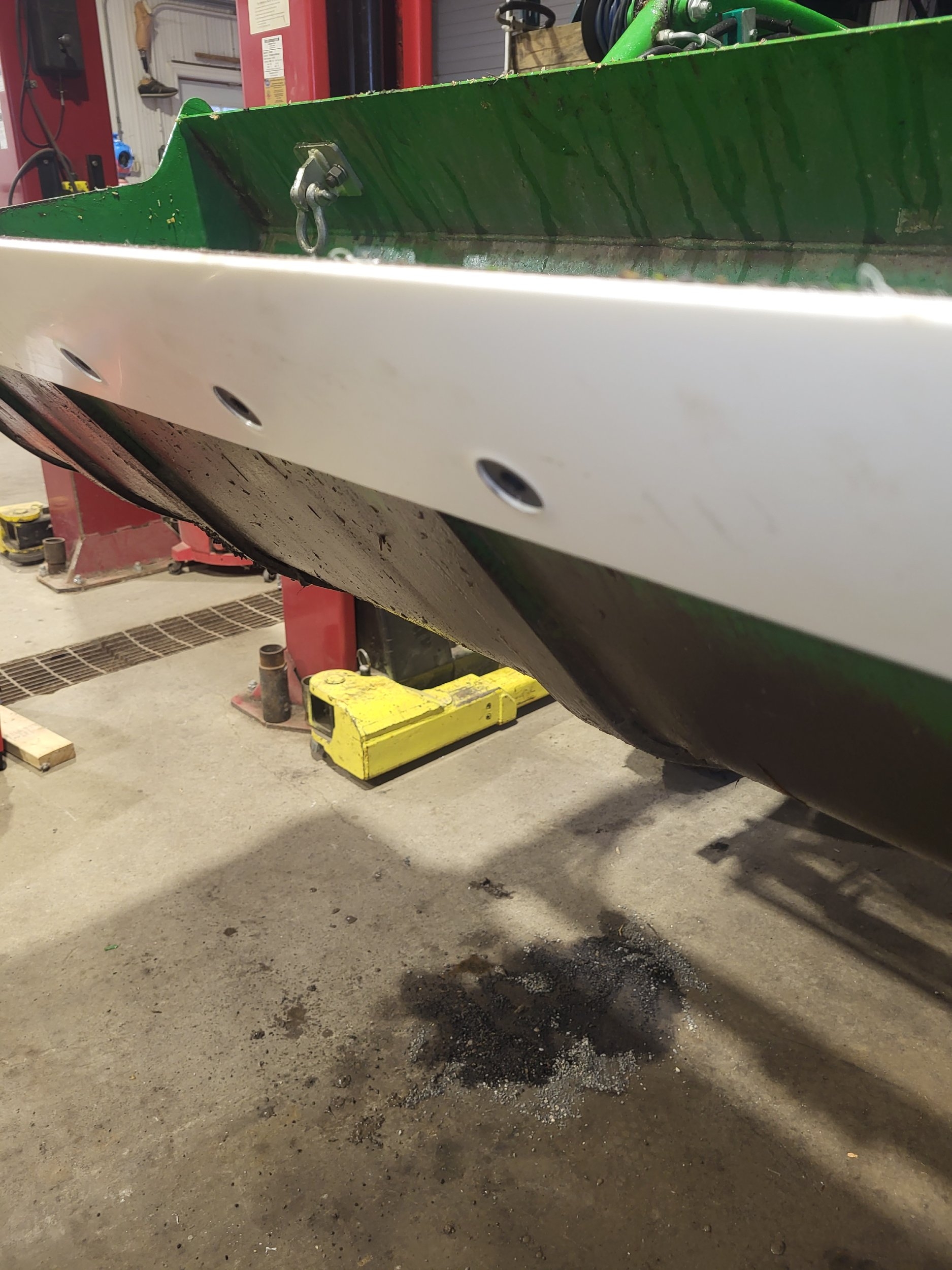

   / Bolt-on Plastic Edge for FEL? #15
I put UHMW on my 60" loader bucket this year to prevent driveway catching. It works well. I have the heavy duty bucket so already drilled for a cutting edge. Everybody likes pics.!
