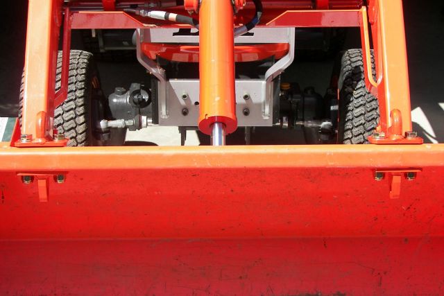

Yup, the hooks from Ken are the one's I was looking at. So it would still be ok for me to chain up items and lift from hooks mounted towards outside of my bucket, even though I will only have cylinder in the center of the loader? I just read through that thread and it had some great info. Thanks!
Maybe there isn't a "wrong" way of going about it but here are a couple of examples.
/ Bolt on hooks for bucket #4
I am also looking to mount some of Kens hooks on my bucket. From what I have researched it would probably be better to have 2 hooks on my machine. The center of my bucket is much weaker than near the ends. I don't plan to over do it but you never know?!?!
/ Bolt on hooks for bucket #5
I think two hooks would be fine on that machine, the lift capacity is only 675lbs at the pins, full height so you can figure 550-600lbs or so where the hooks would be placed. I am not sure though how the top of the bucket is configured, so please post some pics when you can.
View attachment 410705View attachment 410706
Probably right, on that size tractor no wrong way of course depending on how it's used. I don't have any on our SCUTs, but I have five on my L5740.
