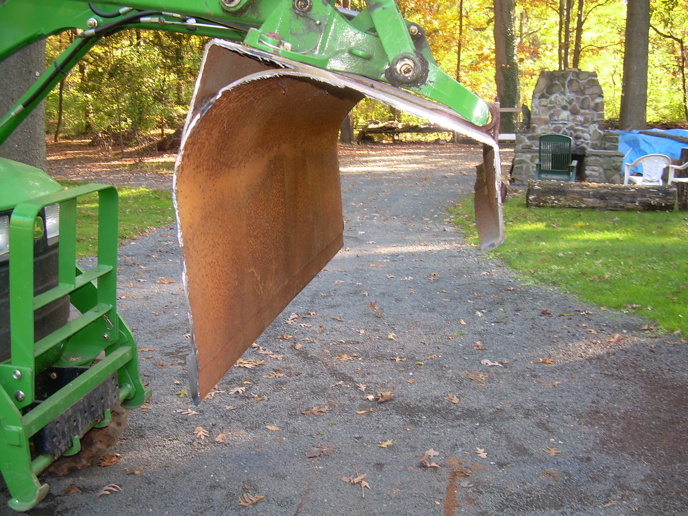

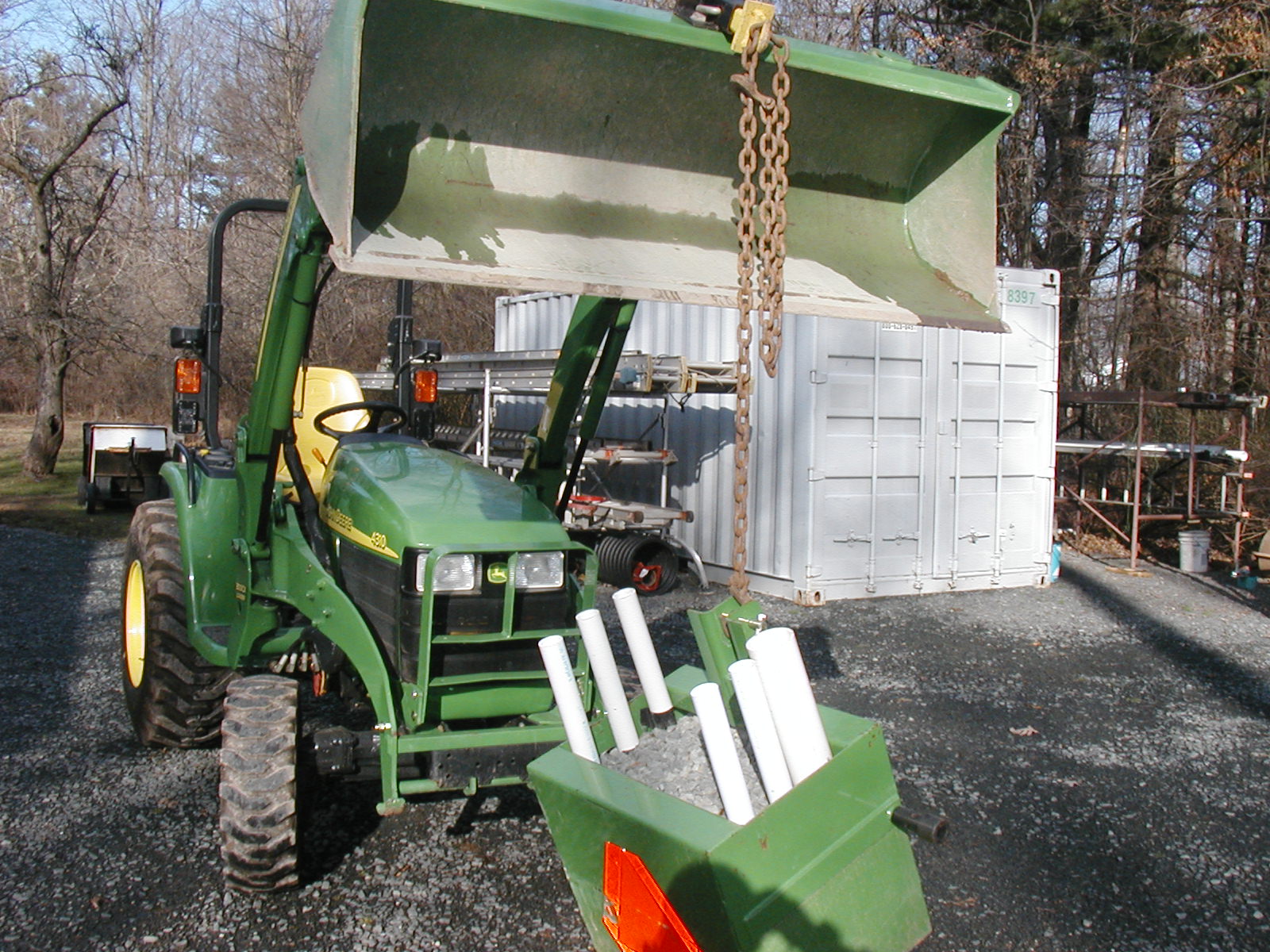

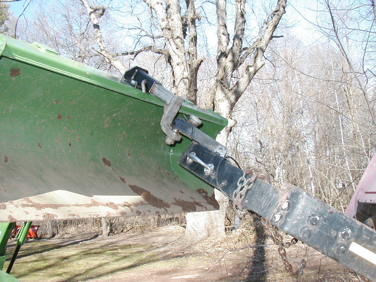

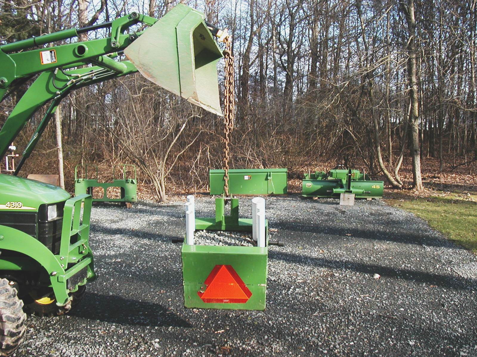

Couple of pics of my center mount, with a load on it looking across the top edge. another of a single wall bucket i got for small money after someone did collapse the top edge with a weld on hook in the center. Couldn't believe someone would do that! pic shows it after I jacked it back up, then I shortened it to make a mini bucket.
