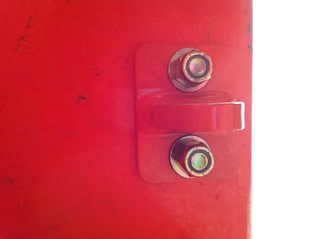

Looks good but I have a suggestion. From the photos, it doesn't look like the threads go all the way through the nylocs, looks like just a little too short. IMO split lock washers would be a better choice. Also I would reverse the bolts so that the nuts are on top - do this to prevent the threads from being buggered up by loads in the FEL, making them hard to remove later.

Here's a couple of pictures from underneath showing the bolt ends. These are fine thread bolts, 1/2x20, so I think there's enough of the thread going through the nyloc. Also with the lower pitch of the fine thread they are less likely to come loose. I went with 3 1/4 inch bolts so I didn't have to cut the ends. Using split lock washers I would of had to use the longer bolts. I thought about reversing the bolts but I figured there wasn't much thread showing and the nyloc would prevent anything from getting in the threads. I don't plan on taking them off anyways.
Yes, I agree the hooks are not friendly to straps but I didn't want to scratch them up on the first day! Also it would take a lot of flower pots to bend the top of the bucket!! :)
Thanks for the comments
Ken
