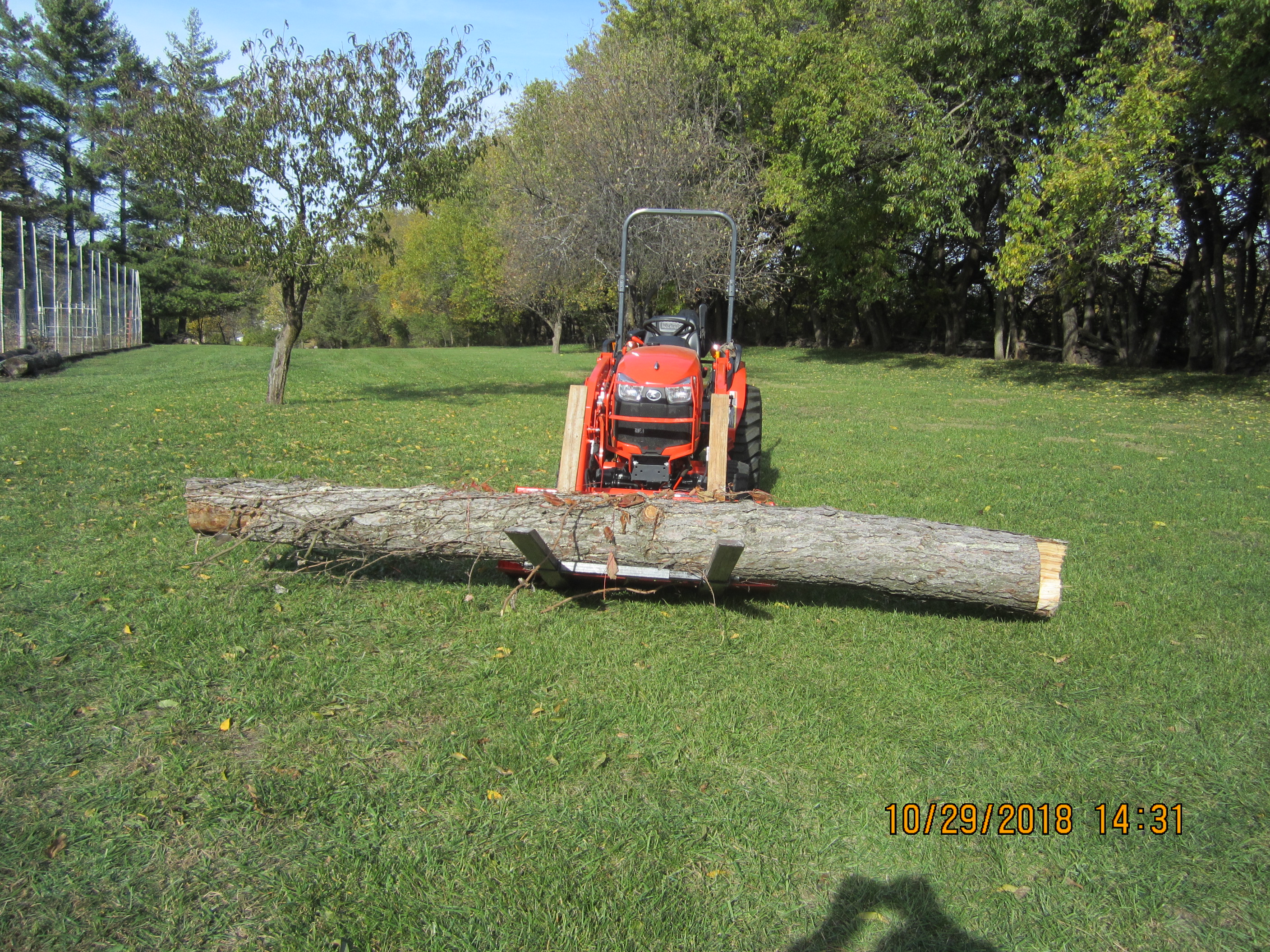

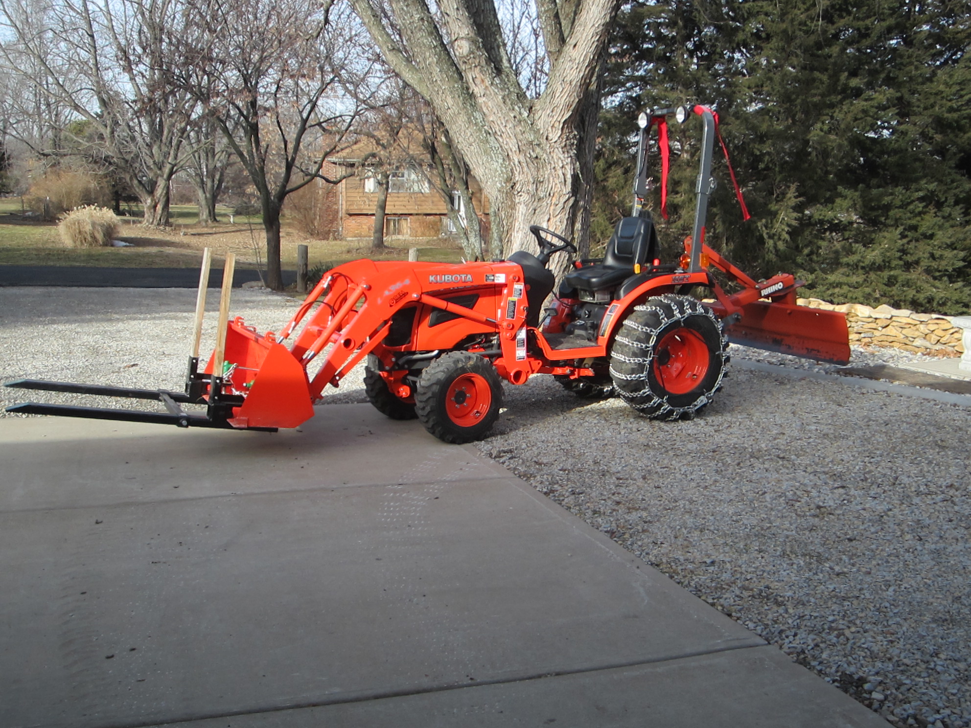

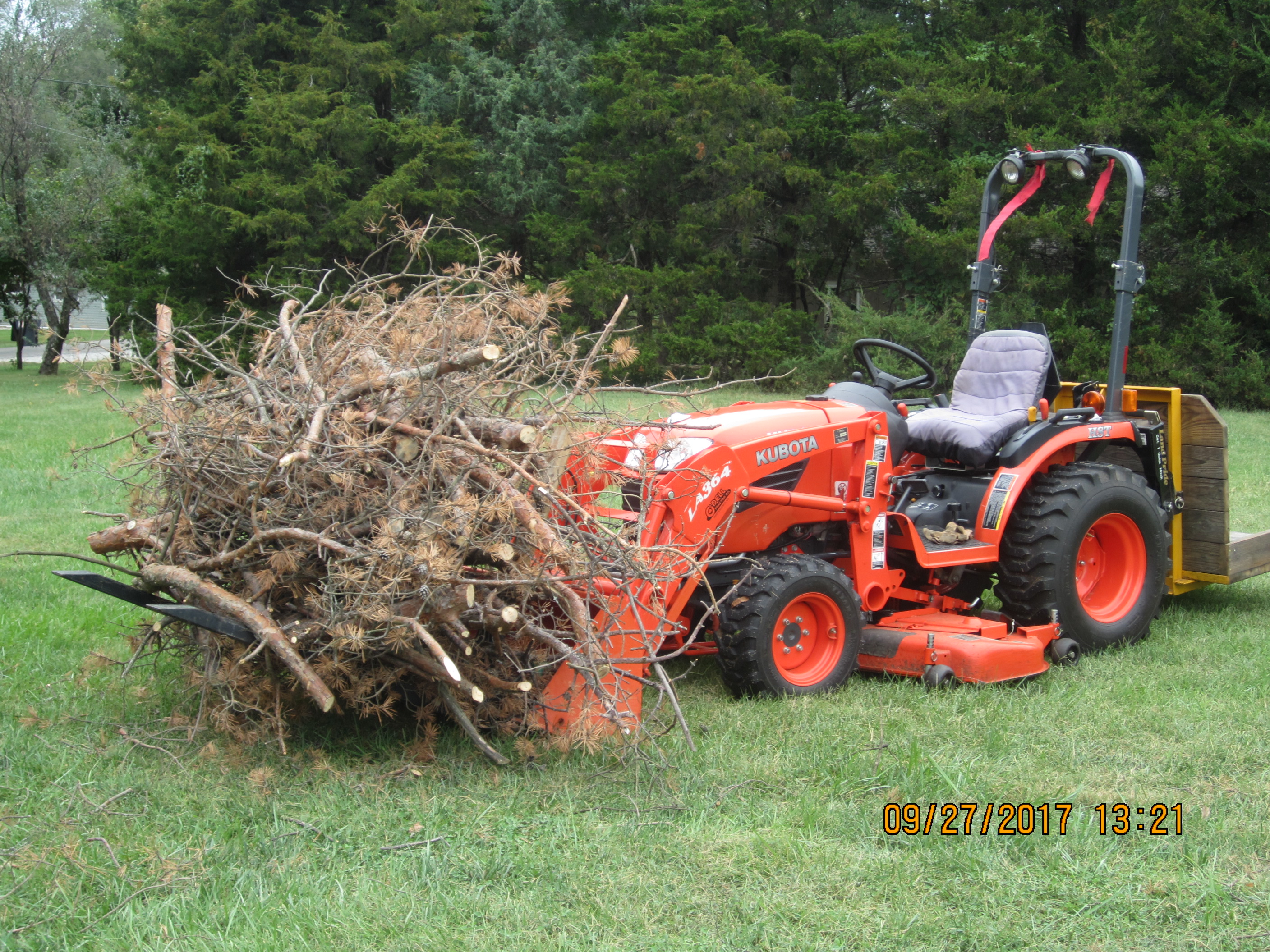

I went with a 42 inch clamp on fork set. Most of my volume lifting is doing tree limbs and associated brush. Lifting heavy "things" is usually loaded close to the bucket (pin on) . I wouldn't want to try lifting pallets of bricks with this set up.....at least not very often. Probably the capacity of the FEL would be exceeded anyway.
Cheers,
