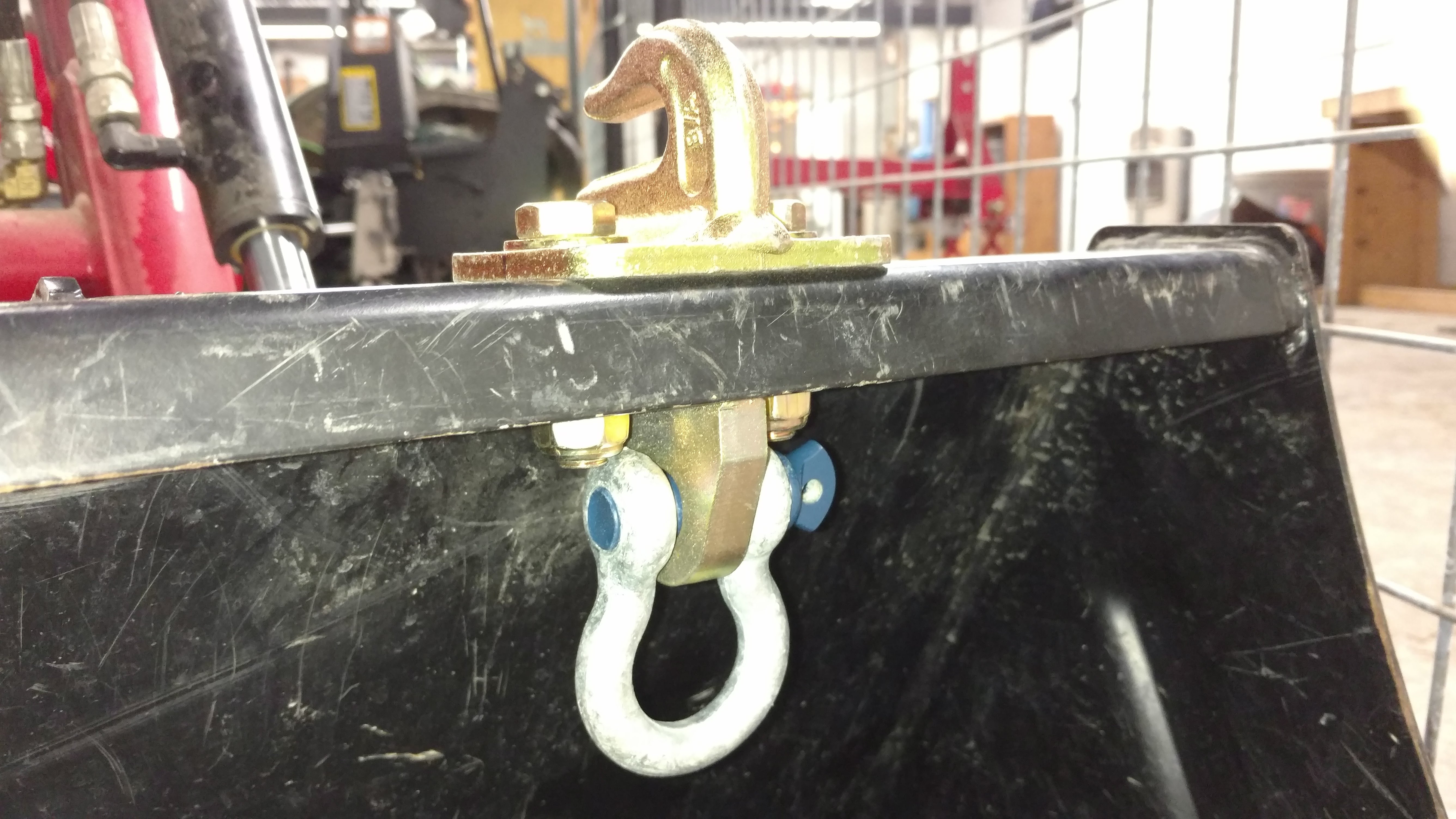

Anyone have any luck mounting bolt on hooks on top edge of their bucket, the flat only looks to be just over 2", I guess weld on would fit alittle better and not hang off as much,

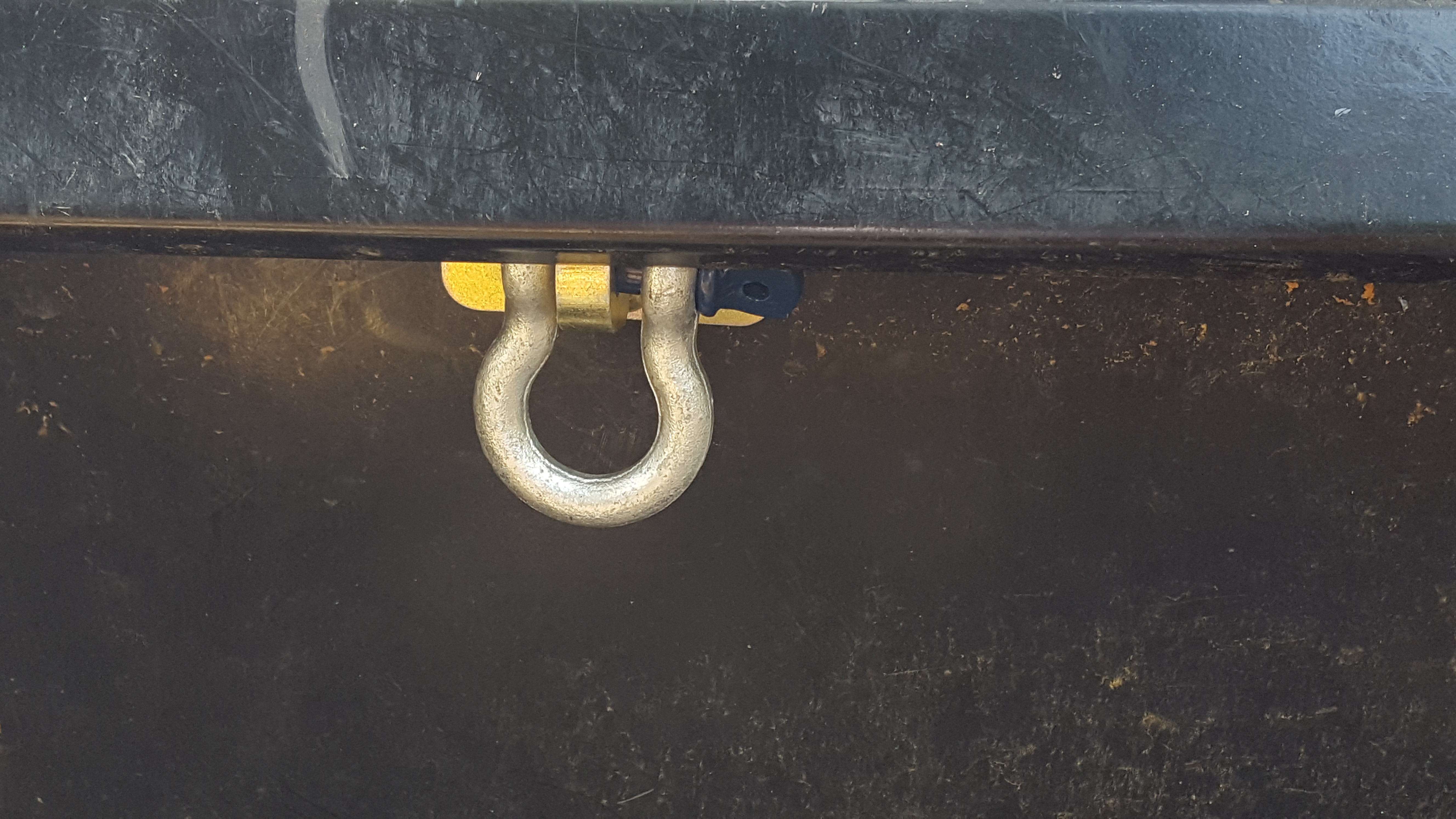

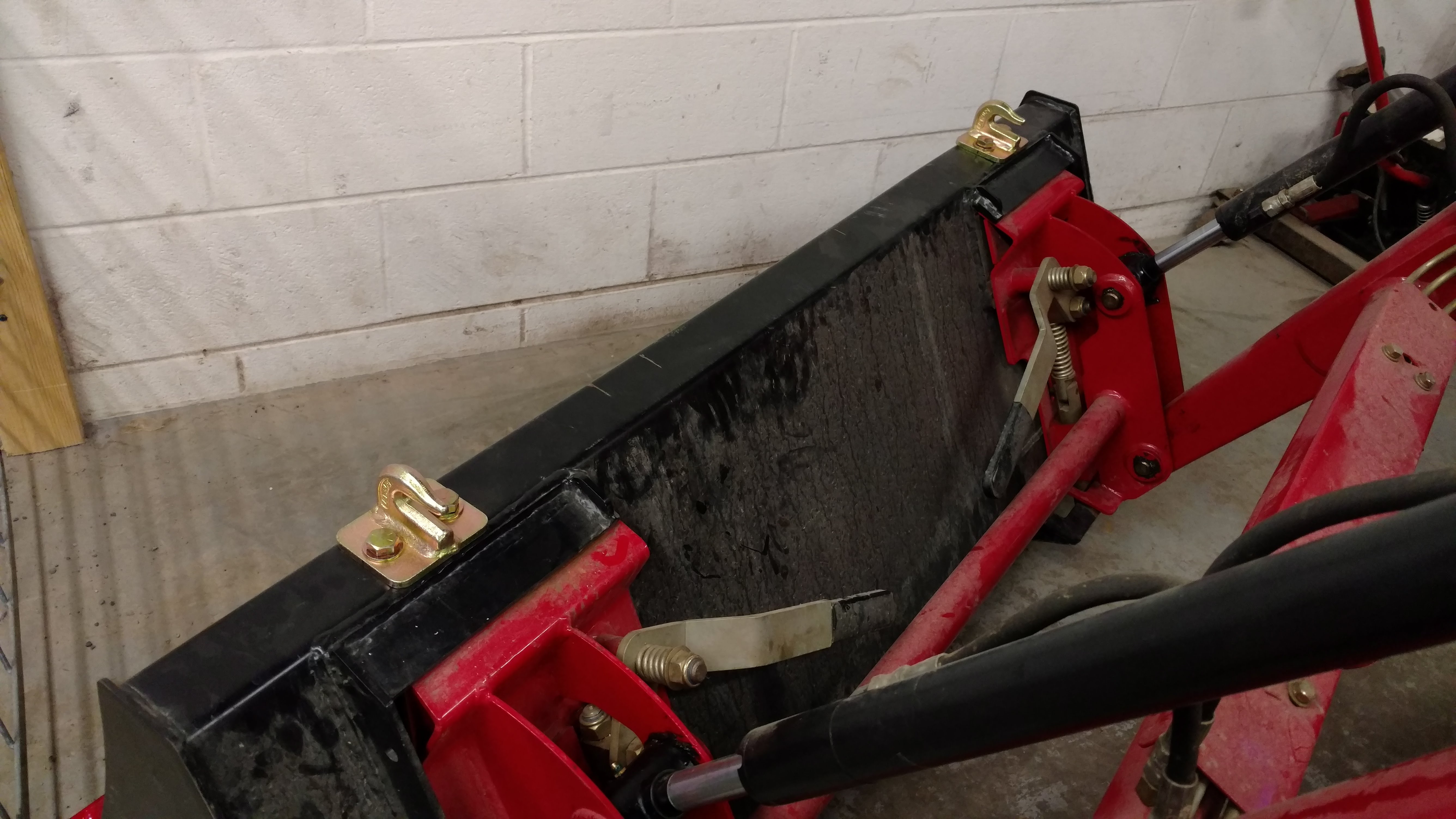

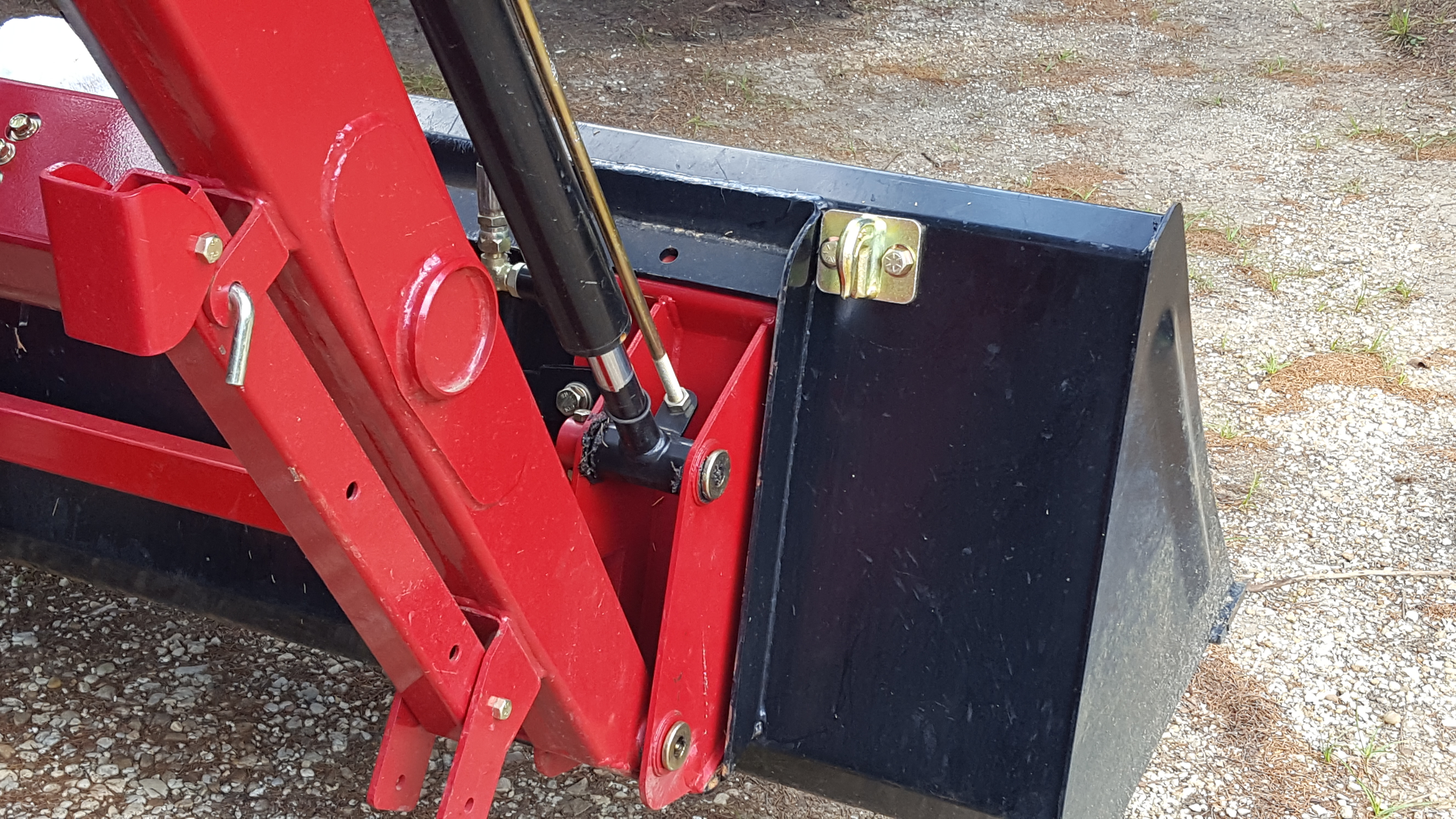

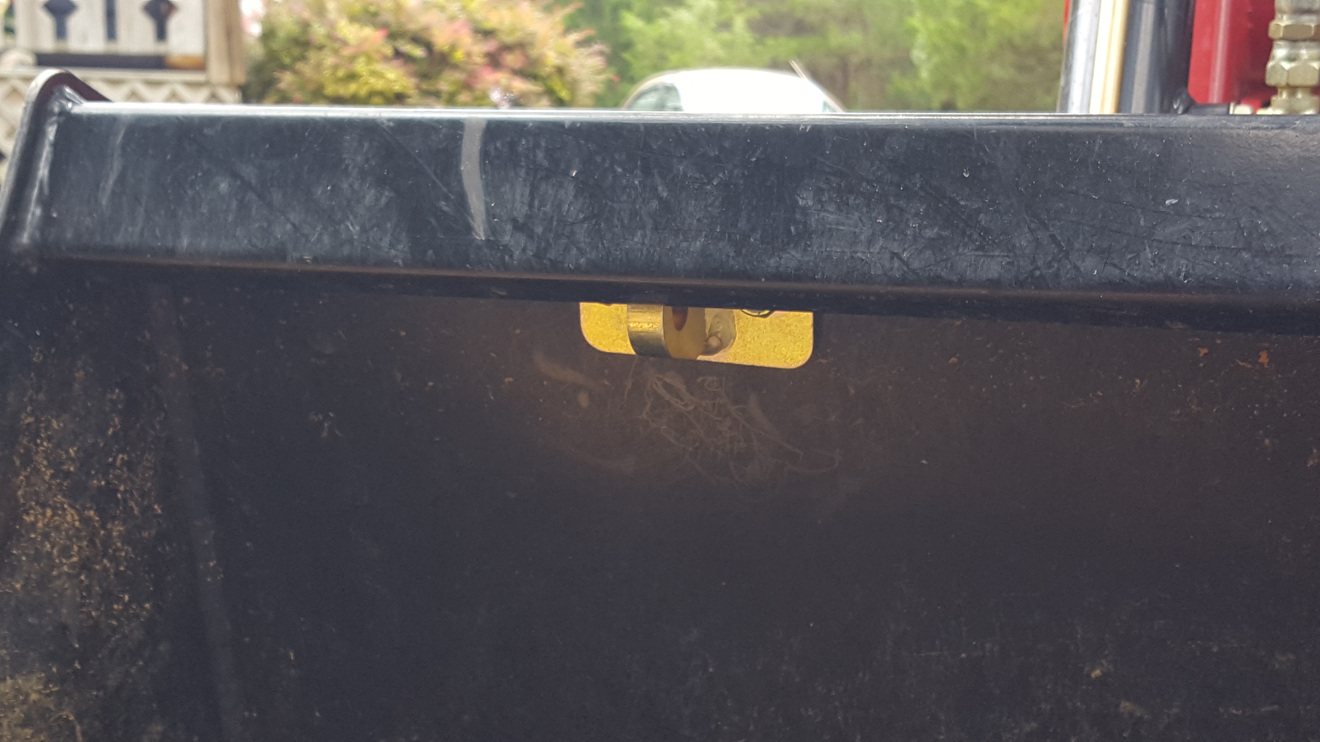

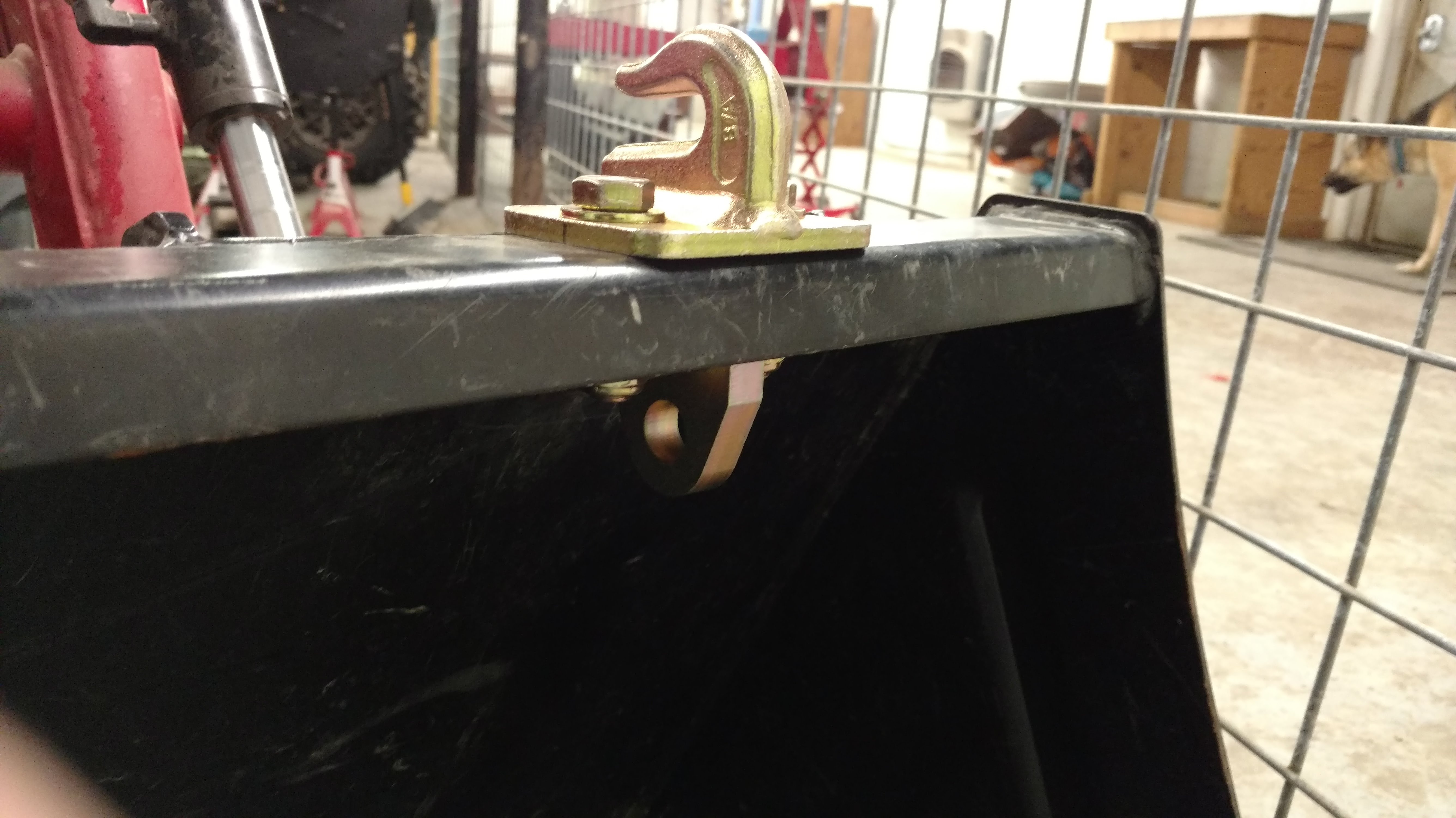

I installed Ken's bolt on hooks and clevis mounts on my Max 26xl bucket. They do slightly stick out over the radius of bucket top but very little. The only issue I ran in to was I had to install 2 of their 2" x 1/4" spacer plates on the under side to allow the clevis mount to fit properly inside the bucket. I haven't used them yet so I can't attest to their durability, but I think they will be fine for anything I'm going to use them for.
   / Bolt on bucket hooks mahindra 2538 #6
Sorry for the delayed reply, here is one's customers solution for the 2538 bucket:
