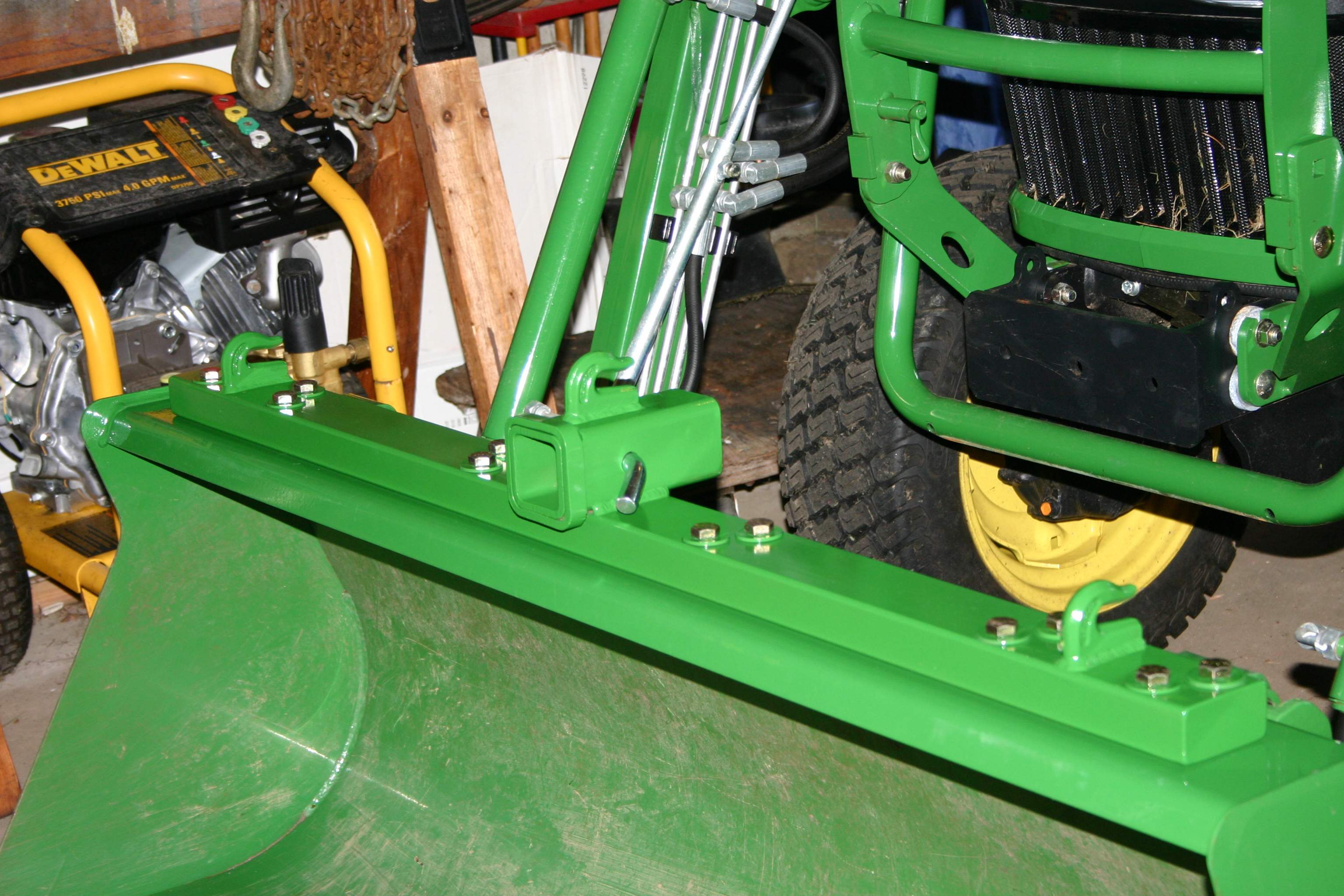

Check out my Bucket Hook mount with receiver that I came up with for my 200CX loader on a JD 2520. I'm hoping this makes the simple jobs easy now to pick up / move with the loader...
I have added a 3/16" backer plate inside of the bucket, bolts are 1/2 diameter grade 8.

And looks like you could just take the whole mess off and put it on a new tractor someday if you needed to? Nice idea.

Yes you have to plan for the next one...

Very nice workmanship.
How thick was your bucket sheet metal? Was it hard to drill in that many holes?

Once I welded a hitch receiver on my FEL bucket, I never used the 3 pt. hitch to ever move a trailer. I'm sure you'll find your setup very useful. Great job!

Drilling the 12 holes was easy as I used the backer plate (which had 1/2" holes in it) to locate the hitch on the top of the bucket loader. Then I clamped the plate to the loader and used a transfer punch to ocate the hole centers on the bucket. I drilled a pilot hole with a sharp drill and left the backer plate on all the way up to the 1/2" holes goling into the bucket to be sure that everything was alined.
That worked well as I could drop a 1/2" bolt into all holes and none were sloppy.

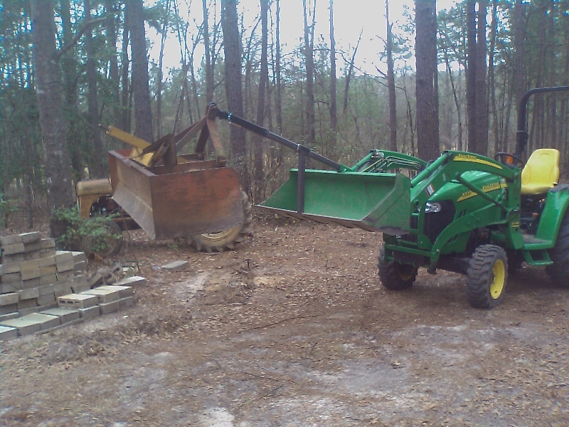

Now what you need is one of these. It is not my idea, but I took advantage of it.

Oh, regarding the question about the drilling the bucket material that was easy. I did not measure the material but I would estimate it at 10 guage (around .100) by eye. The key is sharp drill bit.
